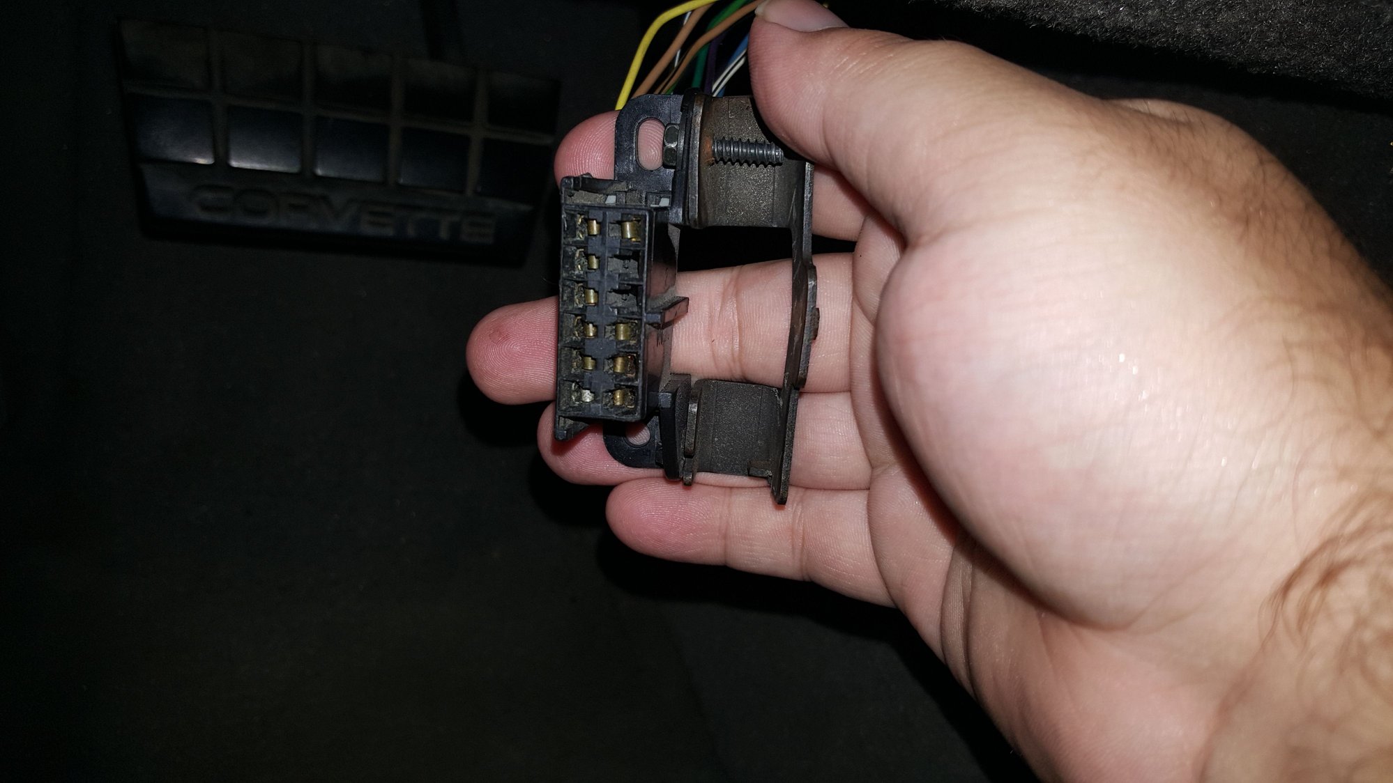

HI, I'm trying identify a wire harness plug thats hanging from under my drivers side dash. I was wondering if someone could help me out?
This is the plug in question. What do these wires goto or what does this plug into?

Even without seeing the other side of the connector, my feeling is it's for diagnostics especially given the area it's located. Diagnostic connector is located below the driver side dash to the right of the steering column.

Here is a picture of the connector itself.

I bought a code reader, and I'm pretty sure it will plug into that connector.

If you remove the carpeted cover - about four scews, then drop the metal cover - another four screws - you can reattach it to the lower end of the metal cover where it belongs. Then put the covers back on. This is a five minute job once you get the tools out.

Yup, that's the diagnostic connector for sure!
