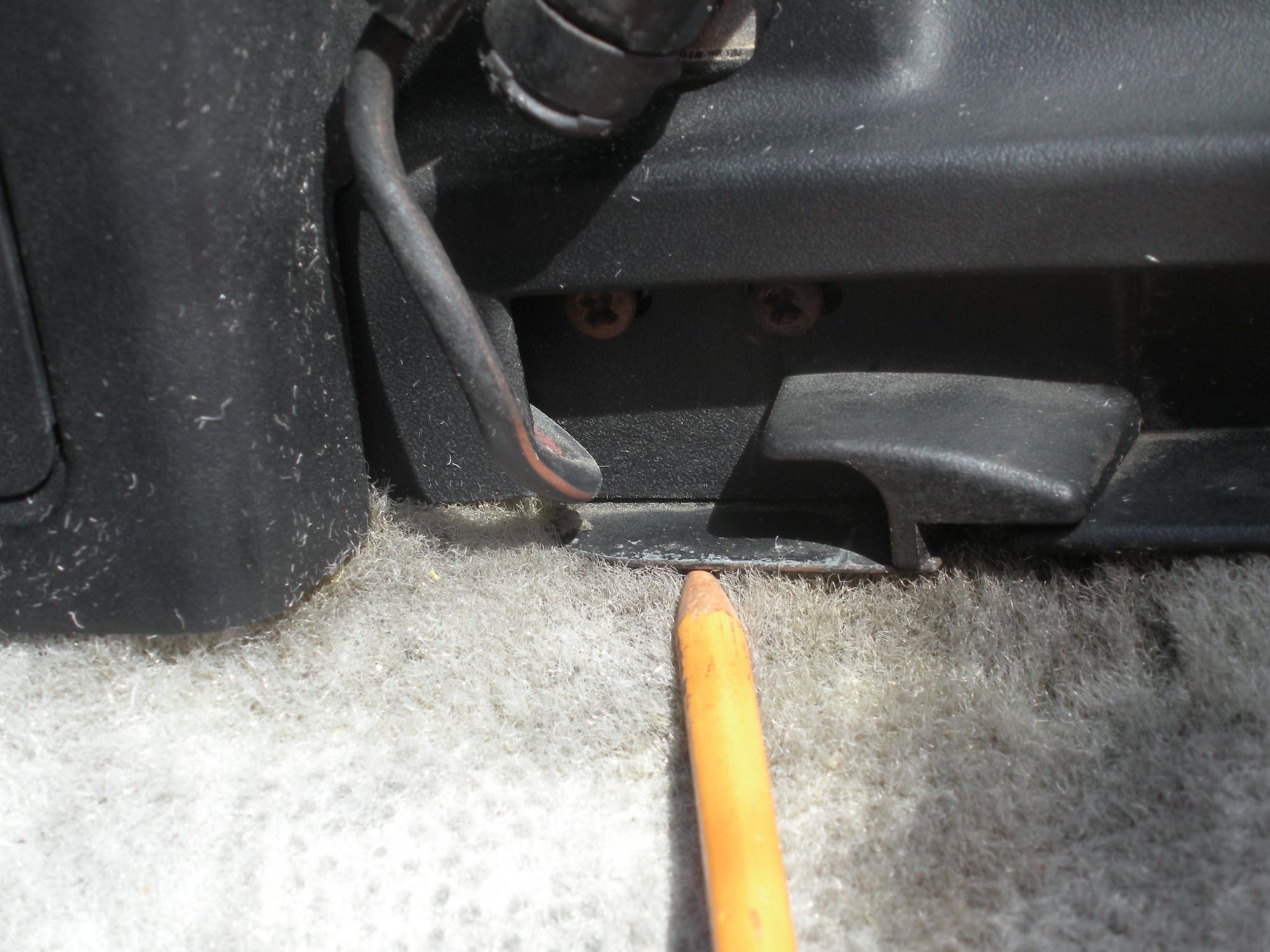

I see you have an '86. It's always a good idea to identify your car when you start a new post. They changed the design of this clip in later cars.
I had a similar problem with my '84, and decided the clips that are supposed to hold the pin at the end of the shade were allowing the pin to slip out from under the bottom of the clip. I fixed them with a small right-angle bracket that fits under the clip, that is held in place with the clip mounting screws.
I had the same problem in my '92. Good fix!
