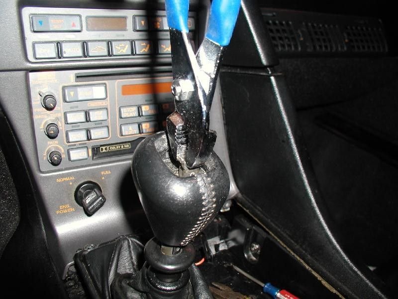

There is no screw or bolt, there is a "demon" key.
It is a metal wedge that goes in from the top (under the plastic shift pattern insert) to lock the shifter **** from rotating.
Most people use a vise grip to grab on to it and then pull upward or hit the vise grip with a hammer (upward) to remove the key. They can be pretty well stuck so good luck.
(Note that this is a C5 ****, but exactly the same except for the stitching location on the ****)
Some use a pliers, but I have not been that lucky to get it with one.

with QCVette. Once you pull out the wedge, the **** will unscrew.

Same question. Mine is pounded in pretty good. I tried a vice grips and no matter now tight I get it it snaps off the end. I'm thinking I may have to drill it out. I'd try heat but it will melt the shifter ****. Any better ideas?

With the needle nose style vise grips as shown wiggle the wedge key backwards and forwards and side to side while also pulling upward. After removal the **** spins off to the left, Its also the only way to do it. A few folks remove the targa so you can get a good grip on it while pulling upwards so as to not bang your elbow during the pull process. GC
