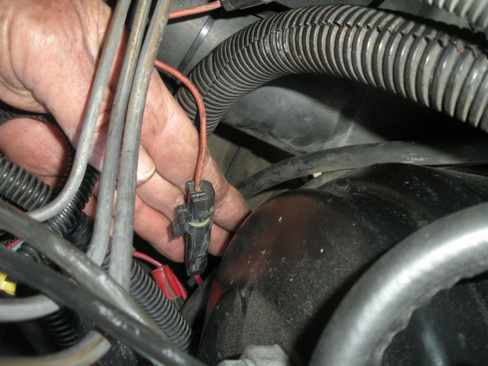

Okay, that tells me you still have the security module in the car. The PO apparently found a way to bypass the feature that prevents you from starting the car if the s/s is actuated, probably at the Starter Interrupt Relay! Your '86 might be different than my '84, but try this:
Three ways to reset:
1. Unlock either door using door key from the outside.
2. Remove neg. battery cable for about 15 sec.
3. Disconnect this connector, located below your brake booster. Note the two wire colors don't match.

Hot Rod...wow Thanks !!!! I tried all three. I am not sure if one worked or it was the combination of the doing all three but it worked! that took care of the problem. especially thanks for the pic, I would have never found that connector without it.
