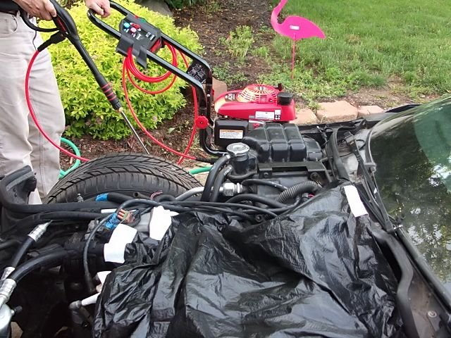

Cleaned the 91 with a pressure washer. Used plastic bags and aluminum foil.
Easy to tell the before and after pics

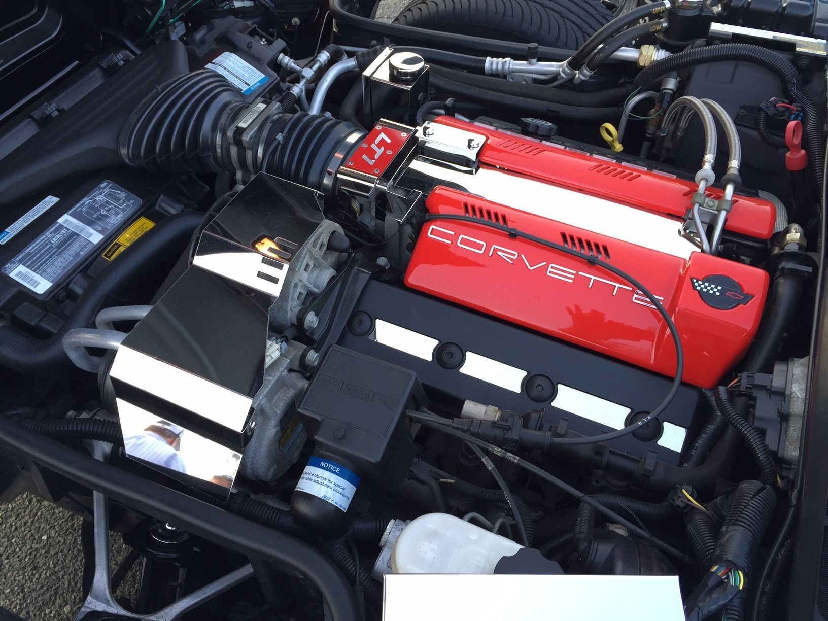

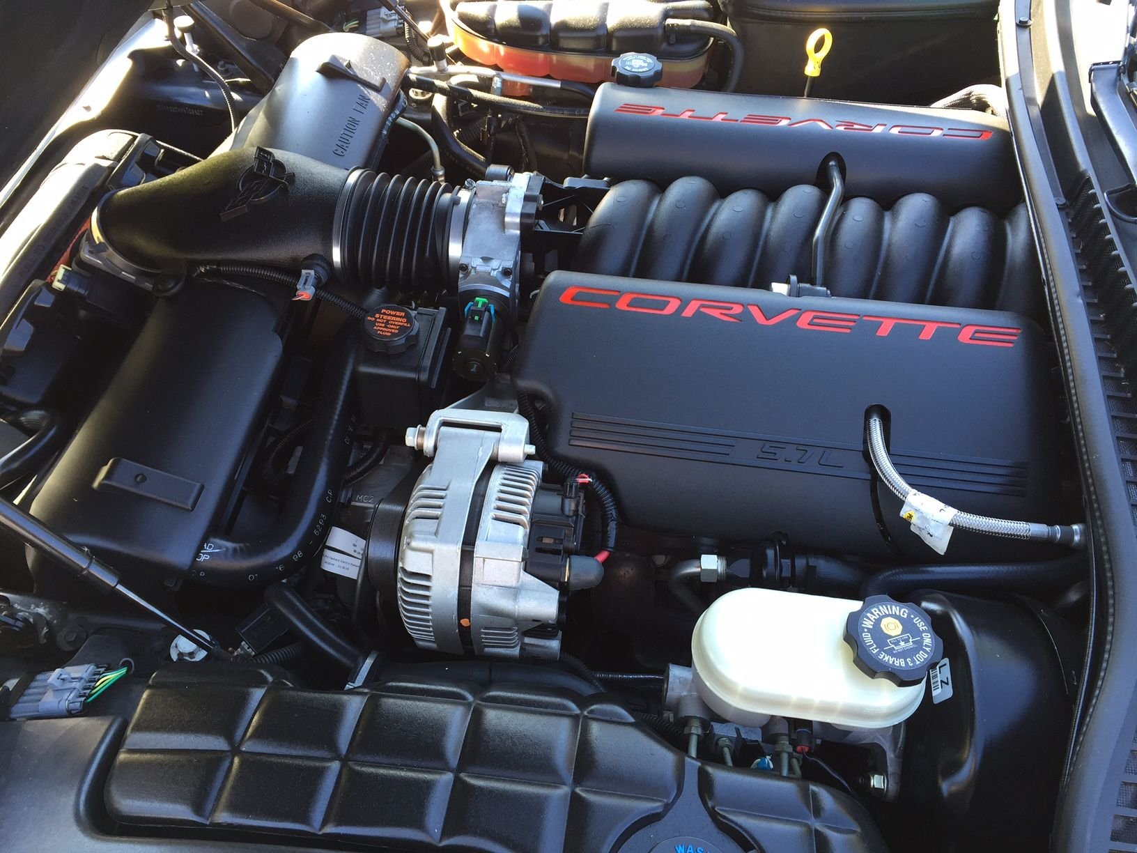

My 95 & 99 all the engine bay cleaning was done by hand little by little. No power washer. Simple Green, Chemical Guys Black on Black, rags, brushes and a lot of patience. The 99 is 100% OE and the 95 has a little bling added.
