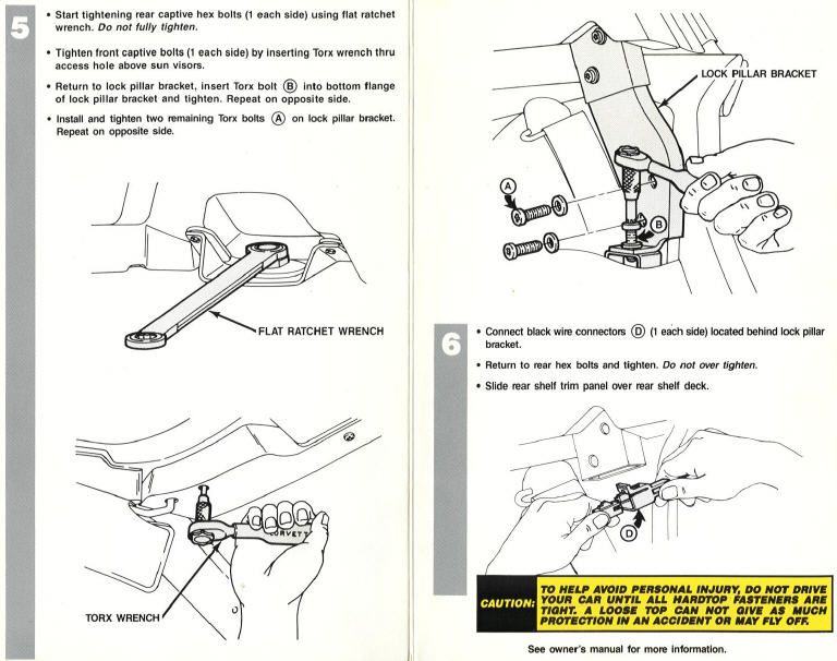

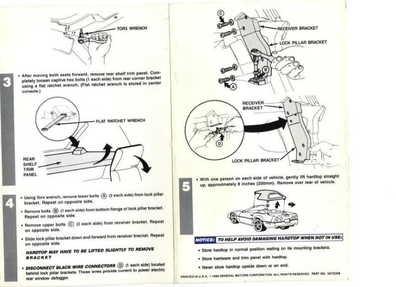

I have not. There are rectangular hollow brackets attached to the hardtop on each side. Wondered what they were for, don't appear to be in the way of removing the top?
Those steel brackets are what provides the stiffness to the 'vert when the top is properly installed. There are 5 bolts on each side and they all have to be removed to be able to lift the hardtop off the car. Also, the rear locating pins on the decklid each have a small encapsulated bolt that has to be loosened. IIRC, it takes a 10mm wrench.
These pins do not clamp the top in place; the small bolts hold the rear of the top and when you install the top, these bolts are for snugging the hardtop down so that the weatherstripping seals properly.
If you want a copy of the original GM hardtop install instructions, send me a PM and I can provide them.
I do not find the brackets with the 5 bolts? I believe I have an OEM hardtop as opposed to a Smoothline model? The rear "locating" pins in the back have a stud protruding with a top requiring a 5/16" wrench. On that stud (each side) is a lock nut taking a 7/8" wrench. The other end of the studs must be in the receiving bracket in the deck lid. The releasing cable/handle moves but is not releasing the stud on either side.
I surely would like the GM instructions that you say you can provide.

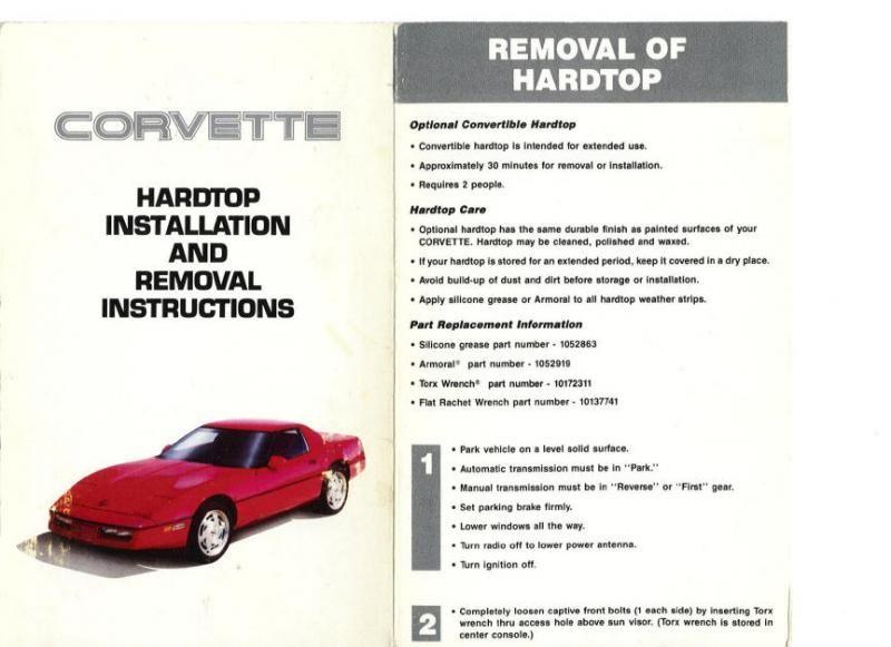

Here's the GM hardtop installation instructions.
