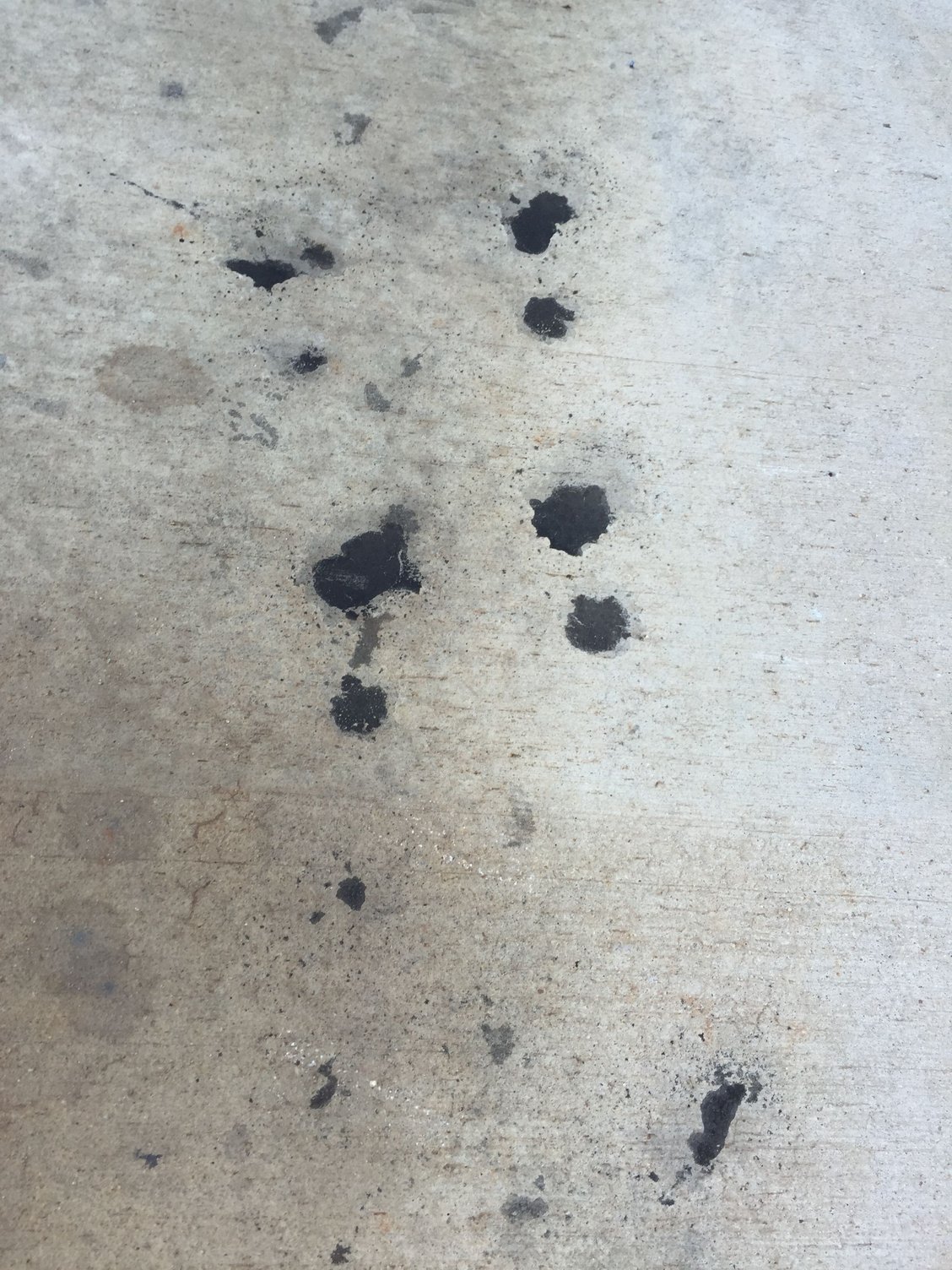

Happy Monday! Wife wanted to drive the '88 Anniversary to work and had to show her how the handbrake works lol, when the car back up I noticed drops of something on the driveway, two side by side drops and four in a row (dripped as she backed up) being illuminated by the headlights it was hard to tell what it was. Just had an oil change the other day, spots were dark....touched it and it didn't feel like oil, (the consistency but couldn't tell initially). Definitely not transmission fluid or coolant. Will take a pic of the spots

It was early this morning. Here's a pic of the drips

did it evaporate?
metallicy exhausty smell to it?
leakage from the cat/exhaust?
if u can jack it safely and safely put multiple jackstands under the car (plenty of redundancy) and take tou phone with light under there you should track it down easy.

Looks like exhaust condensation.

that's just rich condesation from a cold engine
Normal on a cold startup from the exhaust.

Yup water condensation on the exhaust catching some of the fine carbon soot, makes it look like dark fluid to be concerned over. It's not.
