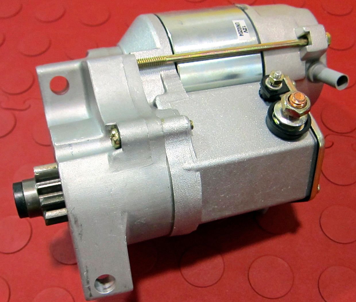

I installed a gear reduction smaller starter. The starter is half the weight and easy to install. I do have engine work done with a higher compression. My car does start much better than the stock one.

A high torque mini starter would be nice. You can index it for headers. Easier to R&R

I thought about a gear reduction starter. I even bought one. I just never installed it. I went with a NAPA starter.
