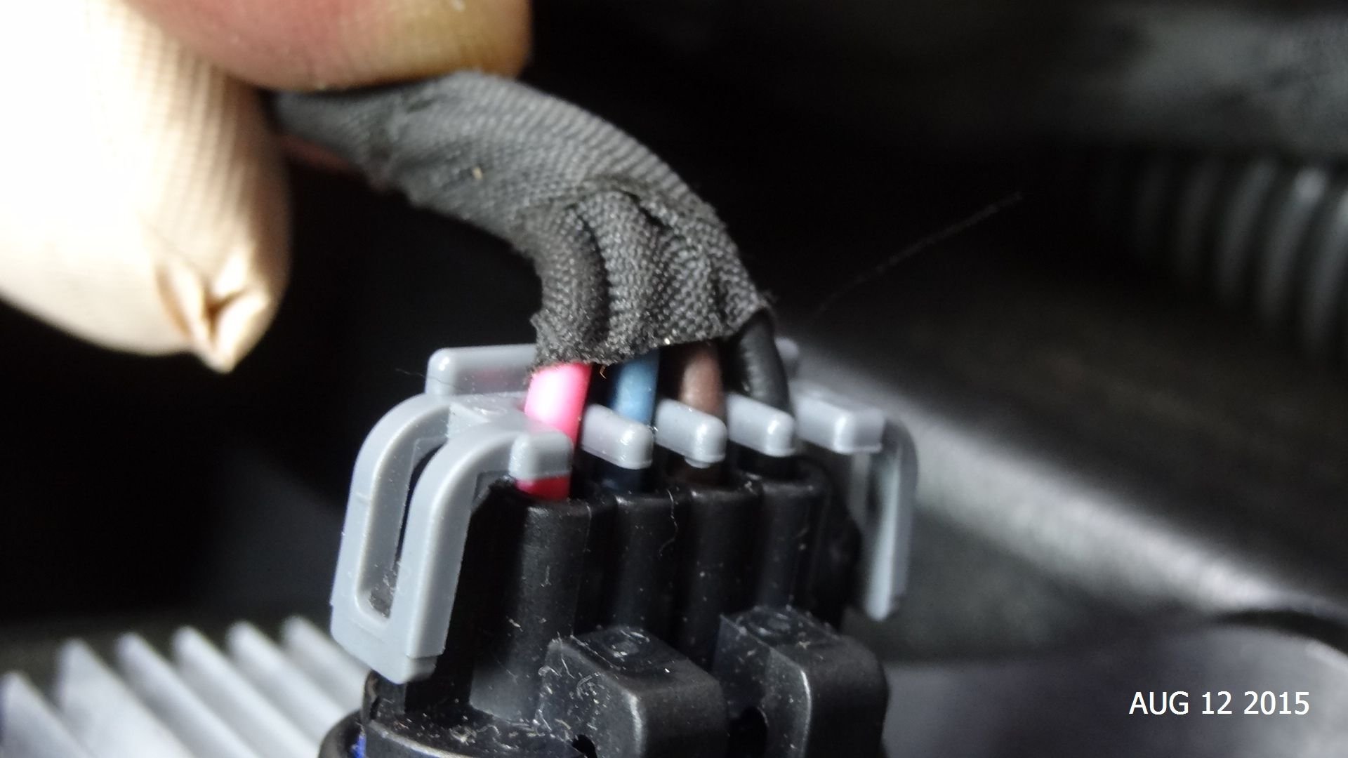

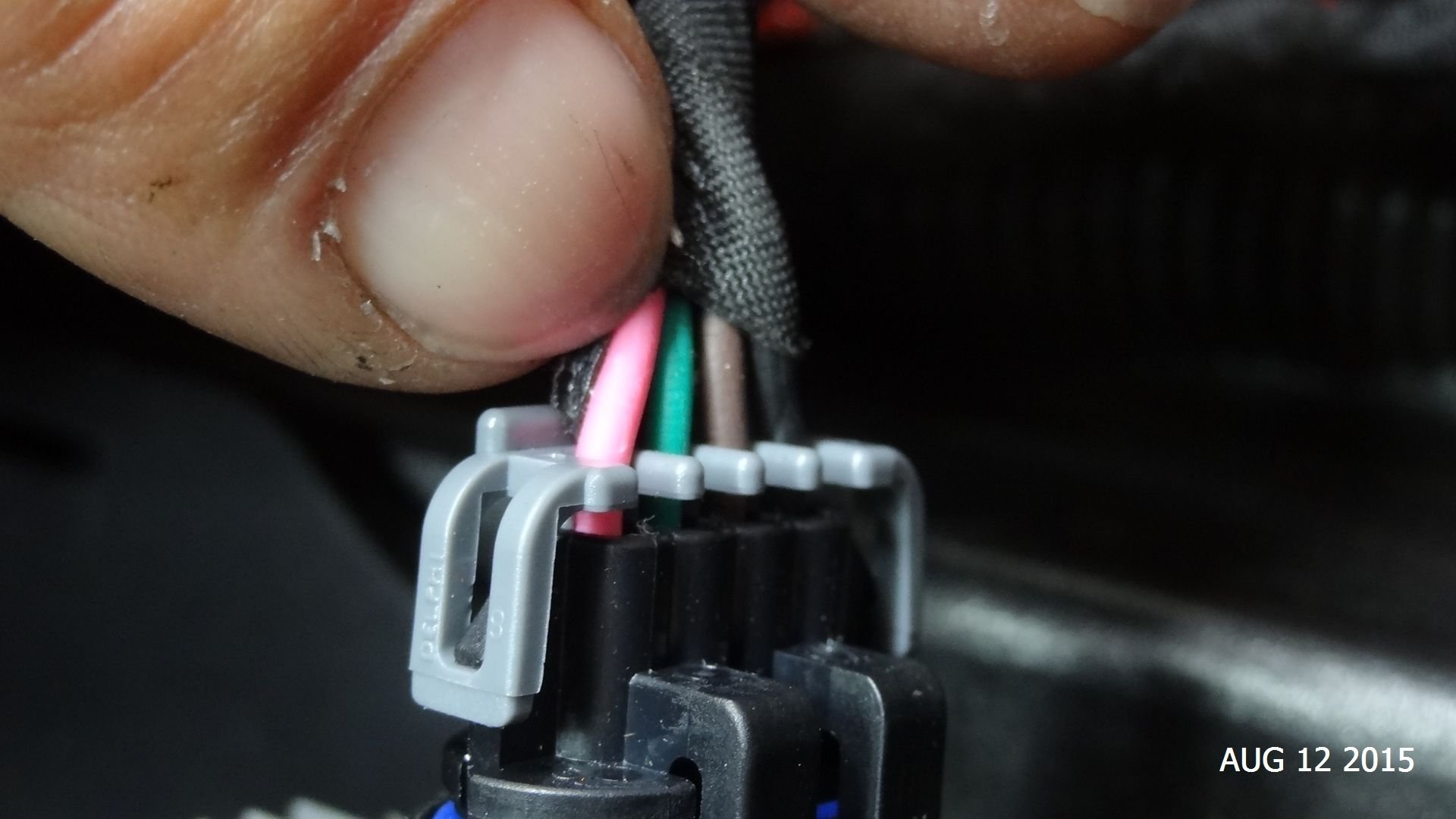

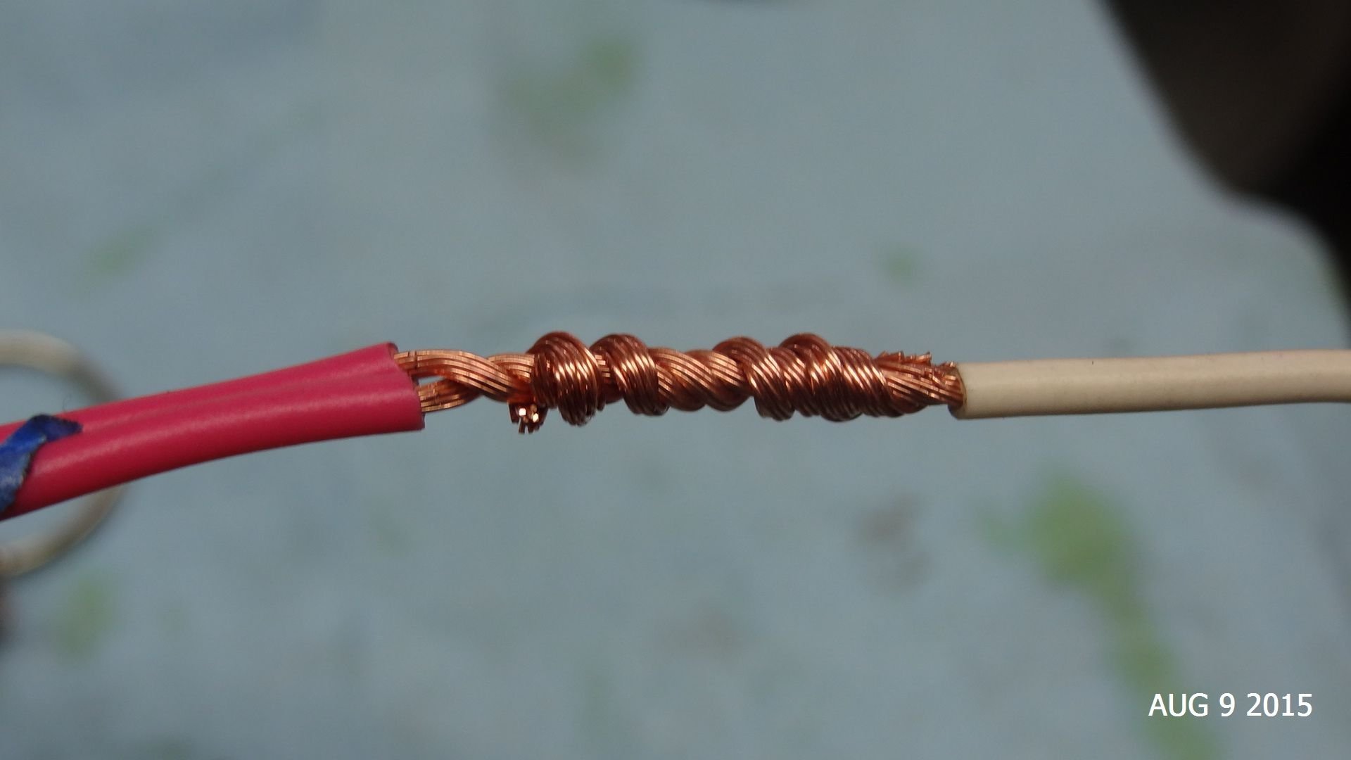

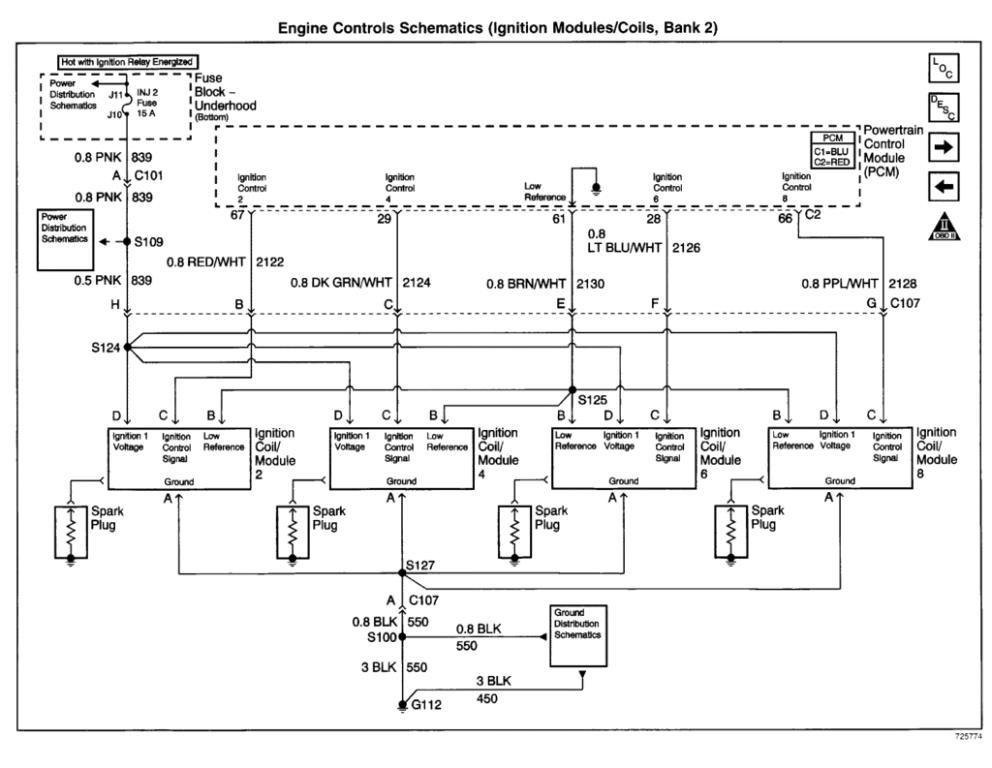

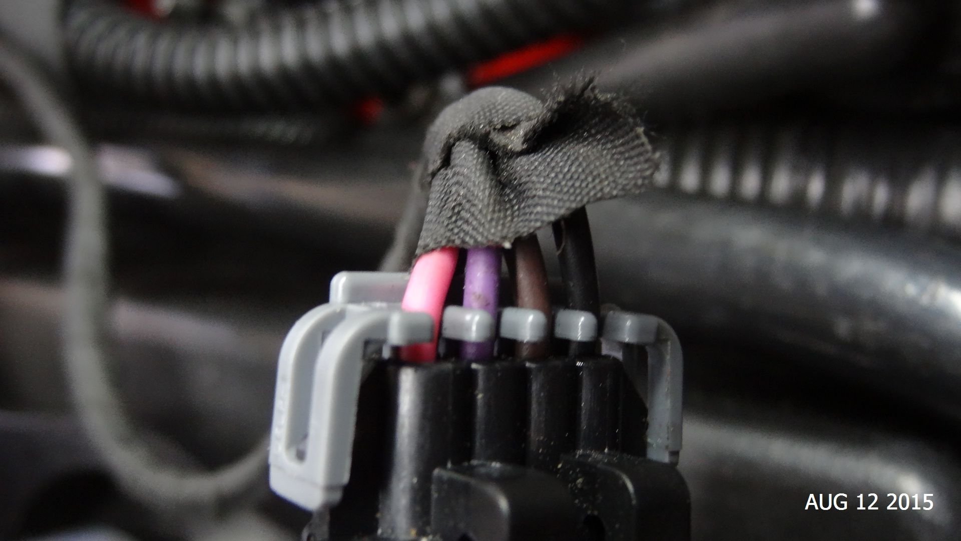

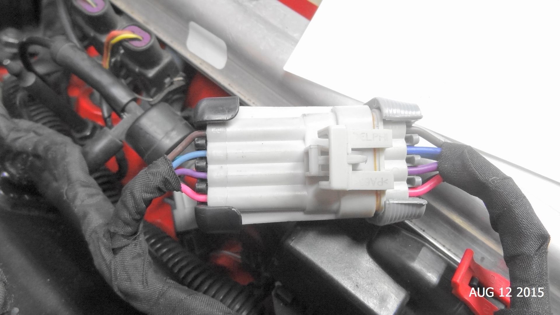

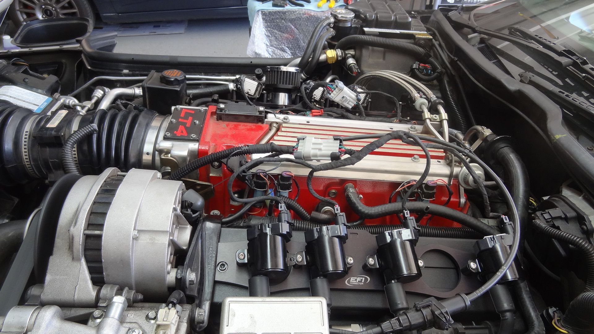

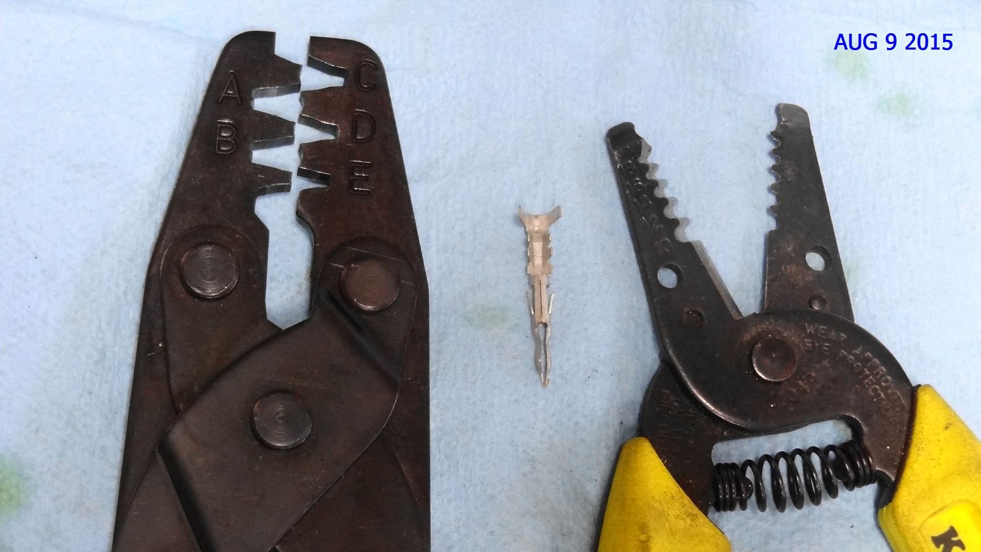

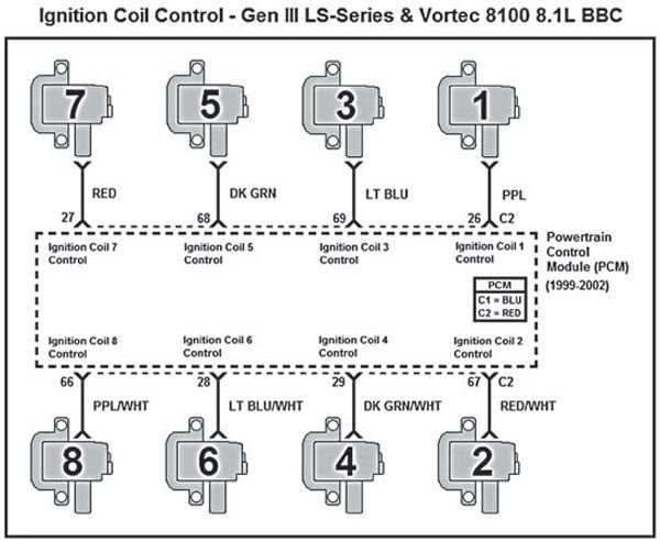

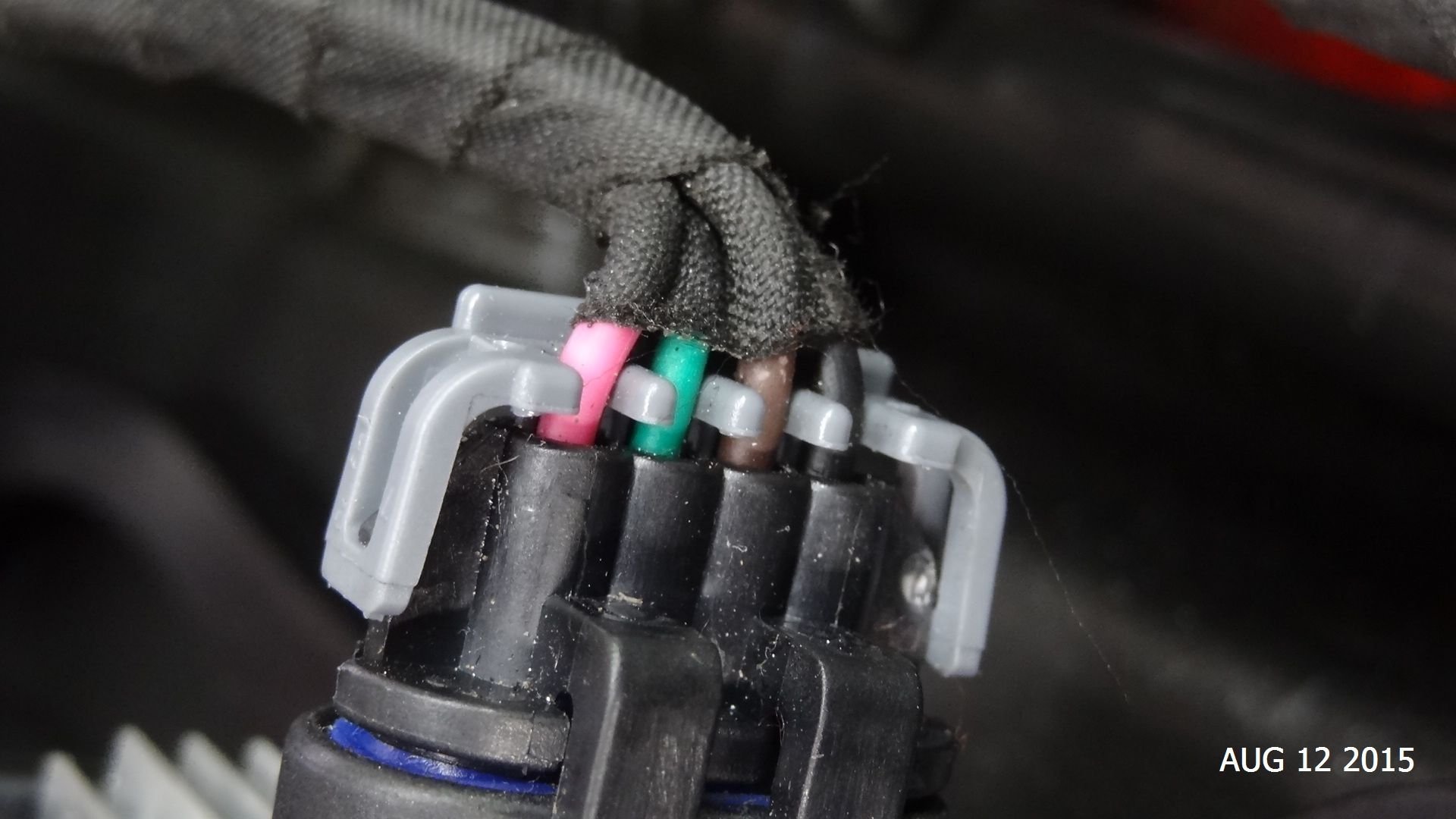

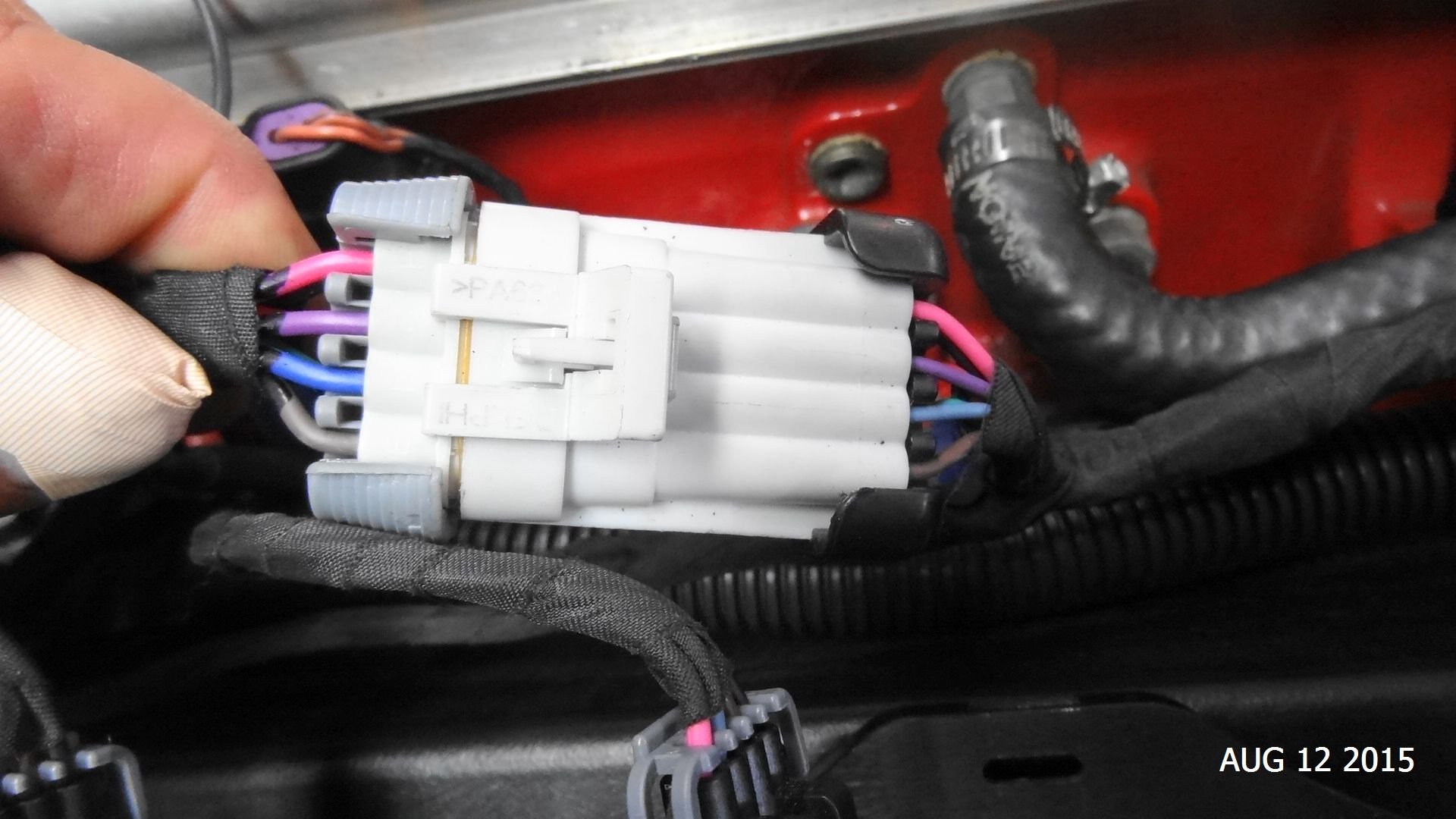

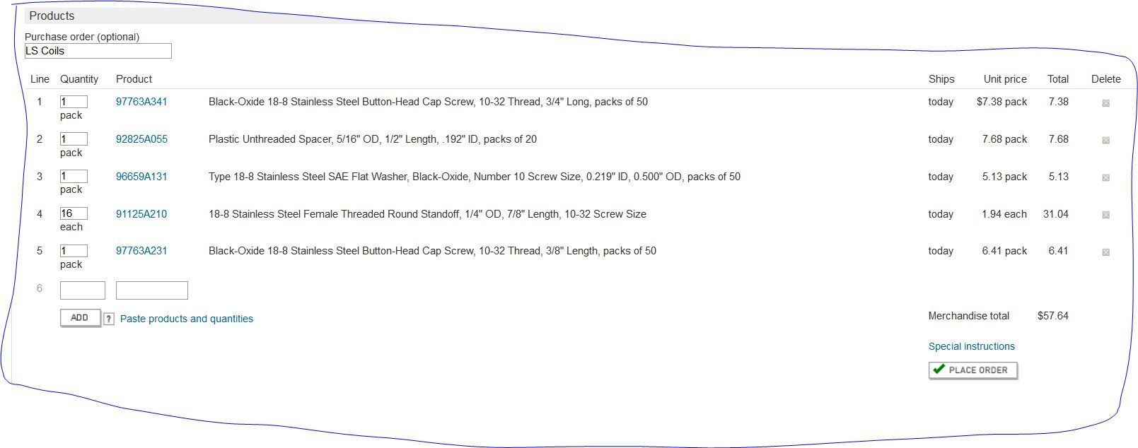

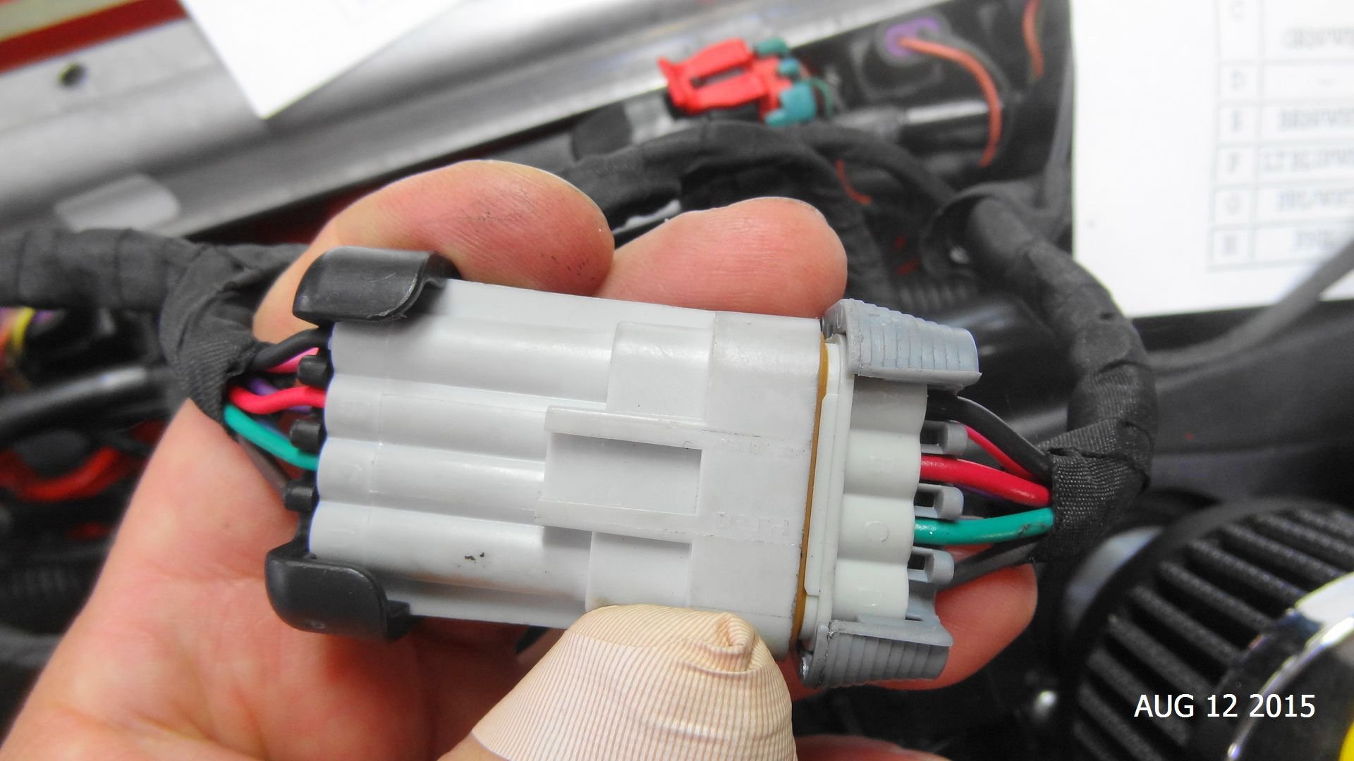

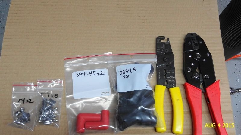

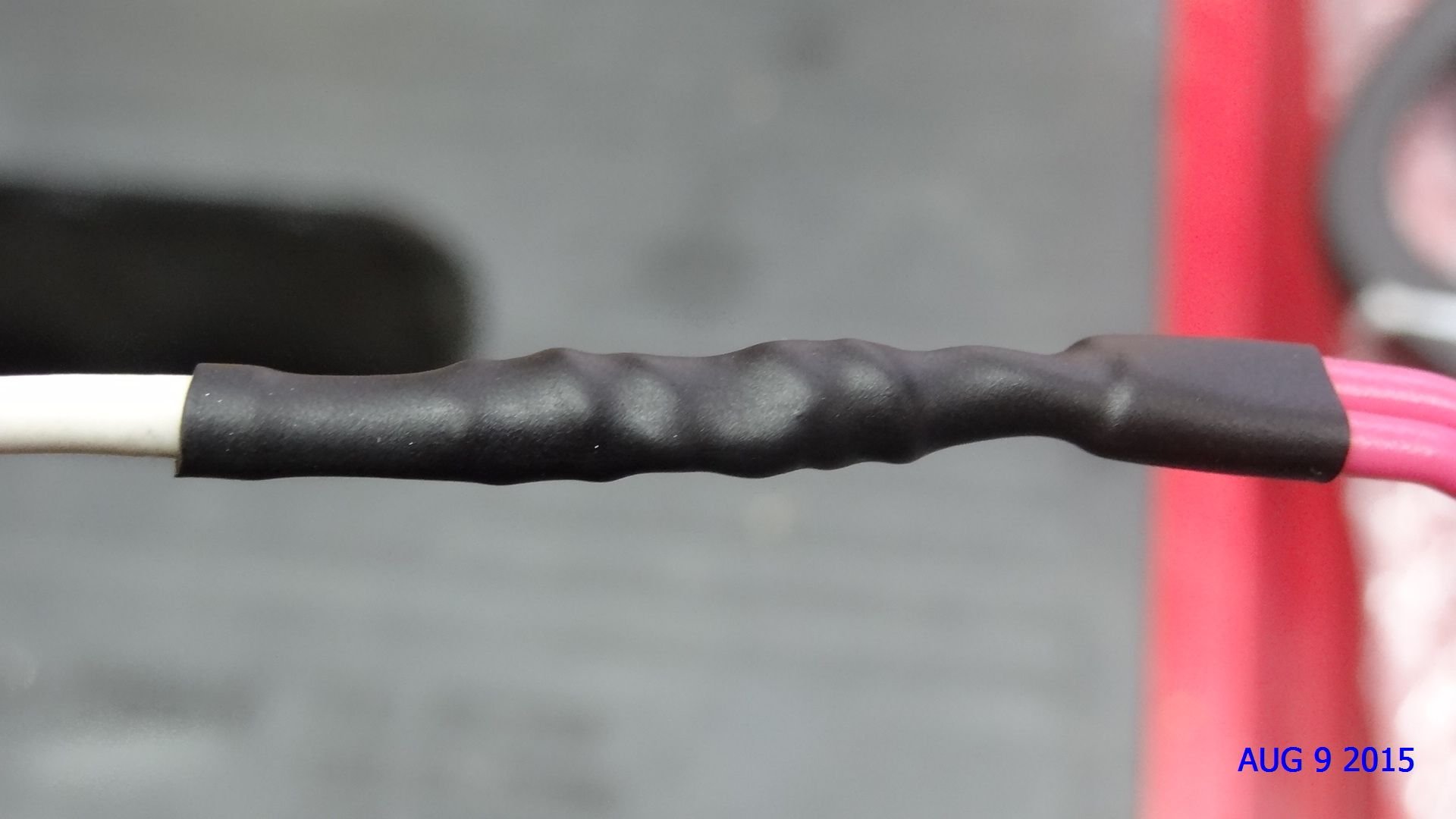

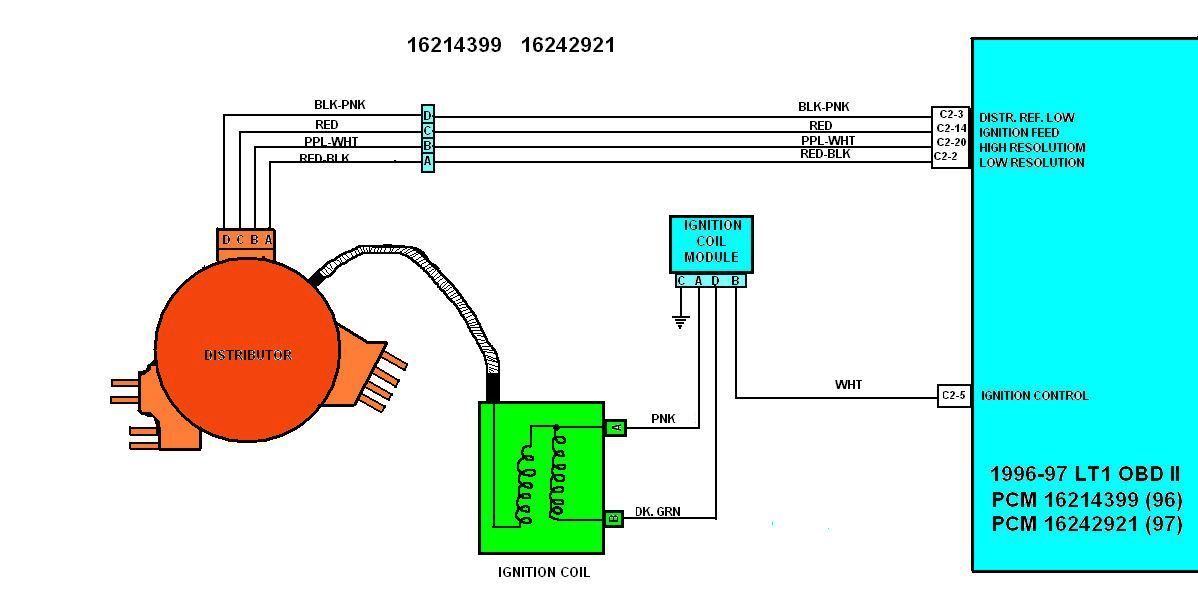

To install the LTCC you must know how to install an Opti-Spark, to weld, fabricate modifications with your hands, know how to crimp wires, and a tune would be needed.
Above all else to be patient on those connections. My wires came up backwards, and Patrick sent me the coil schematics.
Here are few shots on tools, and other things you'll need.
Dont get scared, it is a lot of fun doing those things.
In few weeks, I'll be doing the steering column rebuilt.

Pete, as you know I'm doing this. Magnecor wires get here Friday. Hell of a post
Also OP, if you decide to not cut the wires yourself, get them from Magnecor. Taylor slowed me down by a week.
