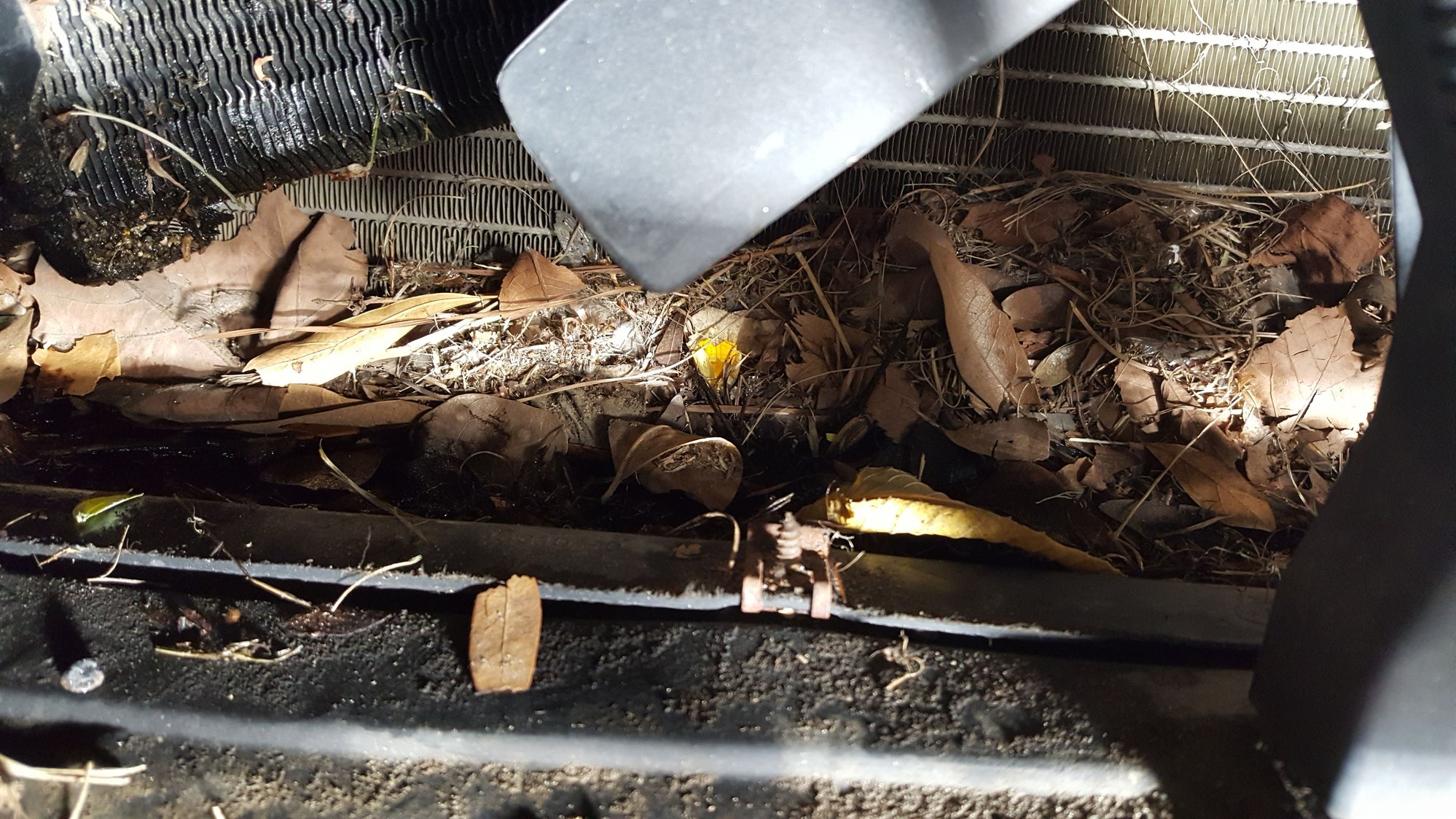

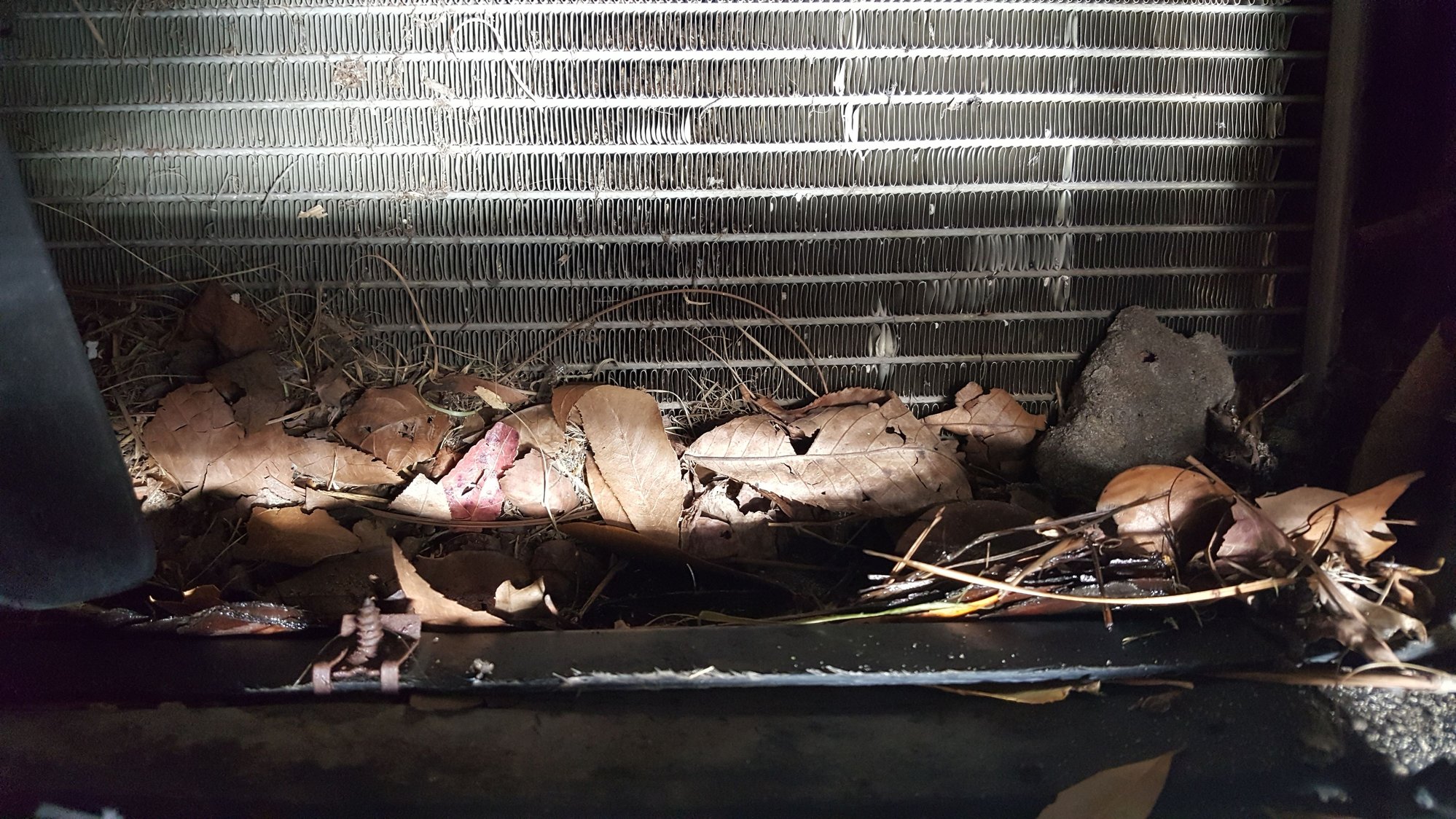

Couldn't find the humor section to post this in so here it is. The outside of the vette was so super clean when I bought it. Hard to imagine it was carrying 15lbs of leaves between the radiator and condensing coil. No wonder I was running 250!!

Clean the fins good and pull the knocks to do a proper flush. And hope you did not do any damage.
Pull the knocks? What's that?
I don't think I did any damage I hope. Luckily I was in a spot to pull over quickly and the temp came down at idle. It only hit 250 once and was quickly back down to 225 as soon as I stopped.

its not just raking the leaves and trash off the a/c condenser.
As you found, there will be trash between the a/c condenser and the radiator. Besides the junk that you can just sweep or vacum off , there will be a ton of seeds, small stones, insects and who knows what embedded in the fins of both the a/c condenser and the radiator.
to do the job right, at a minimum plan on pulling the radiator and spending a couple hours cleaning it to get all the small embedded stuff out; clean the a/c condenser as best you can with it in the car,...or...if you're planning on having any A/C work done that would require emptying the system (my situation), pull the a/c condenser also.
I know its a lot of work, but I consoled myself with the thought that it took a long while to get that bad.

I have pulled the radiator and am in the process of cleaning. Been kinda cold to get the water hose out and really flush it.
Next question is how best to fix the problem. I am guessing I have a gap at the top of my condensing coil allowing leaves to go over the top? I sure couldn't see any other gaps when I was taking it apart. There is nothing between the top of the coil and the plastic cover. I wonder if there was something their originally?
