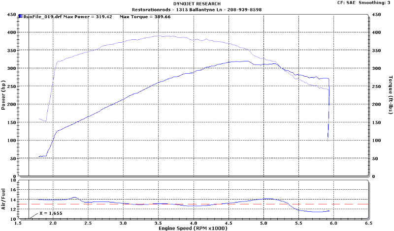

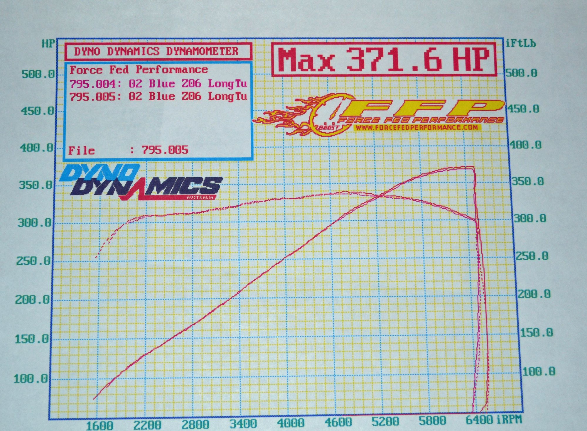

My 1991 has a Procharger 600B running at a low boost. The basic engine is stock. It did 319 HP at the rear wheels and 390 pounds of torque. The engine makes about 375 HP at the crank. Originally it was 245 at the crank. It now makes more power and torque below 4500 RPM than my slightly modified 2002 Z06. Here are the dyno charts. According to the local tuning expert and Corvette mechanic the engine will be just fine running as it is with no mods needed for reliability.
1991 dyno chart.
2002 Z06 dyno chart.
