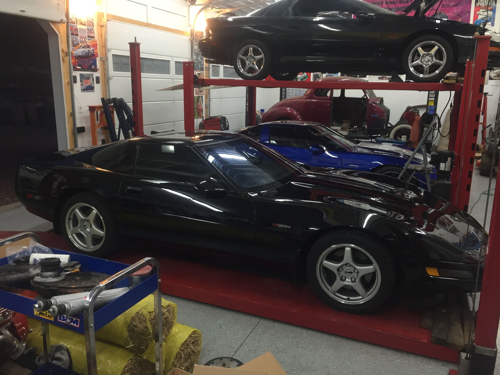

Measure, Measure, Measure.....Got a 9 thousand pound Bend Pac 4 post for my 2 bay garage and 2 C4's. Went with the bigger one, So I could get my 4x4 Chevy truck in the air for service. Now I have 9' 6" from floor to rafters. I use a roller seat to get under, Beats laying on your back on a creeper.I keep 1 up, 1 down for storage. Frees up 2nd bay...Was looking at 2 post, but didn't know how thick concrete of shop floor was.Love the 4 post

I have 4 - 9000lb bend packs...love them. But like he said ^ measure.

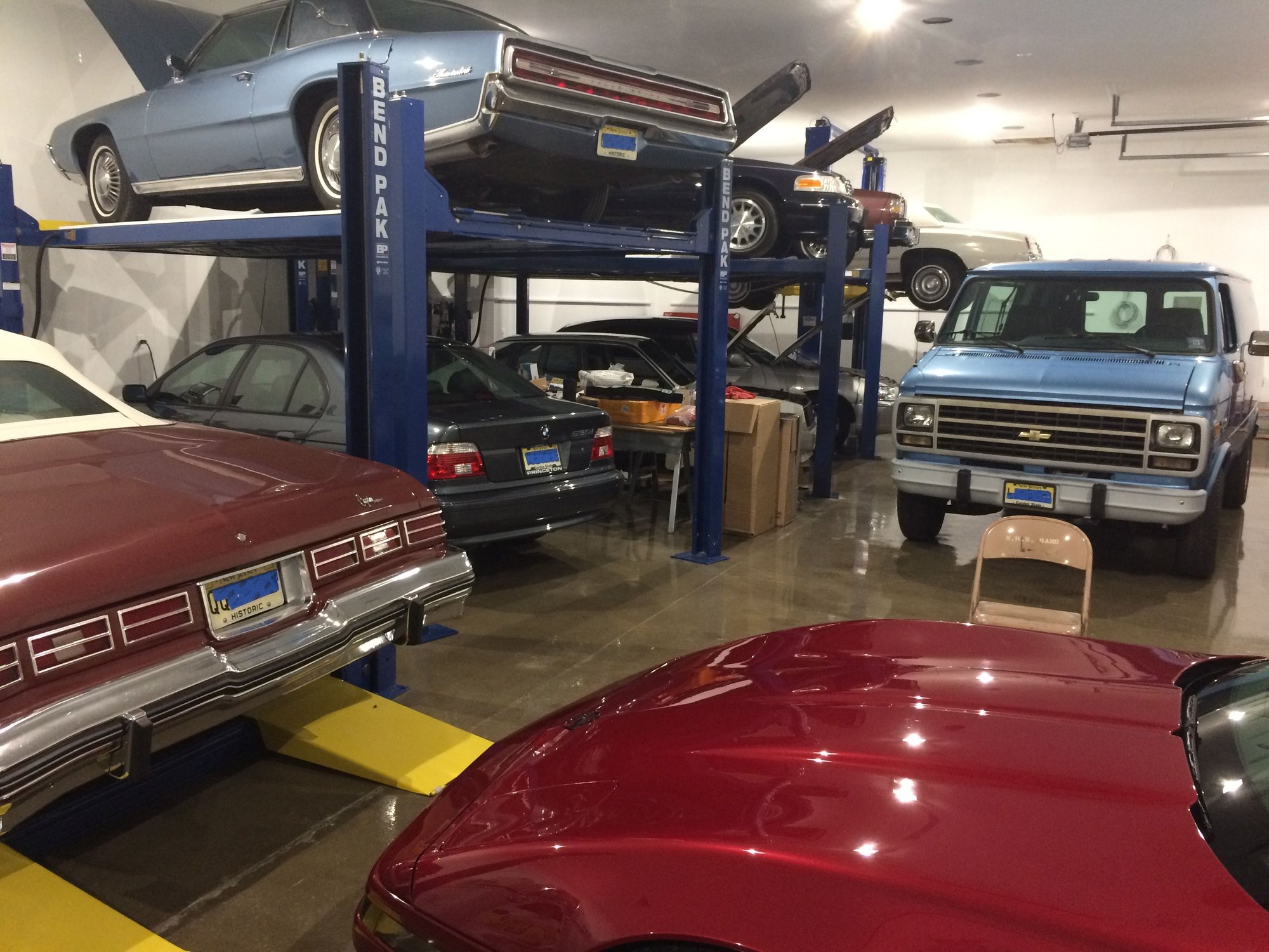

If you are adding a garage bay and can possibly get the height...I recommend a 17 foot ceiling. That is what I have in my pic above ^ and I can put just about any car on or under (with lift at full height position) with the hood fully open with plenty of clearance. I don't know, however, if the vette could be on or under with the hood open because it has never been on any of those lifts as I use them mainly for storage and it is always kept by a door as I've been driving it the most of all in the garage.

Well, yes but no...it is a habit I developed when my storage was in garages less "tight". Mice, as we all know, can be a problem and even though the garage in the photo I built and is pretty well sealed, I always worry that one will get in and make a nest under the hood without my knowledge. This has happened to me more than once so it doesn't hurt.
I agree that lifts are dangerous so I only buy new and have them assembled by qualified people. The 2 post in the rear of my photo is a rotary 12,000 lb. I installed 2 - 2x2x2 foot footing in the floor at the time of pour.

I assume the "XW" in the model number means "extra wide". I notice that some of you are talking about full size pickups and SUV's. This is the one mistake I made...I assumed that because I had some very large cars that even light trucks would fit on the lifts...I had measured the largest of them (the red Caprice in the pic) but not that blue chevy van or my 97 1500 2wd pickup...neither of which will fit on those lifts. They are like 2 or 3 inches too wide. It's not the end of the world but it's one of those things that if I could go back in time I would make sure I got extra wide units for more versatility.
