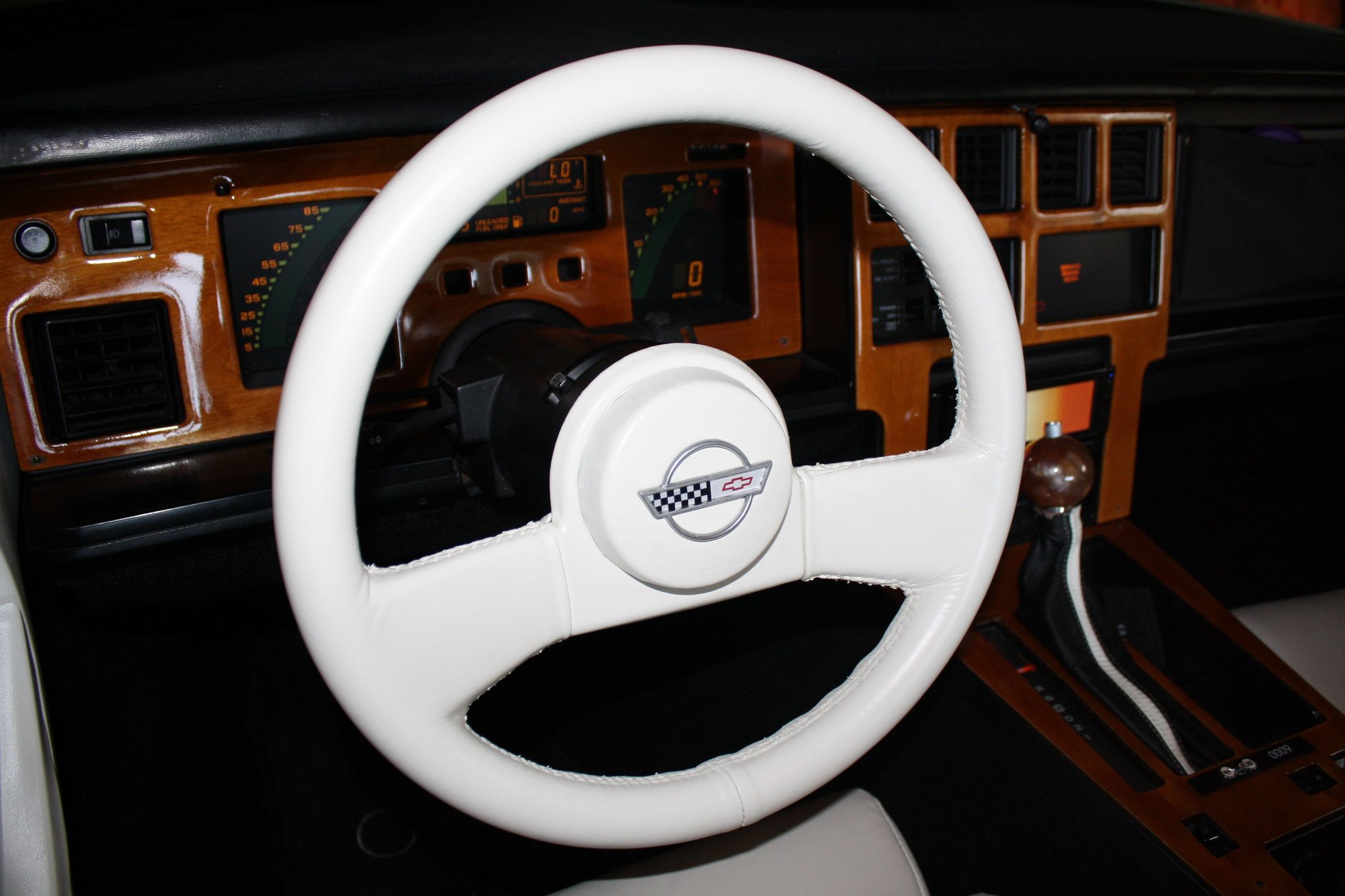

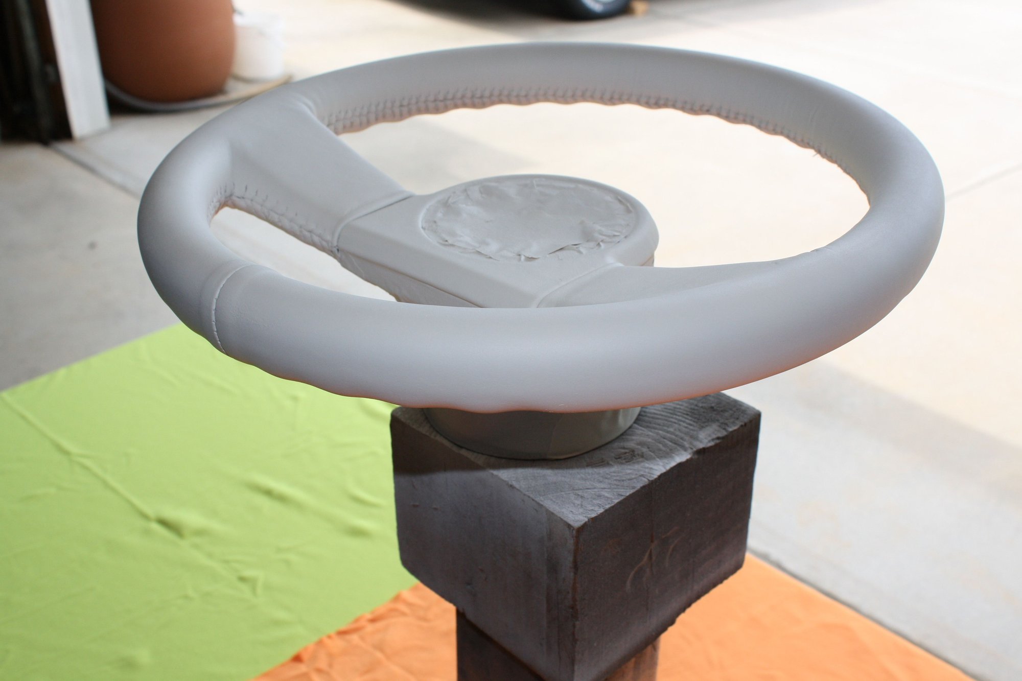

Hope I didn’t leave anything out. I have pulled my wheel several times because I bought a new wheel, the spring had to be sanded to remove the rust off on the big end so my horn would work, and finally I re-painted the wheel to make it look new again.
re-painted
Installed

That thing looks crazy new. What was the process?

Does look spectacular
