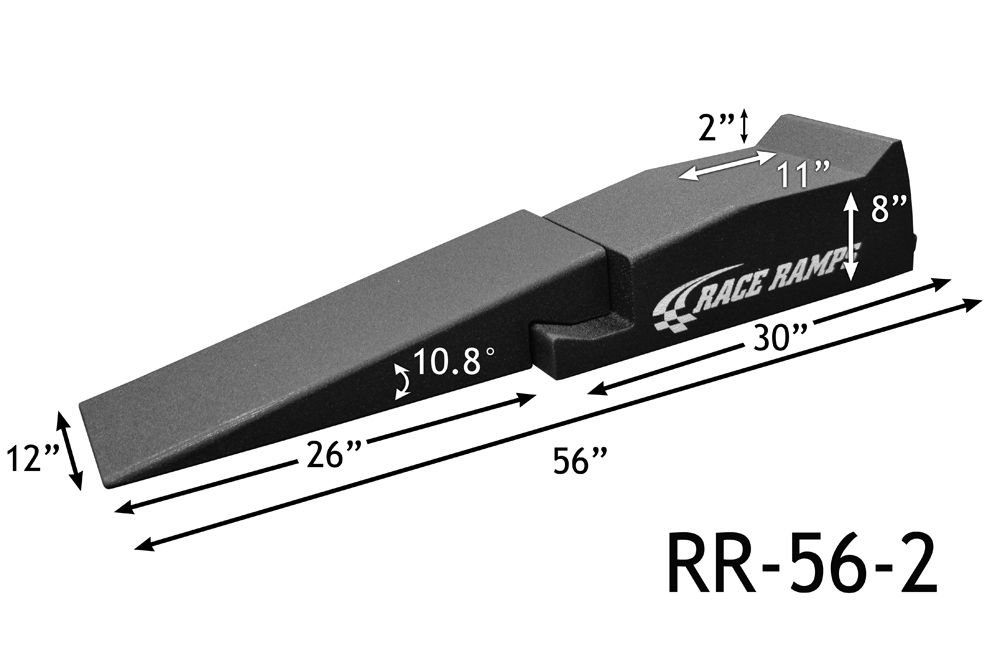

Hi
I was looking at race ramps and the ones I'm looking at are 56 or 67 inches. I was wondering if the 56 inch would work for my 1984 corvette
thanks

The 56" and 67" ramps have the same 10.8 degree incline. When pushed up against the front tires they will have exactly the same amount of car-to-ramp clearance. The 10.8 slope should be fine for your car.
Originally Posted by rat123
Hi
thanks

I have a lift and also a set of Race Ramps. The 2-piece 56" ramps. I find myself using the Race Ramps much more often for routine maintenance. They're just too darn convenient and can be stacked out of the way in minutes.
They clear all of my cars including a C4 and C5 as well as our sons C6. They're not inexpensive, but I believe they're worth the price based on their strength and convenience.
Good luck... GUSTO

these are the ones I was looking at and wanted to make sure my 1984 would work on them
thanks again
Good luck... GUSTO

If you look closely you will notice that the slope on the incline section gets steeper about 8" from the top of the incline. That means that the ramps are most likely the RLL-87-2 or RR-72-2 model. These two-stage incline designs have a 6.8 degree initial incline which means they effectively have an integrated XTender. The shallow incline on these ramp models is not required for a C4.
https://www.reverselogic.us/2-stage-incline-ramps

I love my two piece 56 race ramps! I think if my car was lowered, I would need to buy the longer ones. And I'm not a fat guy by any means. That is, if I wanted to have the same movement as I currently have under the car with the 56's.

The RR-72-2 ramp has an 8" high platform. It is the equivalent of the RR-56-2 ramp combined with the RR-EX-12 XTender. If you already own a set of RR-56-2 ramps and you lower your car or acquire a lower car than it probably makes more sense to get a set of the RR-EX-12 XTenders rather than a complete set of RR-72-2 two-stage incline ramps.
