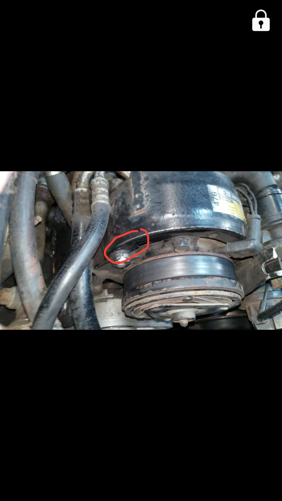

Trying to get my A/C working in my 85. It has been converted to 134a. It blows ice cold and the compressor cycles as it should when I charge it but only holds the charge for less than a day. Today I found the leak. See pic below. It seems to be an odd place to leak. It's on the front of the compressor on the side towards the passenger side wheel. It just bubbles on bubble after another right from that spot and yes there is green dye I the system and yes I know I need to get it professionally evacuated and filled once I get this fixed. My question is, is there any way to repair this compressor instead of paying the money for a new/reman one? There is also a used one right down the road from me for an 85 that someone has for sale off a parts car which I am considering, although, if I can, I'd rather seal/fix this one if it's possible but I have no idea. Thanks for any responses or advice.

The short answer is no. You could try some of the leak sealer r134a products that are out there. Most of those are o-ring swelling oil additives, it may stop it.
Rebuilding it yourself is possible but not recommended for a first time project. Some of the tools you will need will wipe away any money you save. R-4s aren't that expensive.

Ok thanks for that advice. I'm going to buy a driveworks brand reman one from Advance for $111 then

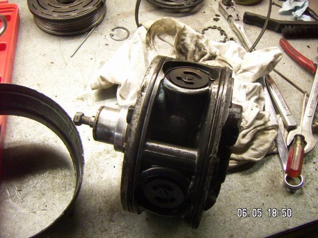

the leak is the o-ring you can see them in this pic with the case off
