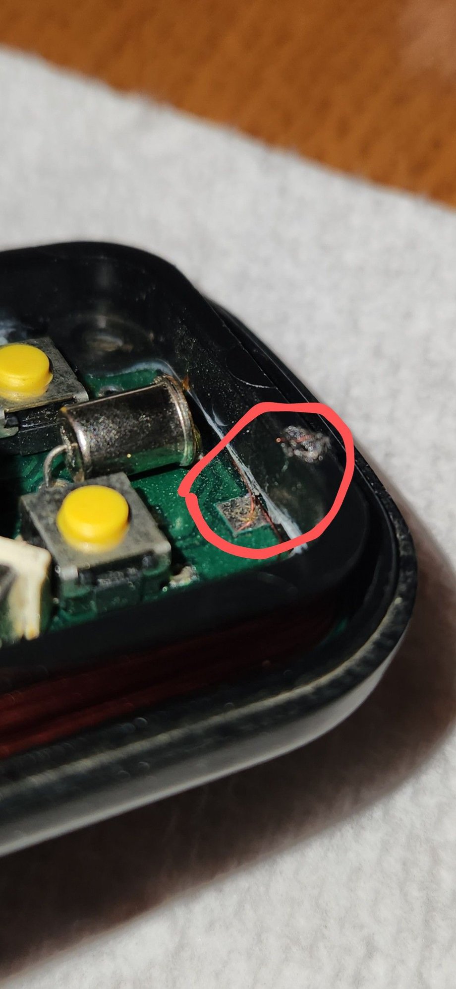

Old Nov 9, 2023 | 02:48 PM
STARCRASHER22's Avatar
STARCRASHER22
Joined: Mar 2023
Posts: 43
Originally Posted by pifo1964
Changed mine a week ago; no need to reprogram.
So my key fobb hasn't been working and was recently told to buy a Renata battery instead of using a energizer battery, at the moment I'm waiting for it to arrive but did noticed a difference between my my fob and yours, would this little copper wire that isn't connected together like yours affect the fobs working capability? (It very hard to see tried my best to take a good picture of it)
