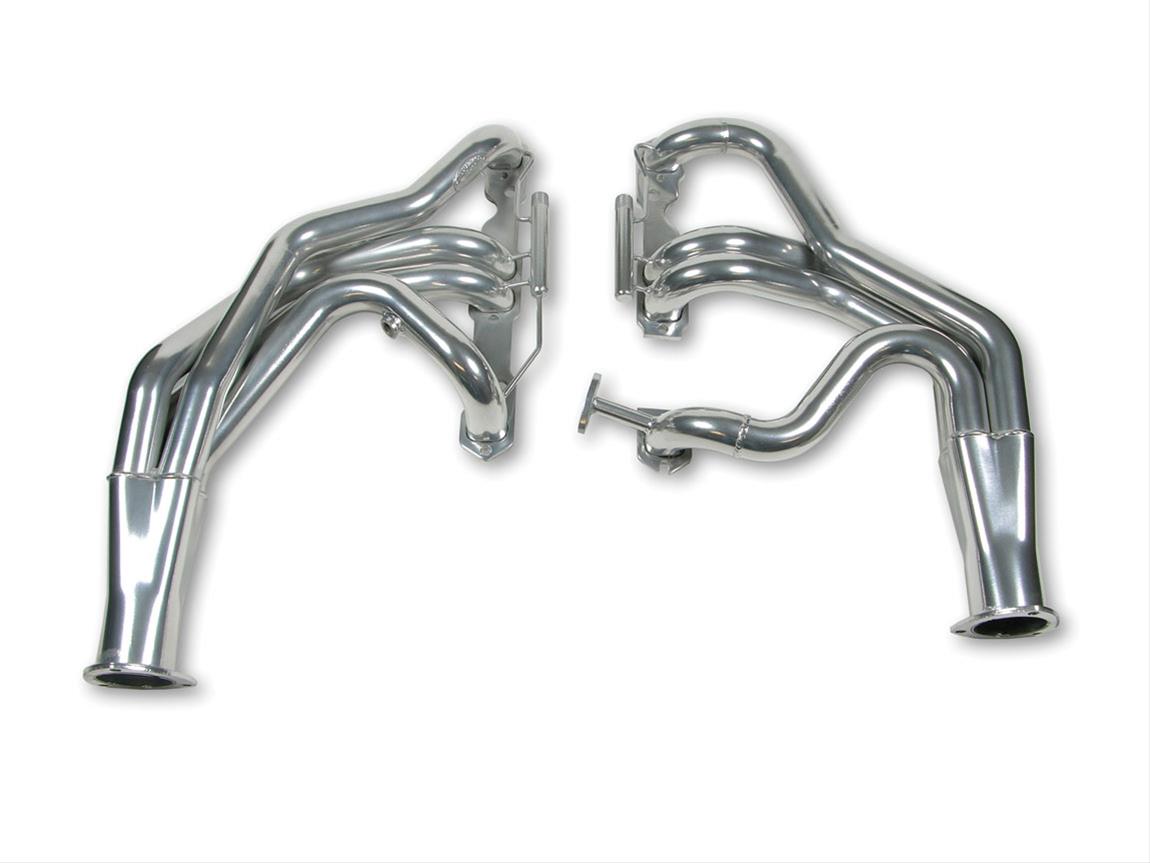

Looking at the headers listed for 84-91 L98s they show what I think is a connection for the EGR valve coming off one of the tubes? Do they make any specifically for the models that just have the air pump fittings going to them? Can I simply blank off that flange and have them work?

TPIS and others make a plate to block that off

Perfect! Looks like I am the new owner of a slightly used set of Hooker Super Comp headers.
