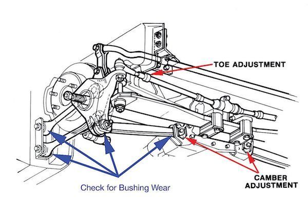

Checking out the rear suspension on a C4.

The rear on mine wasn't as tight as I'd like, while upgrading the to Banski kit I found worn bushings in particular the camber rods. Once upgraded, definitely tightened the rear up and eliminated some noises too.

Sounds like a bushing issue to me. You will be amazed at how much some bushings will change the way your car behaves under power and braking. I would start with trailing arm bushings. Those are responsible to locating your rear wheels during suspension travel. My car would shift (but not steer only the body felt like it shifted) to the right when accelerating and would squat down in the back and give a little wiggle when I got a high RPM 1 - 2 shift. I replaced the trailing arm bushings with Poly and OMG it was a new car. No more shift on acceleration and now I could chirp the tires on the 1 -2 shift instead of having the old rubber eat up all the power. It made such a difference that I'm now doing front upper and lower control arm bushings and ball joints. PITA job but should pay high dividends. The sway bar bushings may improve body roll a little but will likely not correct the turning you have described.

I have read a bit on this too. Seems that this is a common issue when the toe links start to fail. On vacation out of state now, will start the investigation when I get home. Already bought poly bushings for the sway bar. Figure, may as well do them.. cause.. well I don't think anyone did them ever. looks like the popular toe link set up everyone suggested, is not longer made by banski, Any other suggestions on a replacement set up?

Will definitely this all these bushings a once over when I get the rear end up in the air.
