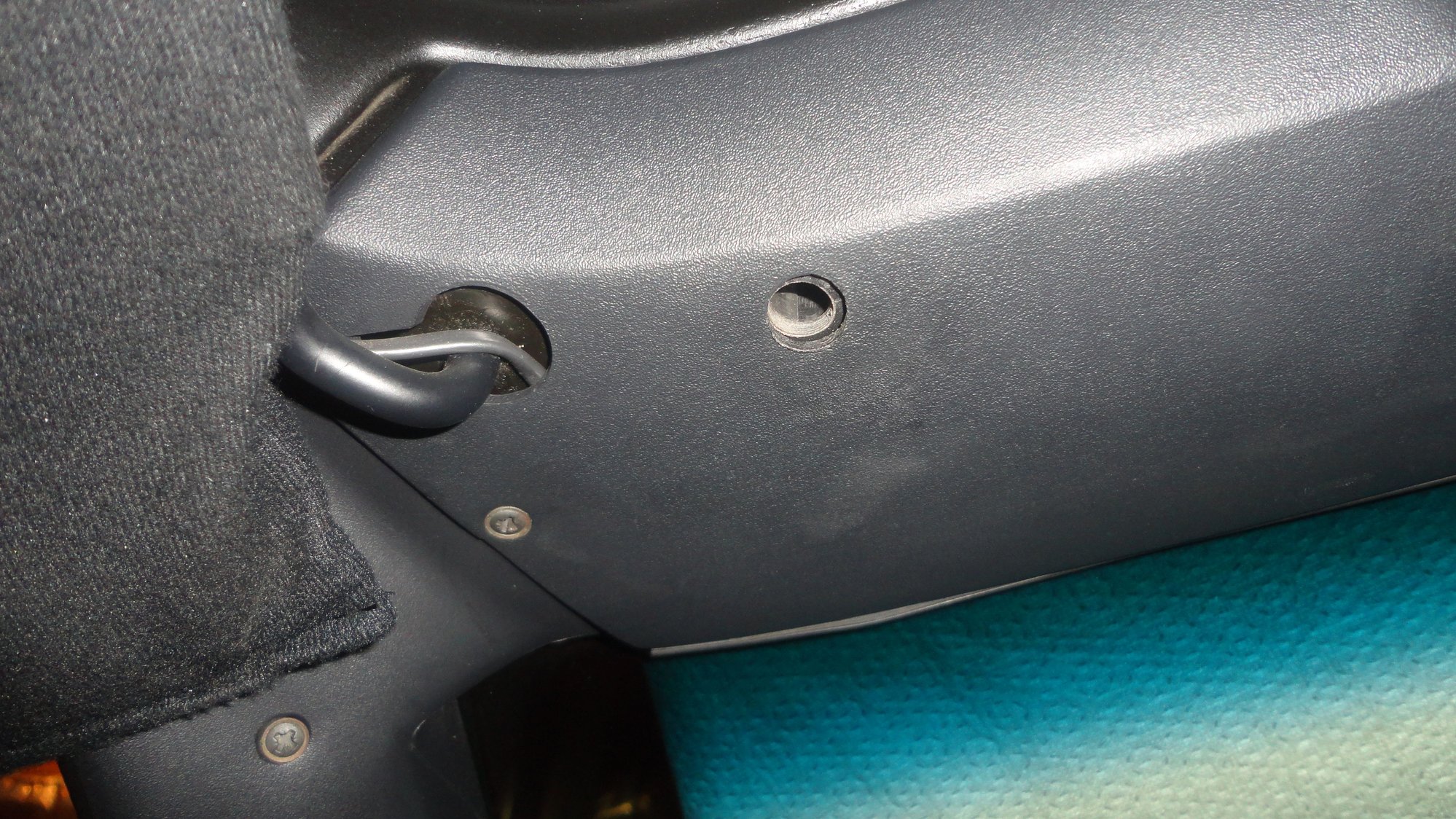

Did it come without a top? The front bolts should stay in place. accessed thru the hole by the sun shades. The rear generally stay with the top.
Rear mount center bolt holds the top in (top is off car)
Front
Access hole to bolt in windshield header
