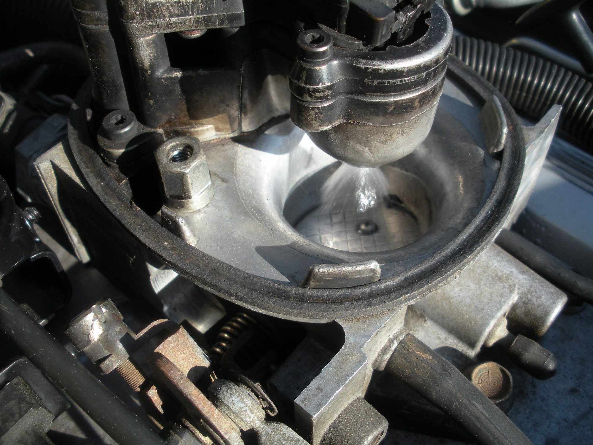

Is the spray pattern from your injectors a smooth cone? No dribbling? This photo caught an injector pulse mid-stream! Look at the spray pattern with an ignition strobe light.

They are old enough. I'd send them out for testing instead of trying to peek at it with a strobe light. Not like it can't benefit from cleaning after all this while.
