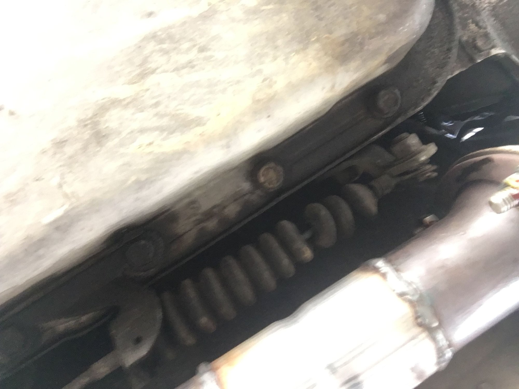

hello, maybe you can give a bit more advance, today I got under the car to check out the kick down cable, I had a friend press the throttle down, my bet was that this lever, shown in the picture, should've moved. Is this the case? Because it did nothing, which to me seems strange... am I lookin in the right place?
No, no.. That is the shift cable.
The TV cable (NOT a "kickdown") termination can't be seen from underneath, as it goes through the case on the passenger's side and attaches to the Valve Body.
if if I were to drop the trans pan would I have a good view of the cable attachment point?
https://youtu.be/D109Fz1SK18
Yeah.. There's a little linkage for it on the passenger's side.
But there's really no reason to look at it. There's no adjustment under there.
Old Apr 28, 2017 | 06:34 PM
confab's Avatar
confab
Joined: Nov 2013
Posts: 3,451
Likes: 336
From: Greater Cincinnati Area.
PS: It attaches to a little linkage on the TV plunger. The plunger is spring loaded, so if you are wondering about it and if it is working, you can just pull the end of the cable and it should spring back.
