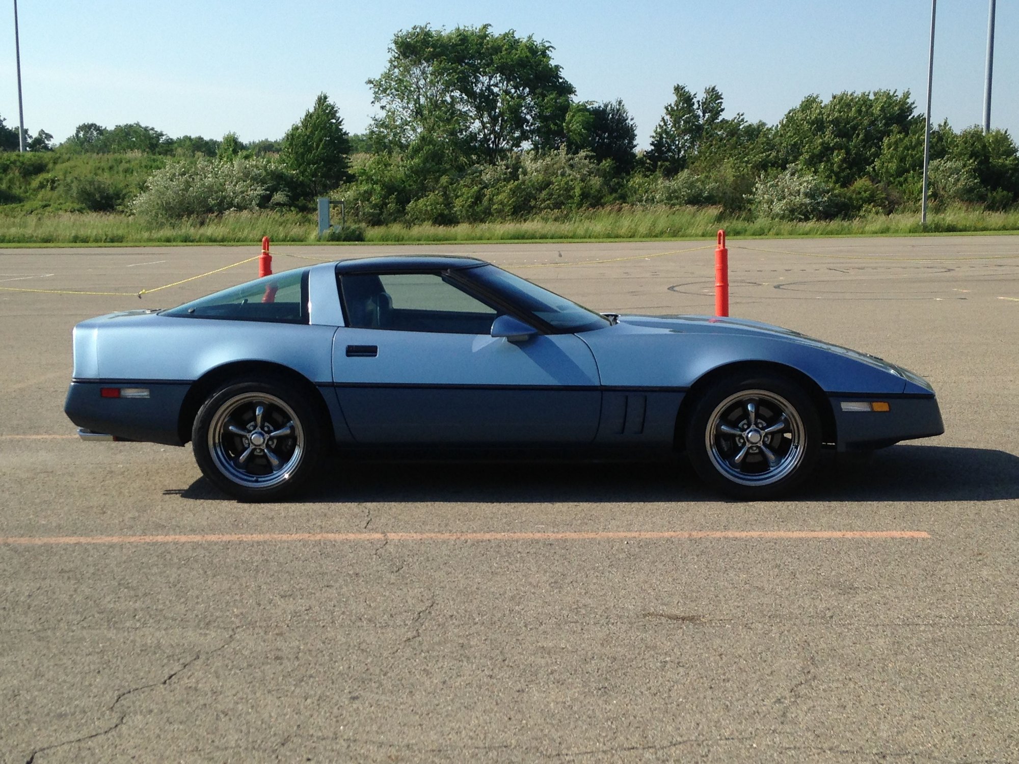

Old Jun 11, 2017 | 09:11 PM
sb66's Avatar
sb66
Joined: Jun 2016
Posts: 1,053
Likes: 102
From: Ohio
To torque thrust wheel question
sb66's Avatar
sb66
Joined: Jun 2016
Posts: 1,053
Likes: 102
From: Ohio
Old Jun 11, 2017 | 09:12 PM
sb66's Avatar
sb66
Joined: Jun 2016
Posts: 1,053
Likes: 102
From: Ohio
Old Jun 11, 2017 | 09:16 PM
sb66's Avatar
sb66
Joined: Jun 2016
Posts: 1,053
Likes: 102
From: Ohio
need a better background - messy garage
17 x 9.5 - +32mm with Yokohoma 275/40 r17
steering and ride - to me - seem greatly improved -
