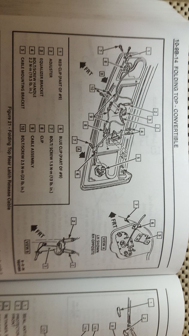

Hi all,
My deck lid on my convertible C4 has a broken cable on one side. I purchased a OEM for it. I am looking for you tube or some type of instructions that cover the remove and replacement. Can anyone help me please?

From my 95 fsm. Hopefully these are readable and same application. Sorry no YouTube walk thru.
