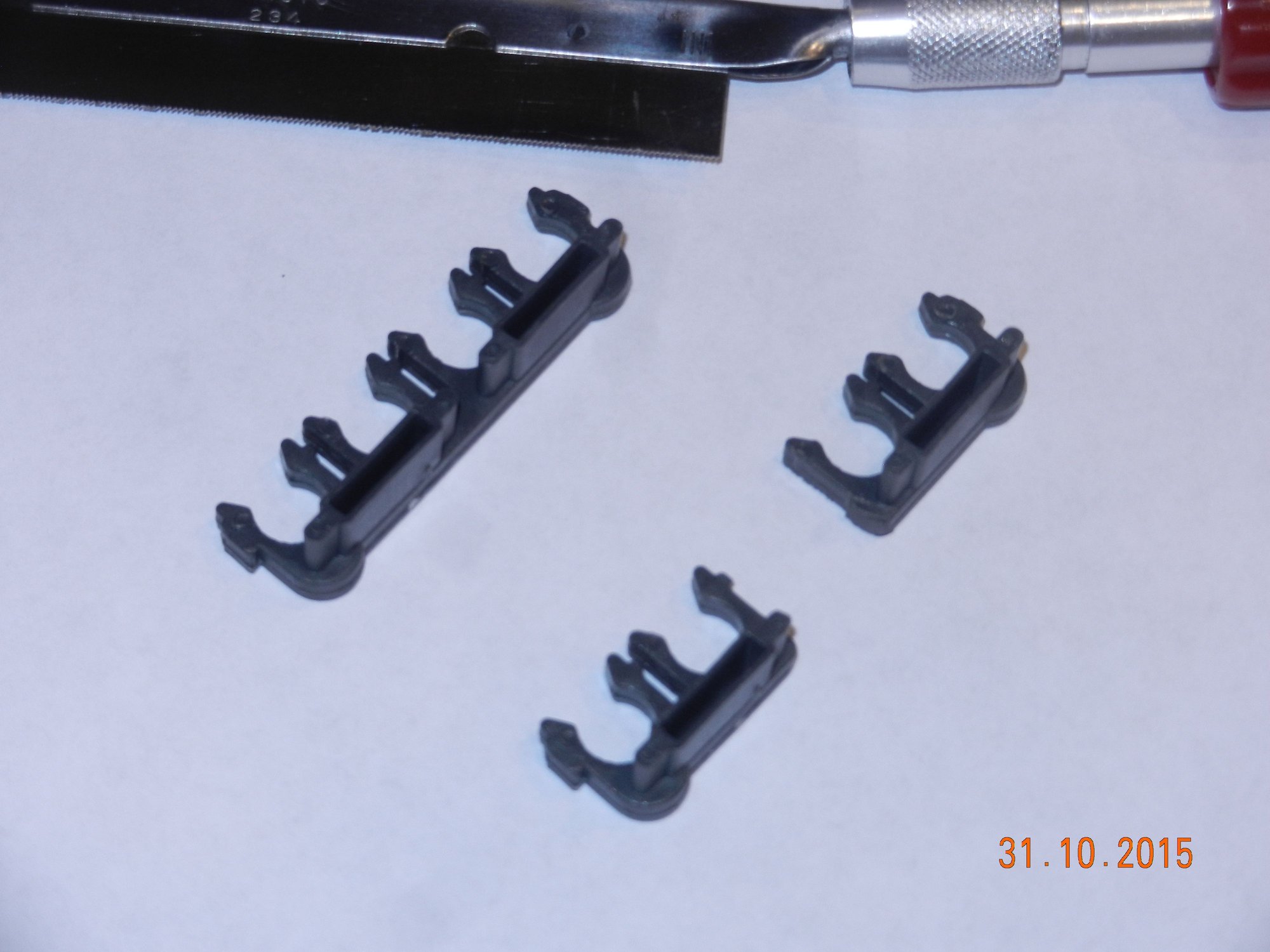

What happened to your plug wire retaining clips? They'll keep your wires away from the hot spots!

Broke/lost over the years?

Mine are gone as well for the most part. Would be great to find the part number and order a new set.

not sure what's still available from GM, but if any, they will be pricey. dorman has replacement clips - note on the 2-wire clips, I just cut a 4-wire clip in half with a small xacto saw. I'm most cases, you only need the wire holder part (2 wire) and discard the locking clip. shop around for the best price - available locally and on-line. you can get real creative and solve the problem without spending a bunch of cash. probably do your whole car for what GM will charge you for a single part (if available).
in fact, check out google images for what's out there...
https://www.google.com/search?q=dorm...=1496147165754
making two parts from a dorman one part...
