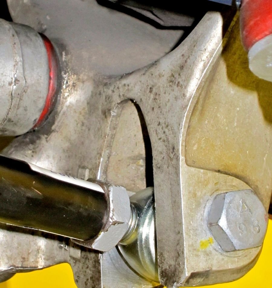

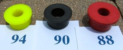

There is no good solution here.
There is no such thing as a universal bushing. Every bushing is different. The problem is no one will tell you what he rating is.I discovered a variety of hardness ratings when I checked a variety of bushings.
The Yellow Poly From Energy Suspension is the Stiffest
Heim Joints are still the Best - If You Clean Them on a regular Basis
Richard Newton
C4 Suspension

When I was rebushing the suspension, the only information difference I found was that the black material had a graphite content. I chose that for the sway bars, red for everything else.

I would use a press for installation. You want to slide it in smoothly and evenly.
Make sure you clean the barrel/opening carefully. You don't want the bushing hanging up on a burr.
Lube carefully.
The Yellow Energy Suspension bushing has held up really well.
Richard Newton
