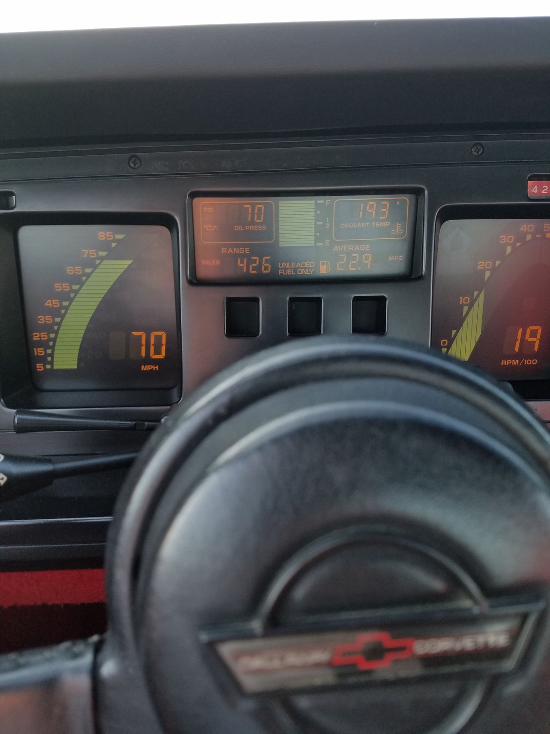

And 1984 Corvette with synthetic oil 154,000 miles. 50 pounds pressure on highway, 11 when temp is 216 at idle in drive. Is that normal.

I hope this helps

Rule of thumb, 10 lbs. per 1000 RPM. With that mileage original engine your good. In my 94 Coupe I now use Mobil 1 High Mileage 10w40 and it put my oil pressure up about 10 lbs. more than Mobil1 5w30. I have 105000 miles on it. Now always 20 lbs. at idle hot,50-55 hot on hiway.
