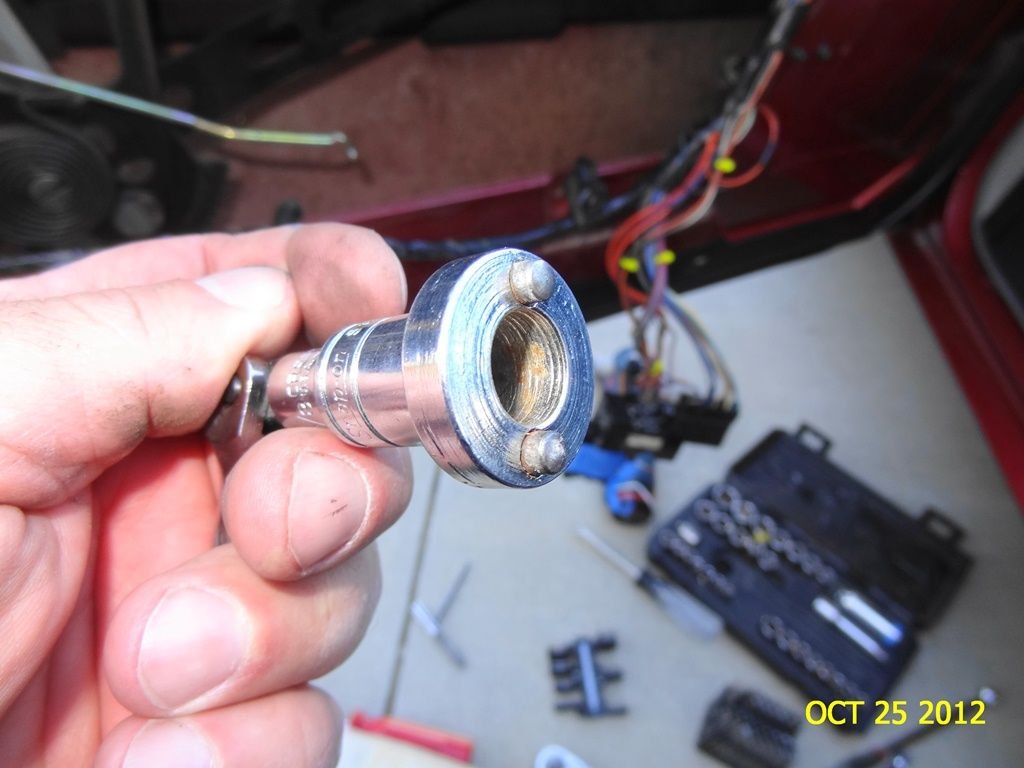

I'm looking for the tool that tightens the rear glass (on a coupe) to the
hinge. The fastener is round and has two holes for a fork-like tool to engage it. I tried: Mid America, Ecklers, Corvette Central, NCM, and the GM parts service. Has anyone here encountered the tool I need?
Thanks in advance.

There are various size "spanner sockets or wrenches" for the spanner nuts. I've seen people actually grind an old socket to make an application specific for their needs. A few minutes with a Dremel and you're done. Many use 90° snap ring or needle nose. The sockets were very popular years ago and you just walked into most any automotive tool store.

if your looking to buy one, i'm thinking the correct term for the tool is a "face pin spanner" wrench. you will have to size accordingly.
I've seen more than one person make one from an adjustable wrench. seems to work OK.

As WVZR said, I used a pair of snap ring pliers with 90 degree tips.
Works fine. It doesn't need to be that tight.

What you're looking for is a pin spanner. Google it and you'll find plenty of options. Here's one that lives in my toolbox for bicycle work:
http://www.parktool.com/product/adju...-spanner-spa-6
You'll need to pay attention to the diameter of the pins and holes, and the spacing between the holes unless you're using an adjustable spanner like the one I mentioned above. Previous replies have also given you some good suggestions.

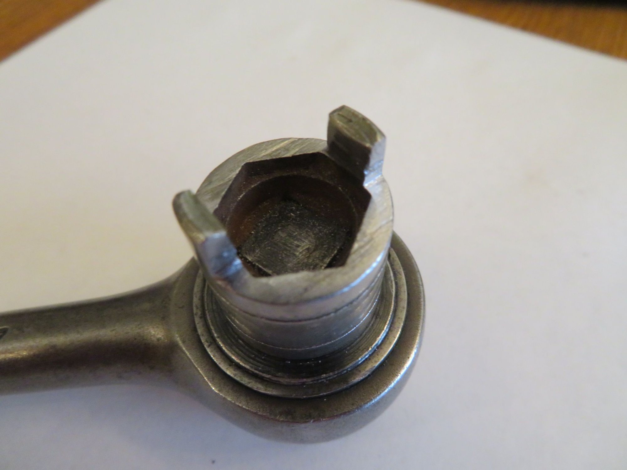

I needed to remove my spanner bolt retainers because of a rust issue. I did not have a tool to remove the bolts. i was going to make one out of an old wrench, but I took WVZR-1 suggestion on using an old socket. I used a 9/16" six-point, 3/8 drive, shallow, and the fit and sizing was perfect. took all of about 15 minutes to fab.
i'm only removing one at a time for refinishing, but the first one came out without issues. my original is good and solid, so a quick trip thru the blasting cabinet and a couple coats of enamel and I should be good to go. thanks WVZR-1 -

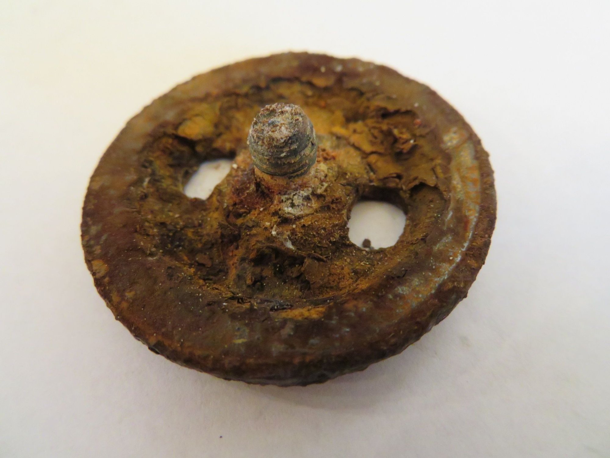

not trying to go OT, #2 - do you think I got it in time?
that friggin' thing looks like it was salvaged from the titanic! still feels solid - appears to be mostly cosmetic. to the blasting cabinet....
