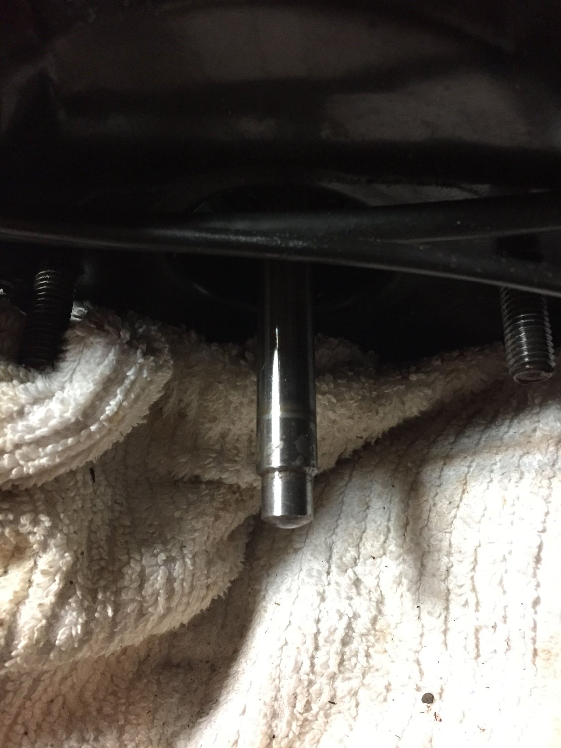

If you remove the master cylinder you can see a small jamb nut at the end of the rod inside the booster. You can loosen it up and turn the rod to lengthen or shorten the travel into the master cylinder. Lemmy find a pic... hold on

Heres a pic and theres a lot of threads on it in C4 Tech Its just the very end that you can turn..

91 Having this same issue with both front brakes dragging, I first looked for this adjustment the rod on mine is solid. I read an articular M. Hiabeck wrote about this and he stated every time he found this it was the master cylinder at fault.

Thank you, I am replacing the MC and soft lines with SS. Maybe they changed the rod on later models.
