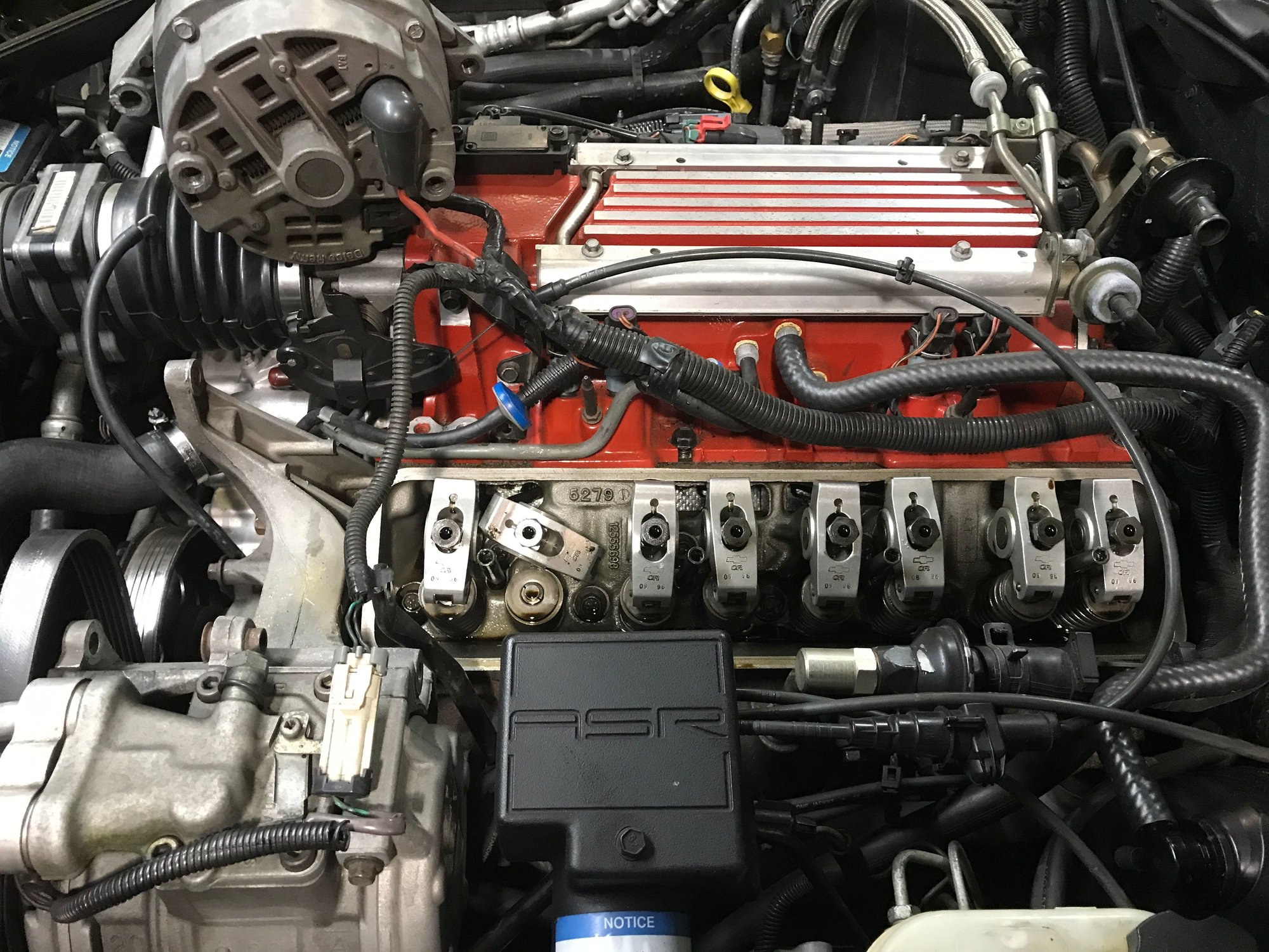

Hello all,
I got a 96 lt4 that's chucked a rocker. Been looking for a few days now for a replacement. The one that came in today is for the smaller stud. Can anybody help with a source?

look familiar?
as to your specific situation, assuming you want to go with stock rockers, Good F***in' Luck. While the oem rockers LOOK like anyother, they aren't; they are a one year only LT4 item that uses a 10 mm stud, and use a non adjustable pedestal mount; I had to replace two of them on my LT4 and at the time they were a dealer only item at $75 apiece; if you can even find them.
IMHO the "ears" that locate the rocker on the top of the valve stem simply aren't large enough.
if it's any help, the oem LT4 rocker arm part number is 12557779

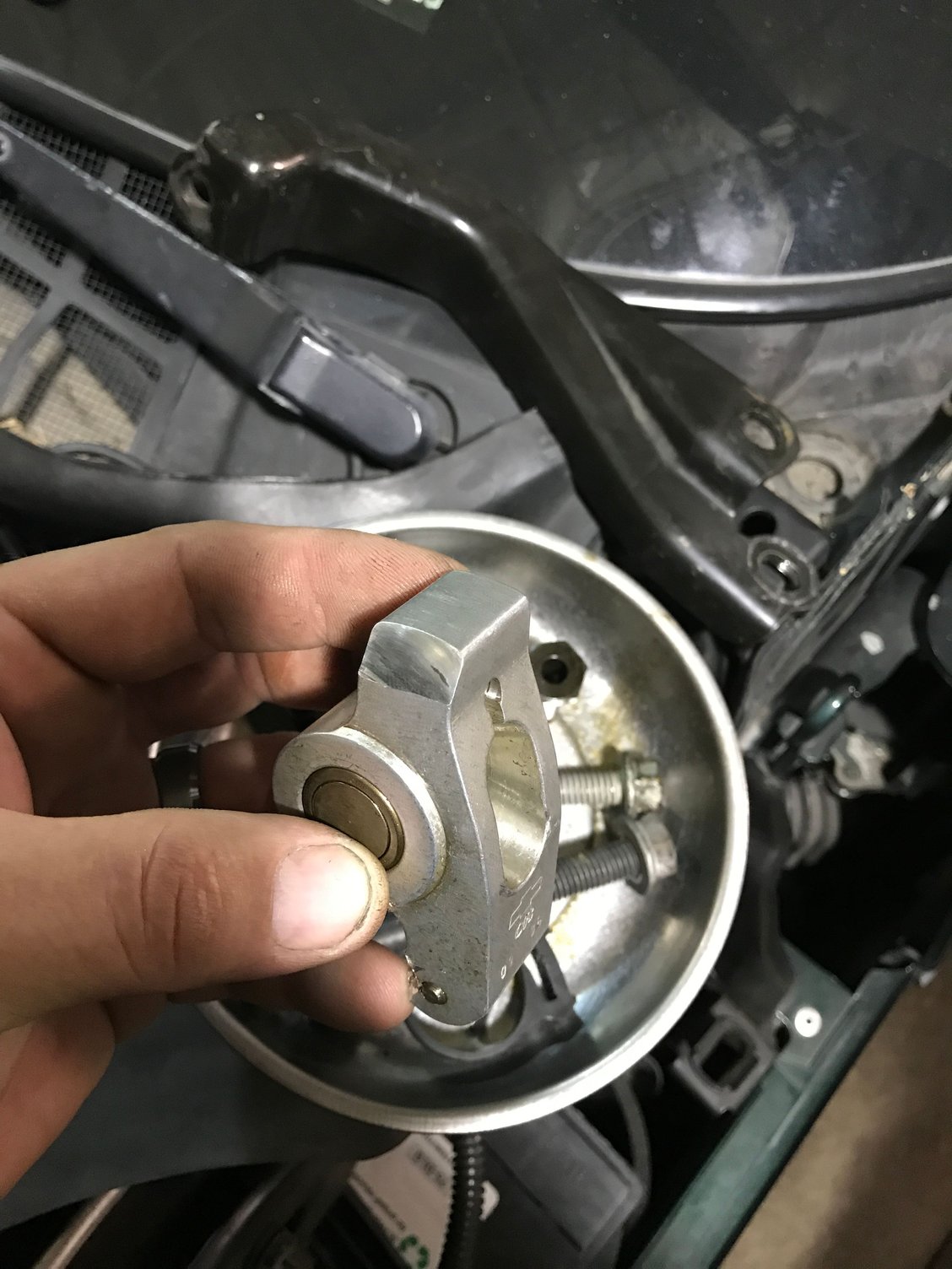

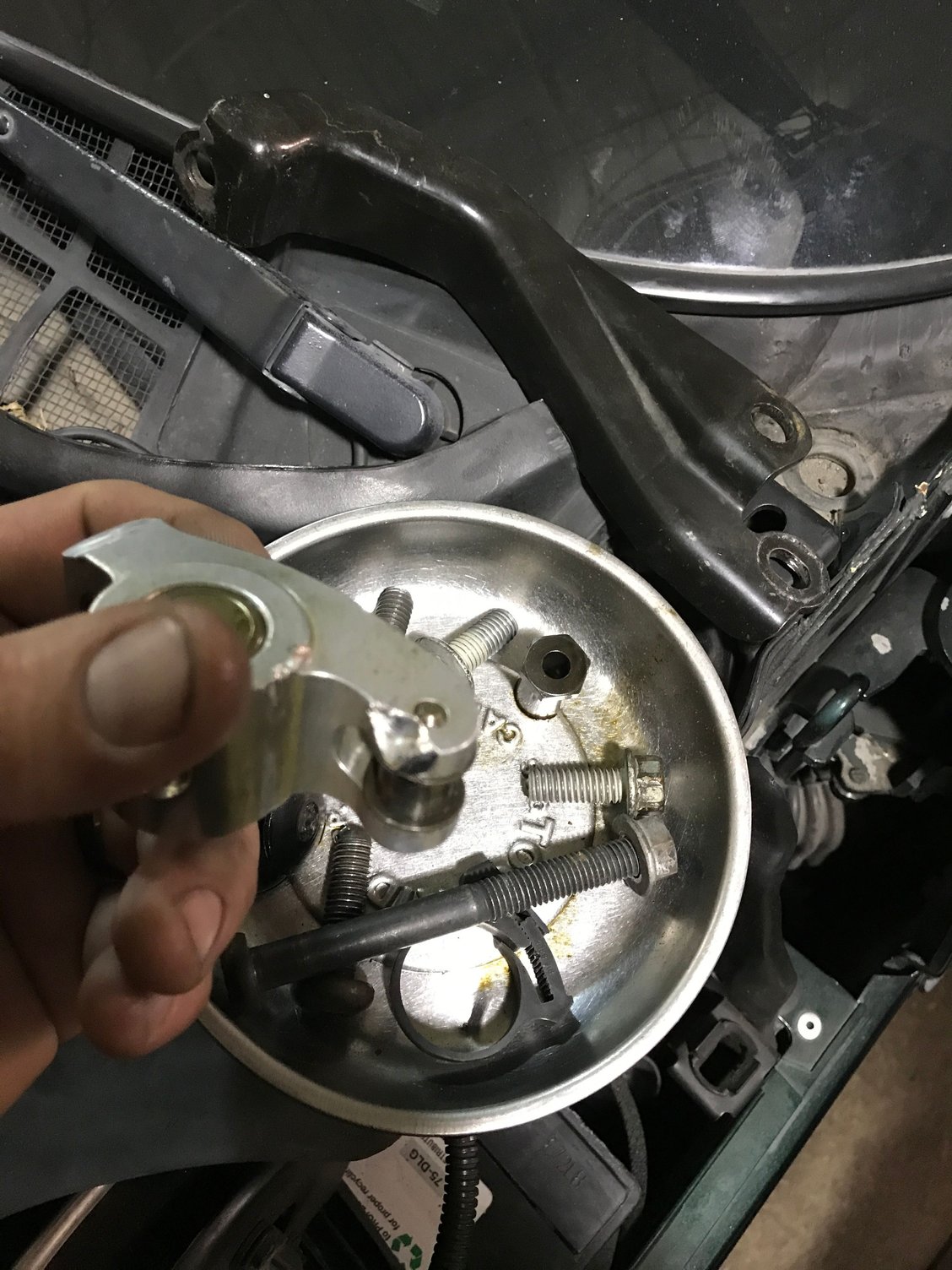

The rocker I'm hoping to make work is 19210725. Stud 12552126 with a locking nut, anybody got the part number for a nut?
Or maybe switching out the pivot to use the original stud.

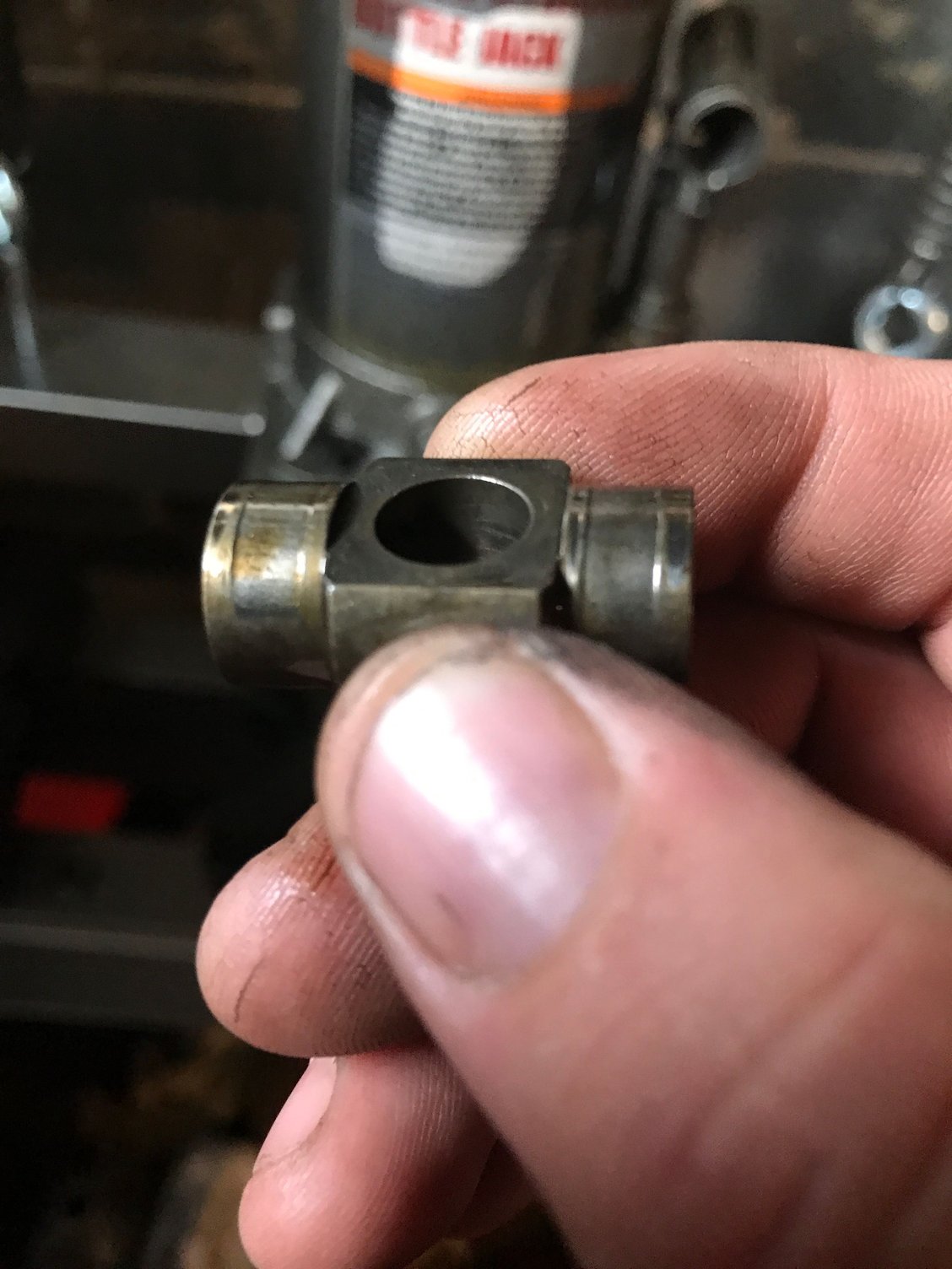

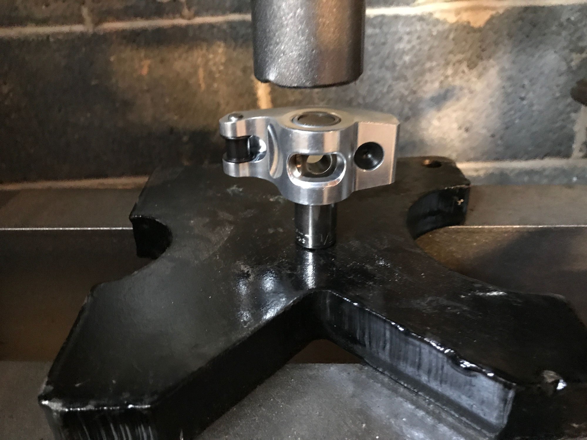

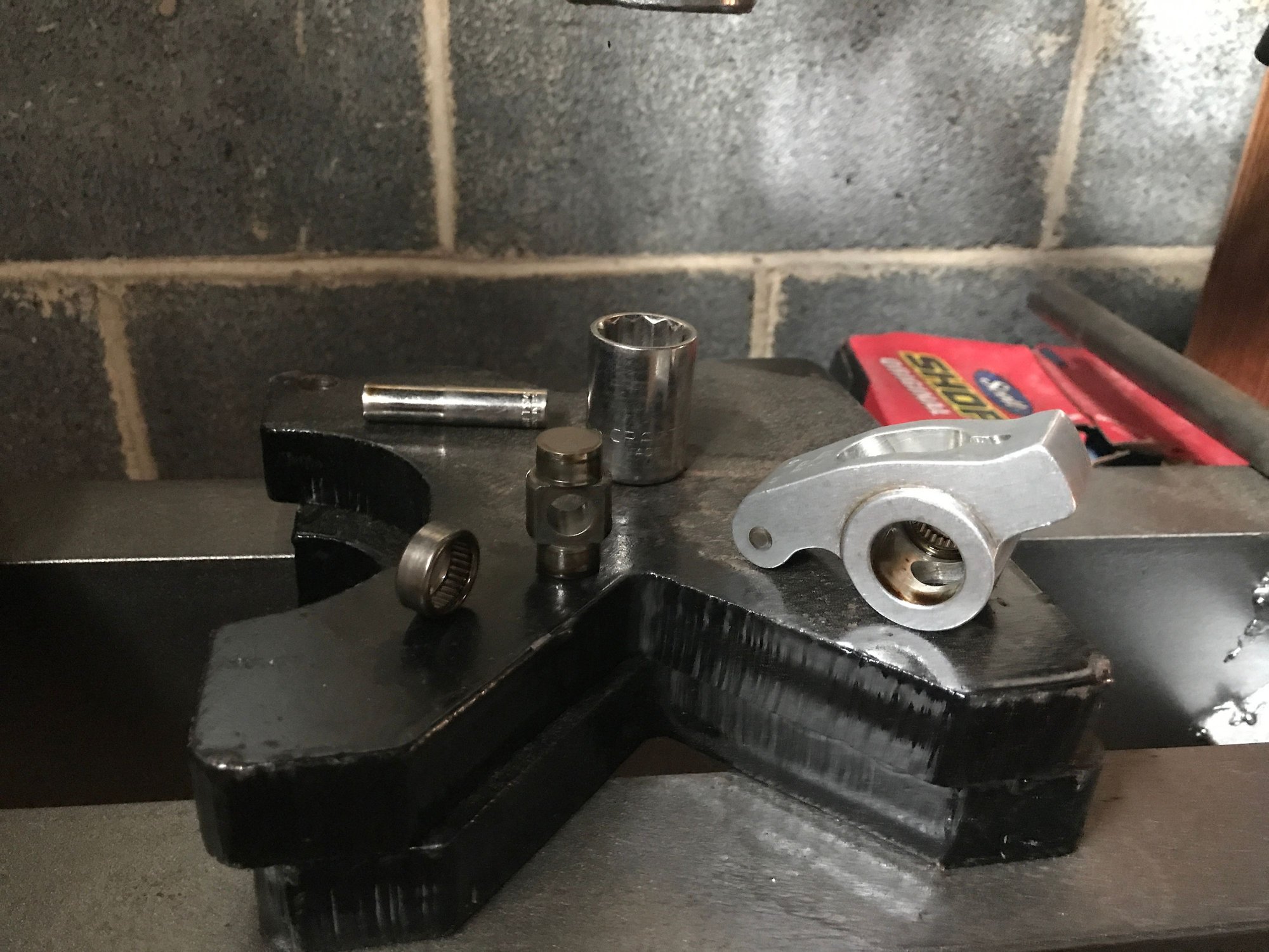

I appreciate all the help. I'm going to try and press the rocker guts to into my new one tomorrow. See how that goes and make a decision Monday what parts are going to go back in it. Now I have 3 options, assuming my press job is one of them. I wish I could tell you the whole story of this car or even knew it all myself, but I can't.

Went well and feels good, obviously worn but I'll flip the center over when I put it back on. Should be a decent fix.
