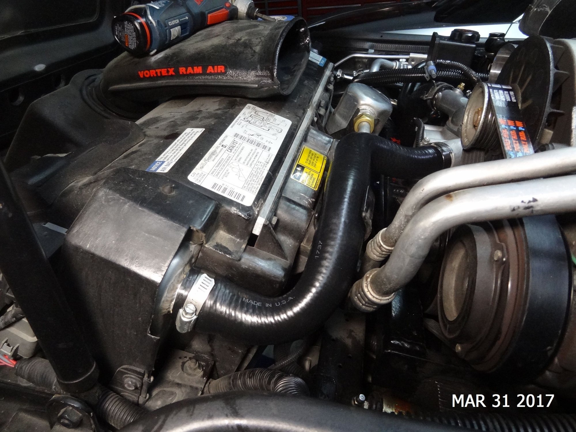

OP, my C4 (The Ghost) started as a project
It became a little monster with a 383, Elliot Portworks heads & cam and many other goodies. It has DeWitt's radiator, 8-coil LTCC upgrade, Petris opti, Smart-Radio, 3.54 gears, and many.
https://www.corvetteforum.com/forums...post1566645309
The Ghost has come a long-long way.
please vote for him for the c4 of the month

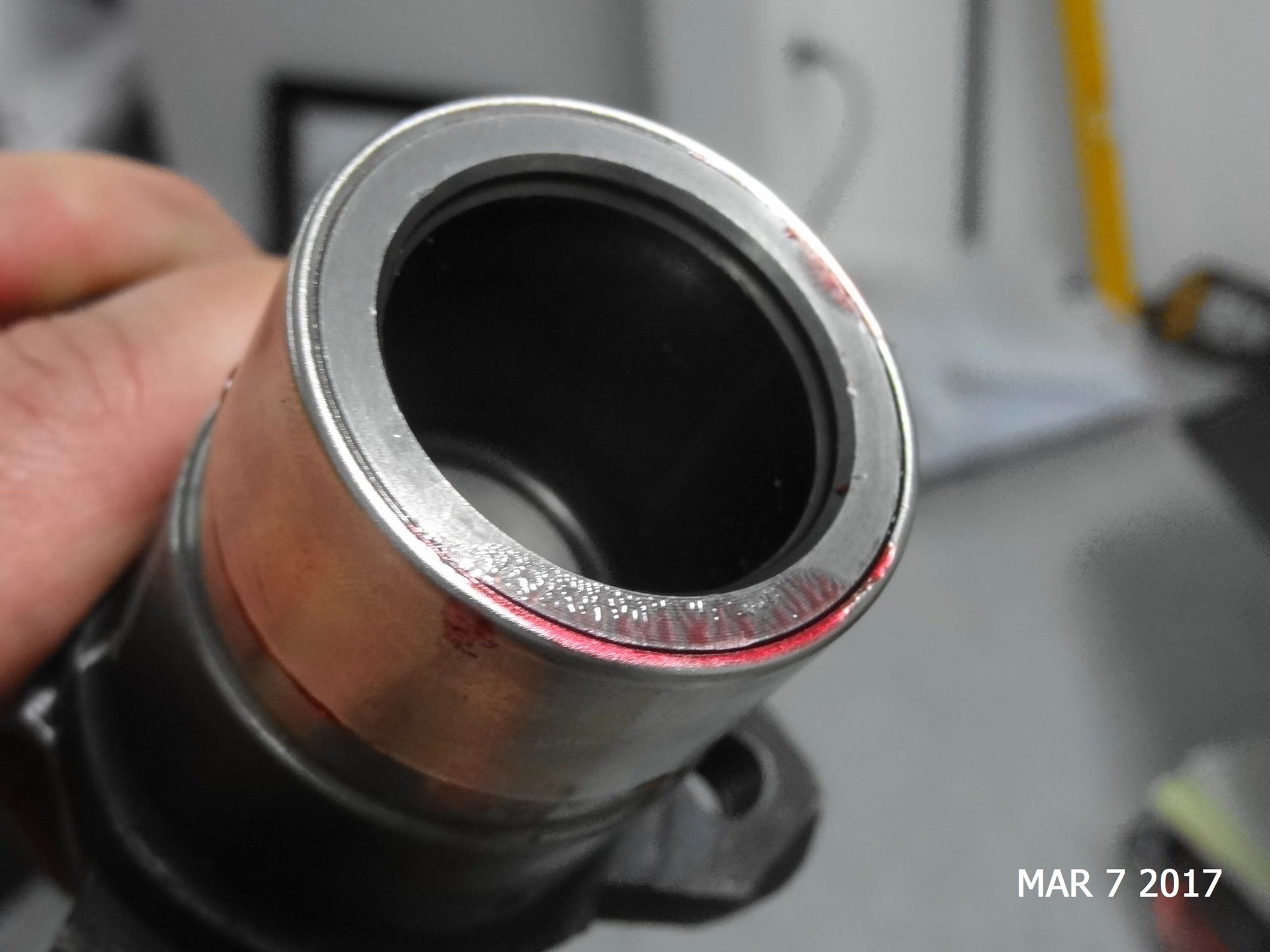

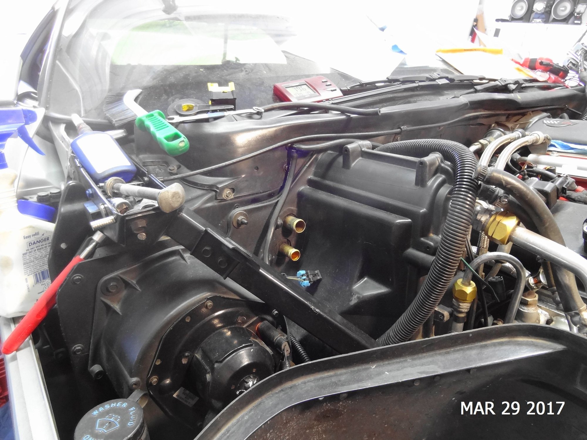

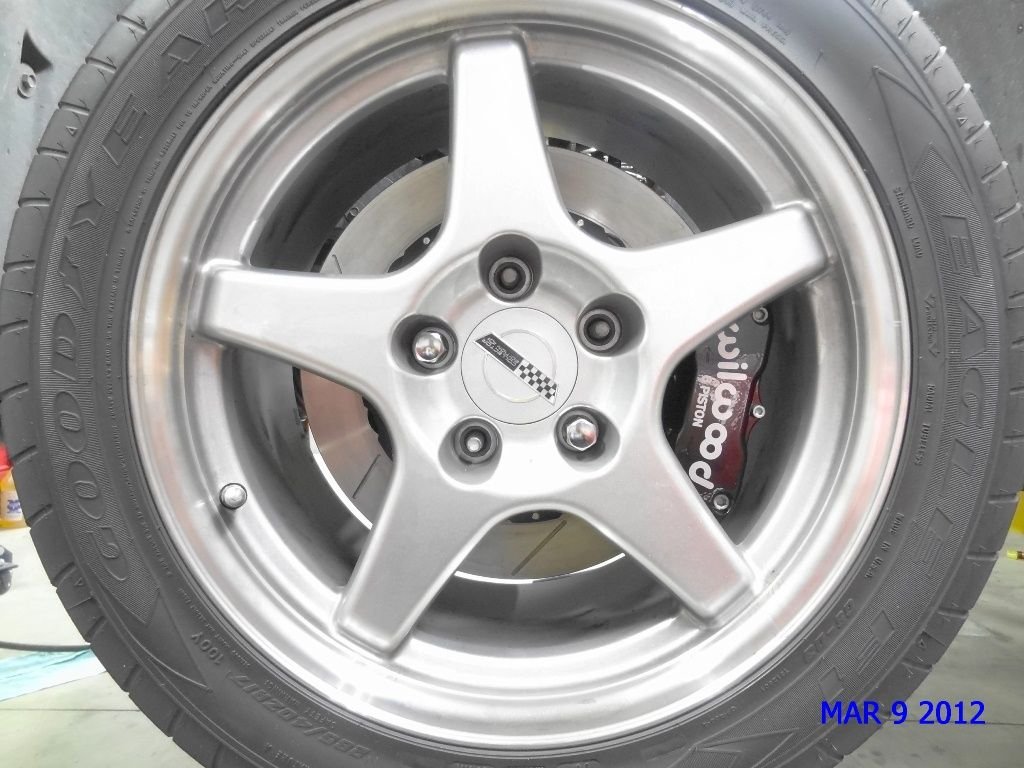

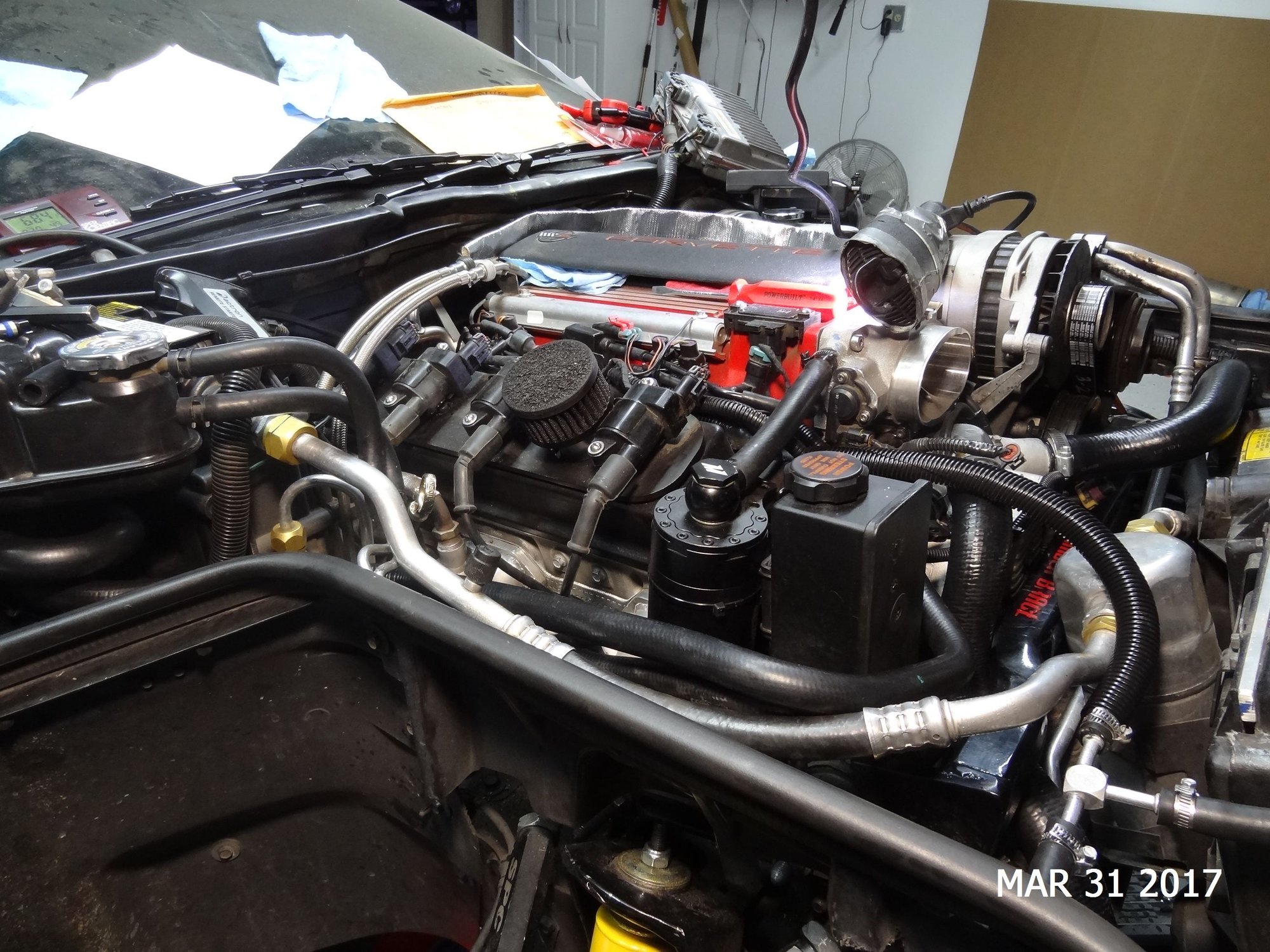

Few teasing photos to get you started
No, It Never Ends
