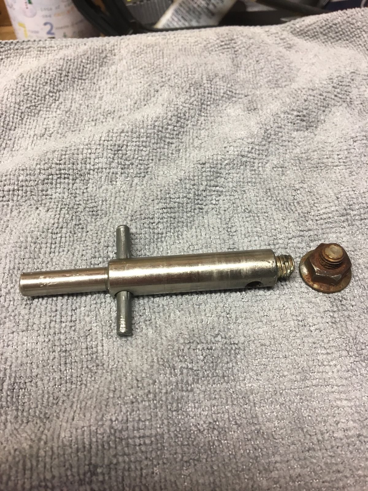

I have a 1985 corvette and i broke one of tge bolts when i was replacing the gears in my headlight. Does anyone know where i can get this bolt

Thats part of the actuator.
1. I think you are not going to find that part by itself
2. A junkyard may sell the whole headlight assembly
3. Remove the stud from nut, weld, tap, and reinstall.
I just installed new gears and bushings in mine. That part doesn't need a lot of torque, you went psycho on it.

My bad, It is an 85
Parts numbers: 16510052 and 16510051
There are few on ebay, be ready to pay or fix that bolt.
