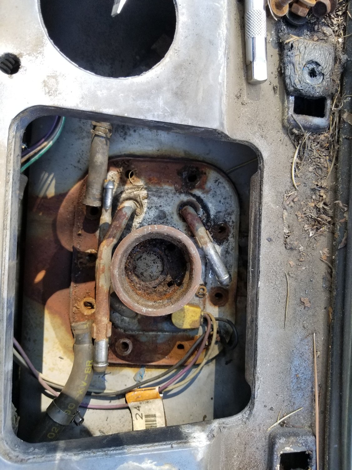

At this moment I know the car needs a fuel tank, pump, sender and inline filter that are all on order or already delivered.

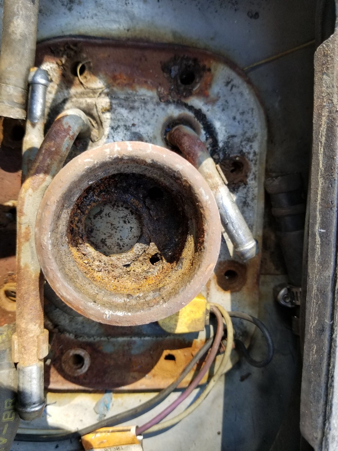

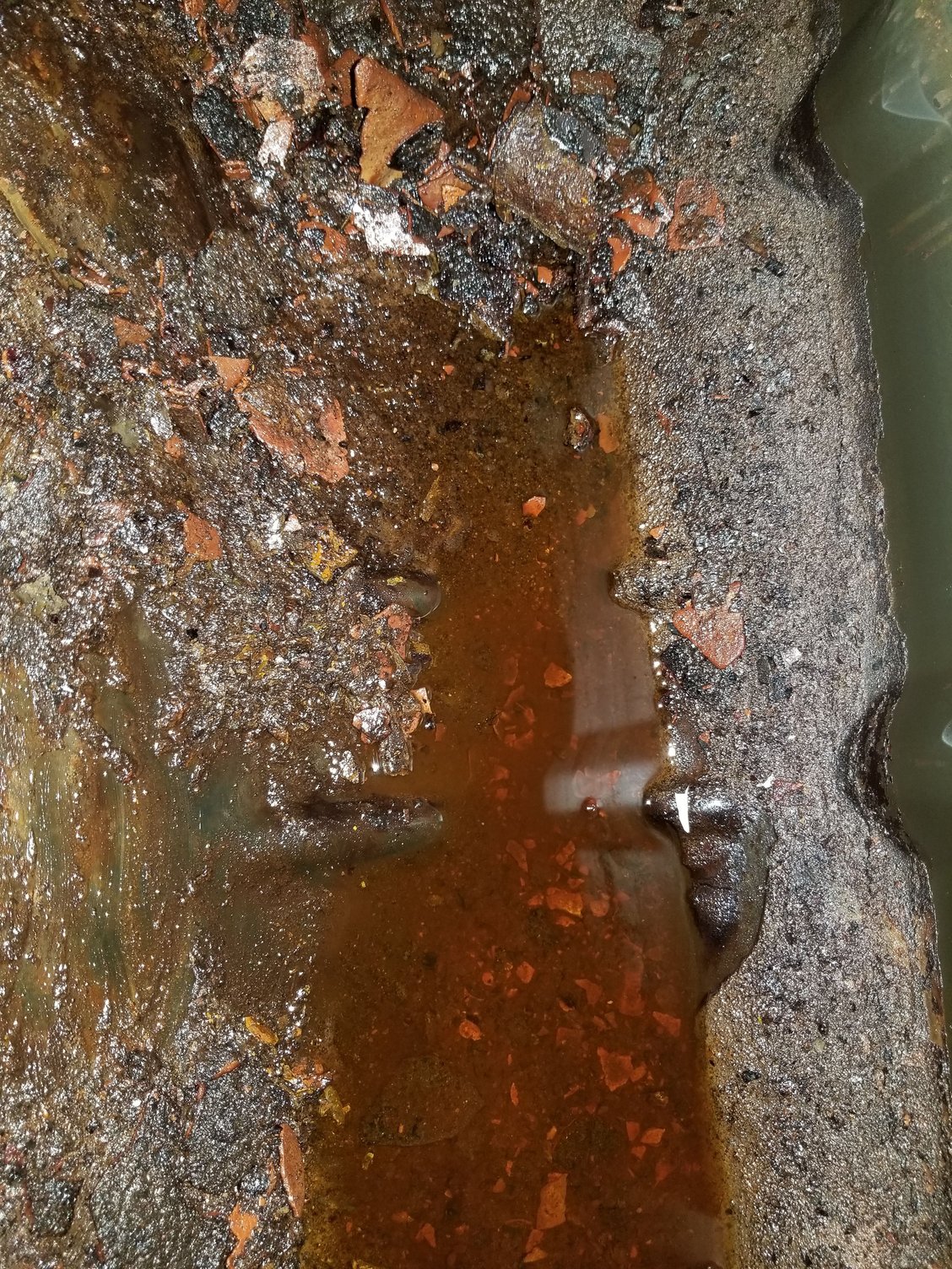

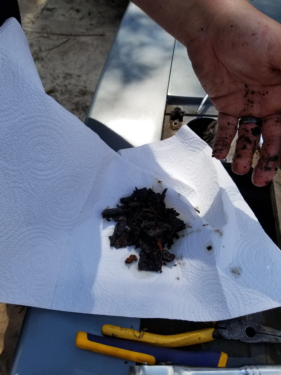

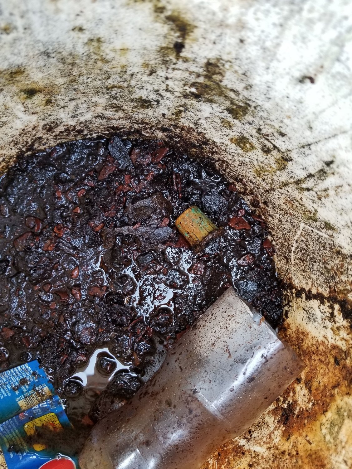

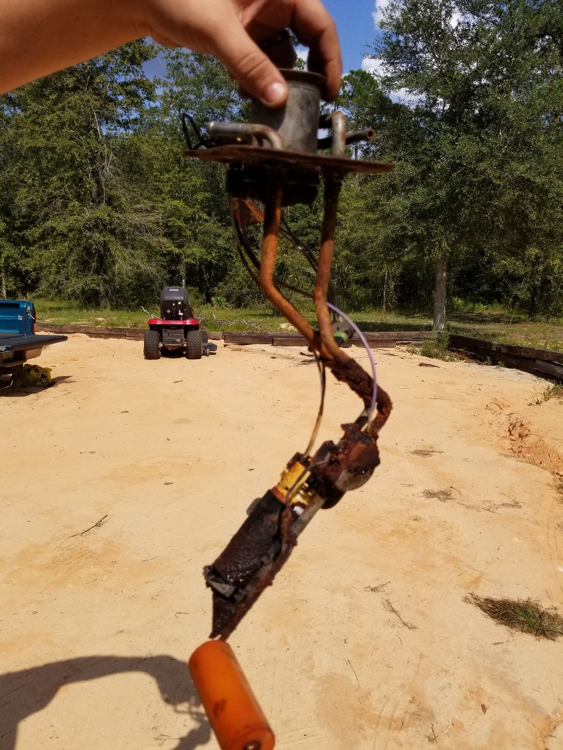

pologreen I would like to disagree about not killing a fuel system with old gas.
This is my second resurrection, first was a 1994 Firebird Formula and by not replacing the tank it almost cost me a rebuilt LT1. That car was let sit for 12 years before selling it and trust me it did not age well. This one was left outside without starting for 5-6 years and I am not taking any chances with it may be usable, If the liner held up and the tank i s still good great I can put it on Ebay otherwise I'm already prepared.
This is after I had to disassemble the locking fuel cap because it failed internally
Now I may be mistaken but that is not the color of a well maintained sender.
Tasty!!!
I learned a lot working on that LT1, fix it right the first time. Also the pump never responded to the key and that was my first clue I hat to open the tank
