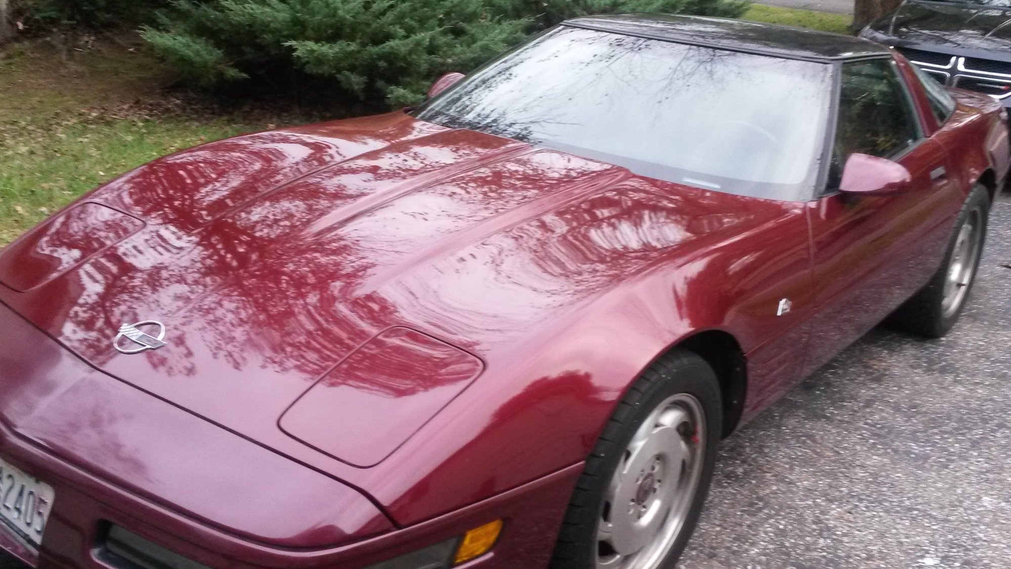

Nice looking car. I just turned mine over 60,000 miles. My dad was the second owner and inherited it.

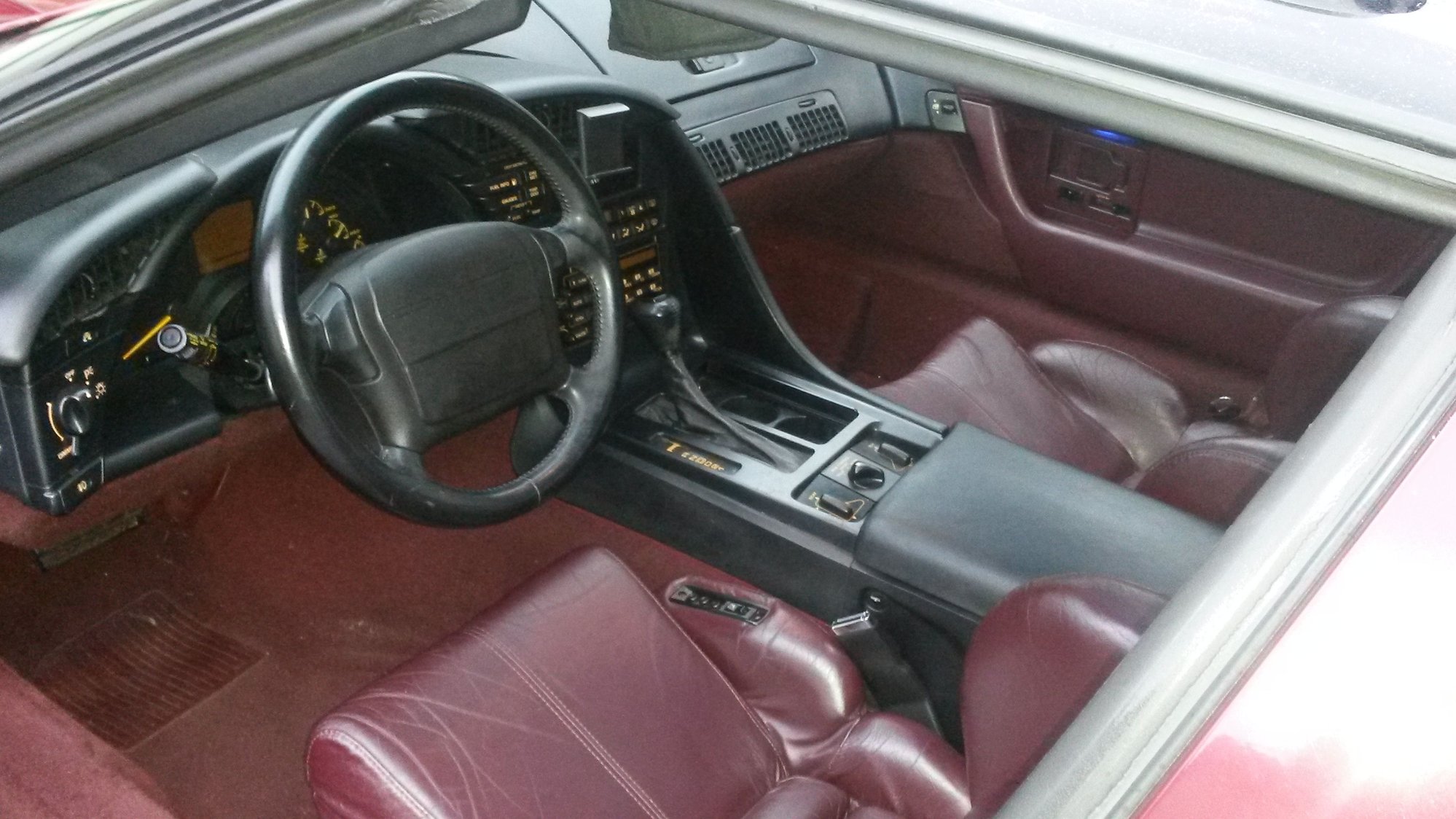

FYI, the speakers in back are easy to get to. It's 6 screws, I think, to pull the conver, and then four to pull the box. The amps (1 per speaker) are attached to the box. Replacement speakers are available and the Amps can be rebuilt or replaced, or perhaps sourced used. (The ones from certain Maximas and Infinities will fit as well, although their tuning is slightly different so I'm told to replace both sides at the same time.
I'm debating what I'm going to do as the driver's side rear is not working. (Process of elimination: swapped the passenger side box over and it worked. Swapped speakers and the driver's side work on the passenger's side.) I'm either going to replace the whole kit-n-kaboodle or just fix the amp and just replace the head unit. There look to be some drop in replacement touchscreen | Android head units for between one and two hundred dollars. I'm not in a hurry though.
