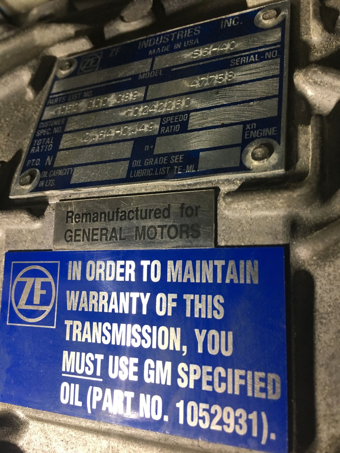

I ended up taking the cat off , it was nfg. The passenger side was starting to make a little noise too.
here is the link to video
https://www.youtube.com/watch?v=623y...ature=youtu.be
While I was under the car I noticed a reman tag on the trans,is this something I should be concerned with?
I wouldn't be....

Originally Posted by QCVette
...While I was under the car I noticed a reman tag on the trans,is this something I should be concerned with?...
The part number 1052 000 0089 indicates it is the correct transmission for a '95 or '96.
I am a little surprised to see a rebuilt tag for a car that only has 20k miles. I had a '94 that had those extra tags, but mine had about 100k on it when I bought it. It worked fine for me for about 50k miles until I sold the car, so I wouldn't be concerned with it either.
I am a little surprised to see a rebuilt tag for a car that only has 20k miles..
Probably the original owner was a crybaby whiner and the dealer replaced it under the factory warranty for a noise complaint.

The rebuild tags say ZF everywhere so you are golden. Also, that transmission case looks brand new, clean enough to eat off. Wish mine looked like that.
