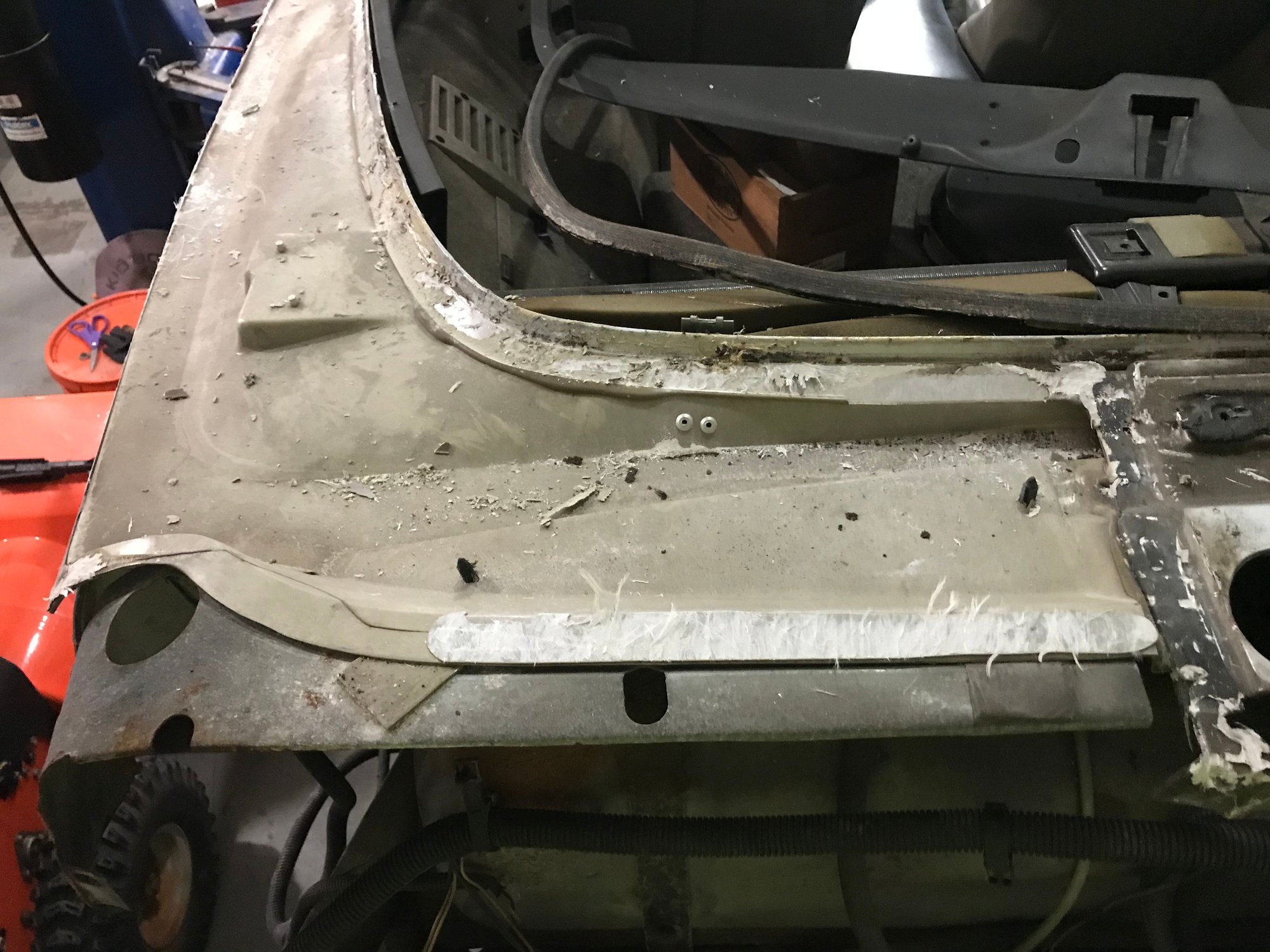

I have officially started the process of removing and installing the
rear quarter panel. I will continue to post pictures until the project is done. I put my heat gun to work and was able to pull most of the fender off by hand.
