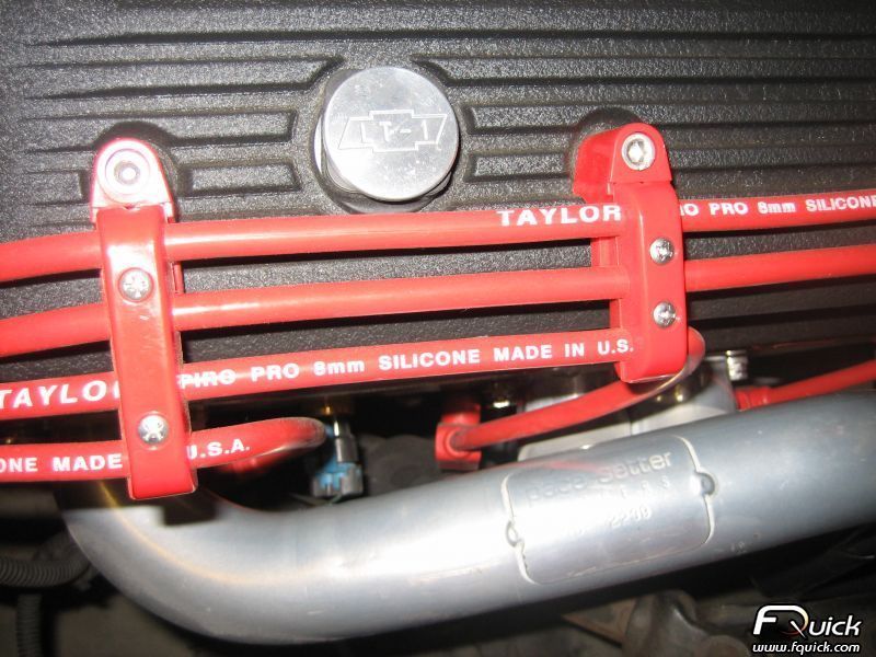

I replaced the manifolds in my car with the Pace Setter shorty headers this past weekend. Oh what a joy that was. The drivers side wires worked out alright, not that you can really see them anyway. But the passengers side is a mess no matter what I do. It's functional just sloppy. Are there any aftermarket looms that work with our cars?
I found this picture which I believe is an LT1 Camaro. Happens to be same headers/plug wires I'm using. The looms bolt to the valve covers, which I don't think I can do with stock valve covers on the Corvette.

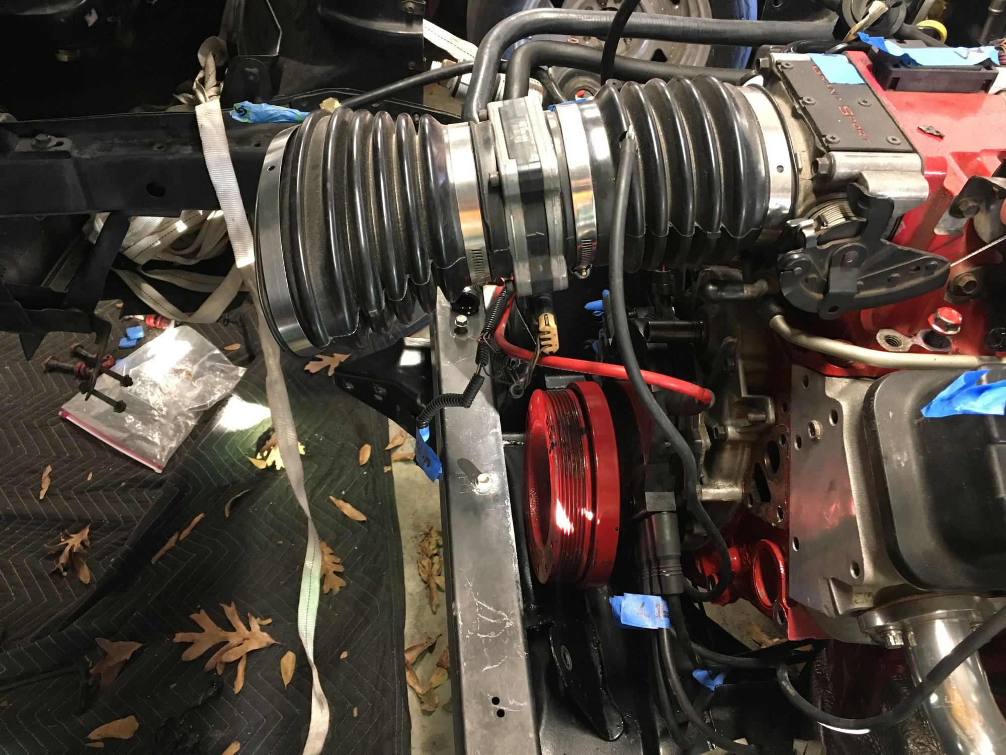

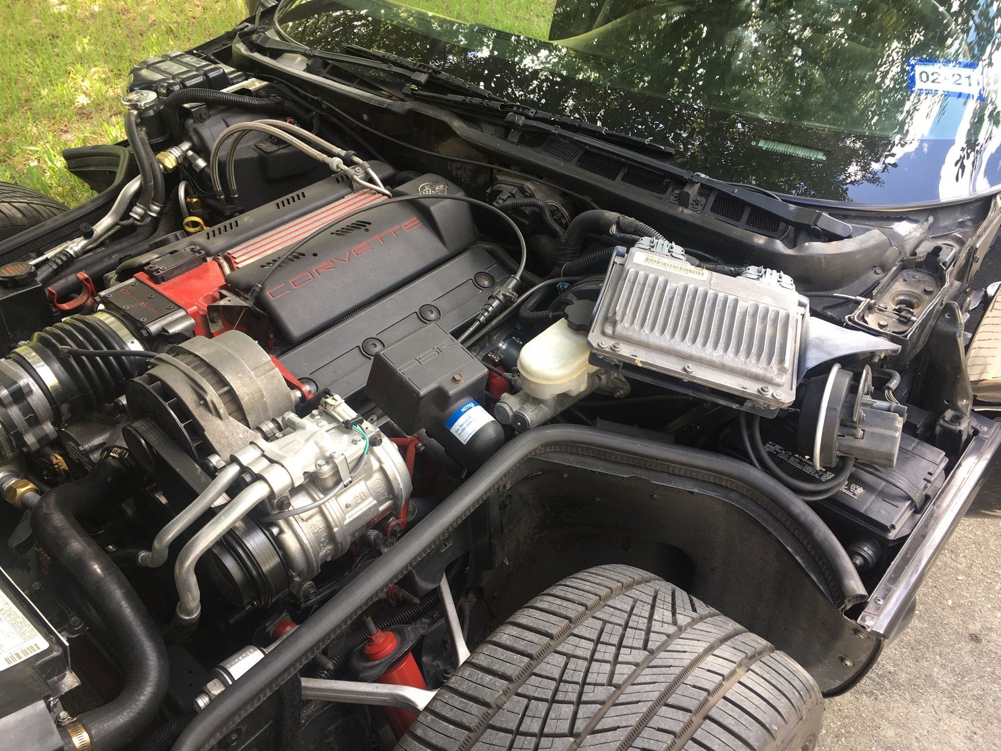

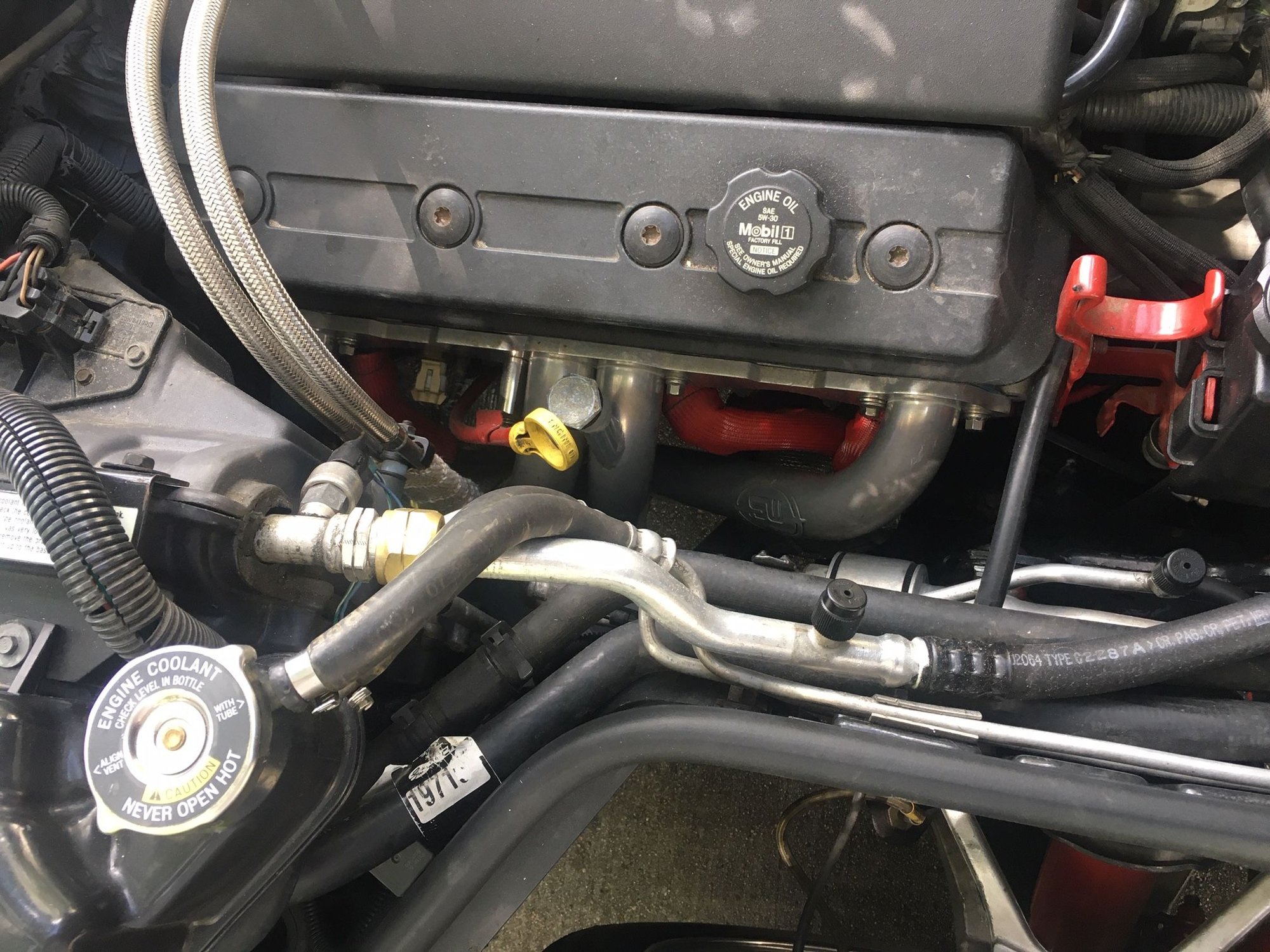

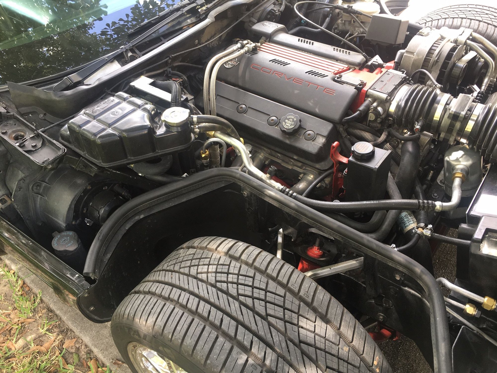

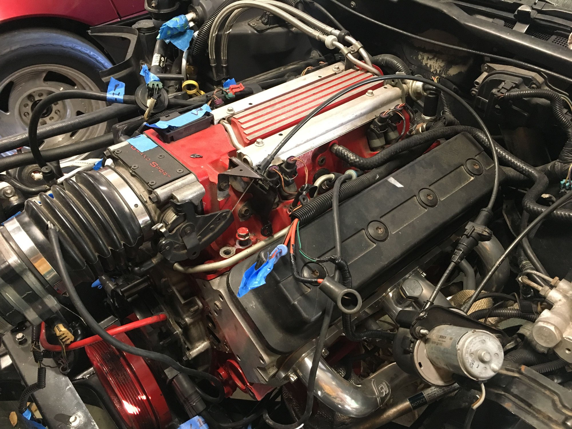

what i did was to run the wires from the opti spark along the block and the front 2 cylinders on each side came up thru the motor mounts. the rear wires i continued along the block, secured them with a clamp bolted into a threaded hole on the block and up to the plugs. i also used a set of camaro z28 wires as all 8 wires have a 90* boot.
