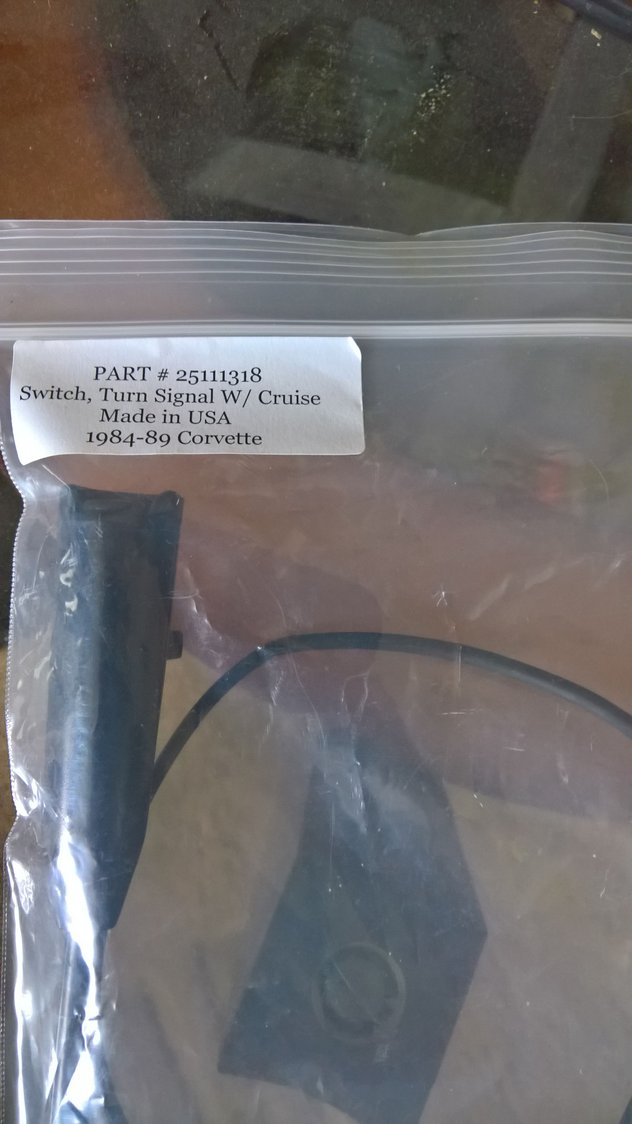

Originally Posted by TBSS/85vette
I had to replace the stalk, the switch was bad in it.
Where did you find a replacement stalk? I've got the same problem but the only part I can find is one used on eBay (89 Coupe).

eBay $89
To No Cruise Control
