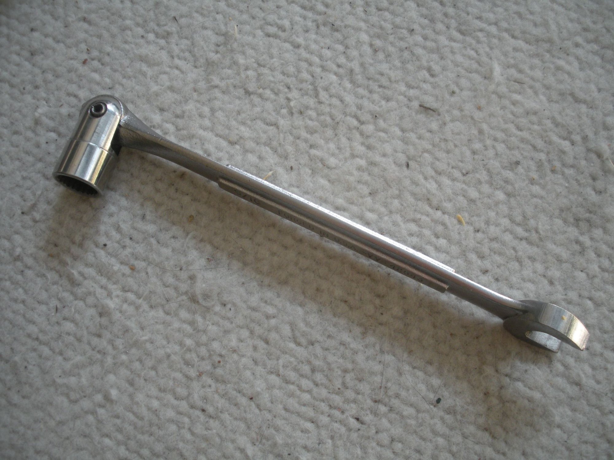

I don't remember any problem with disconnecting the fuel lines. They don't need to be removed, just disconnected from the throttle bodies and moved out of the way. Same with the a/c compressor, just move it aside. Don't disconnect it. The hood can stay on. There are a few wiring clips on the top of the trans that are hard to reach, but they were only useful to hold the wiring in place when they dropped the body onto the chassis at the factory. They are no longer required.
I don't see any reason to remove the trans. The bell housing bolts are a bit tight to get to. Here's my favorite tool: A 9/16 swivel socket.

I removed the engine from my 84 and left the auto transmission in the car. The fuel lines are rubber fuel hose and can be unhooked easily from below as Tom stated.
I used a 9/16 swivel socket and a long extension to remove the bell housing bolts from below. This is the easiest way I have found to remove those bolts.
