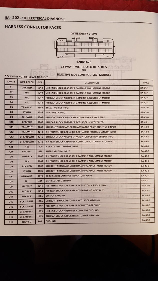

Why? Could you not have run one more wire to the CCM? Since you were already so far into it?
There is absolutely no need to run any wire to the CCM to add FX3 to a car. It doesn't need it, it doesn't have a cavity for it. It doesn't exist.

So the input is only the VSS and whatever the actuators say? My Section 8A is at my friend's house so I can't verify without a trip
Correct, VSS is it.

Do you know what the CCM is all about? IOW what inputs does it get and what does it need? Like I said, "Borrowed" FSM away. Should have sold it since it is there more than it is here.
From 93 service manual so you'll stop shitting all over this thread with your non-helpful responses:
93 Selective Ride Control Connector Signals

You mentioned the CCM so I was curious. Sorry if you don't like my thought on the FX3 when I said IMO, it wasn't worth it. Perhaps you can tell me the "party line" and I'll try work it in.
