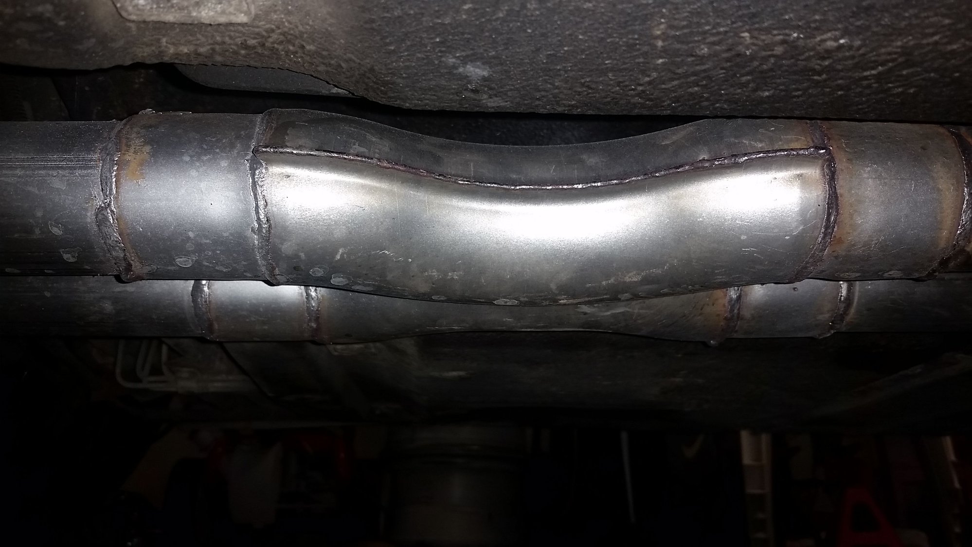

I brought my 88 to a local muffler shop and had them fabricate everything. I believe the only thing they had to outsource was the x pipe and the mufflers. Not sure exactly what size the pipes are but if I was to guess maybe 2 1/2". Hard to get good pictures since I don't have a lift. System is totally welded so no problem with leaks or clamps loosening.
X Pipe back to mufflers
Walker Quiet Flows with chrome tips
X Pipe
X Pipe to manifold
