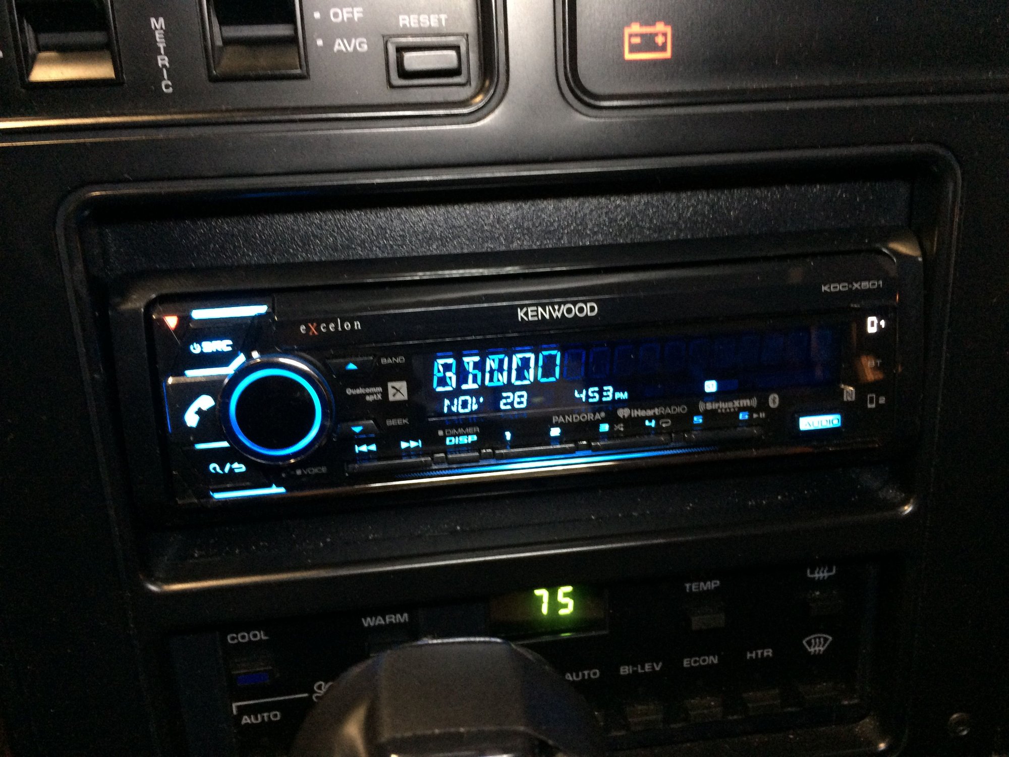

I agree. I set my bose stuff aside as it failed. Kenwood Excelon head unit. Rockford Fosgate 6x9 rears. Pioneers fronts. I did not cut any harnesses! I ran new wires and kept the original harness intact. I also ran a dedicated ground wire from the frame into the car as it eliminates any feedback or ignition noise. I also removed and set aside my power antenna. Disconnected the relay (important to avoid parasitic 12Volt drain) and replaced the power unit with a fixed height 31" black antenna. The antenna shaft is removable too! BIG upgrade in sound and reception. IF and WHEN I sell my car, I can provide the original Bose components and Antenna.
