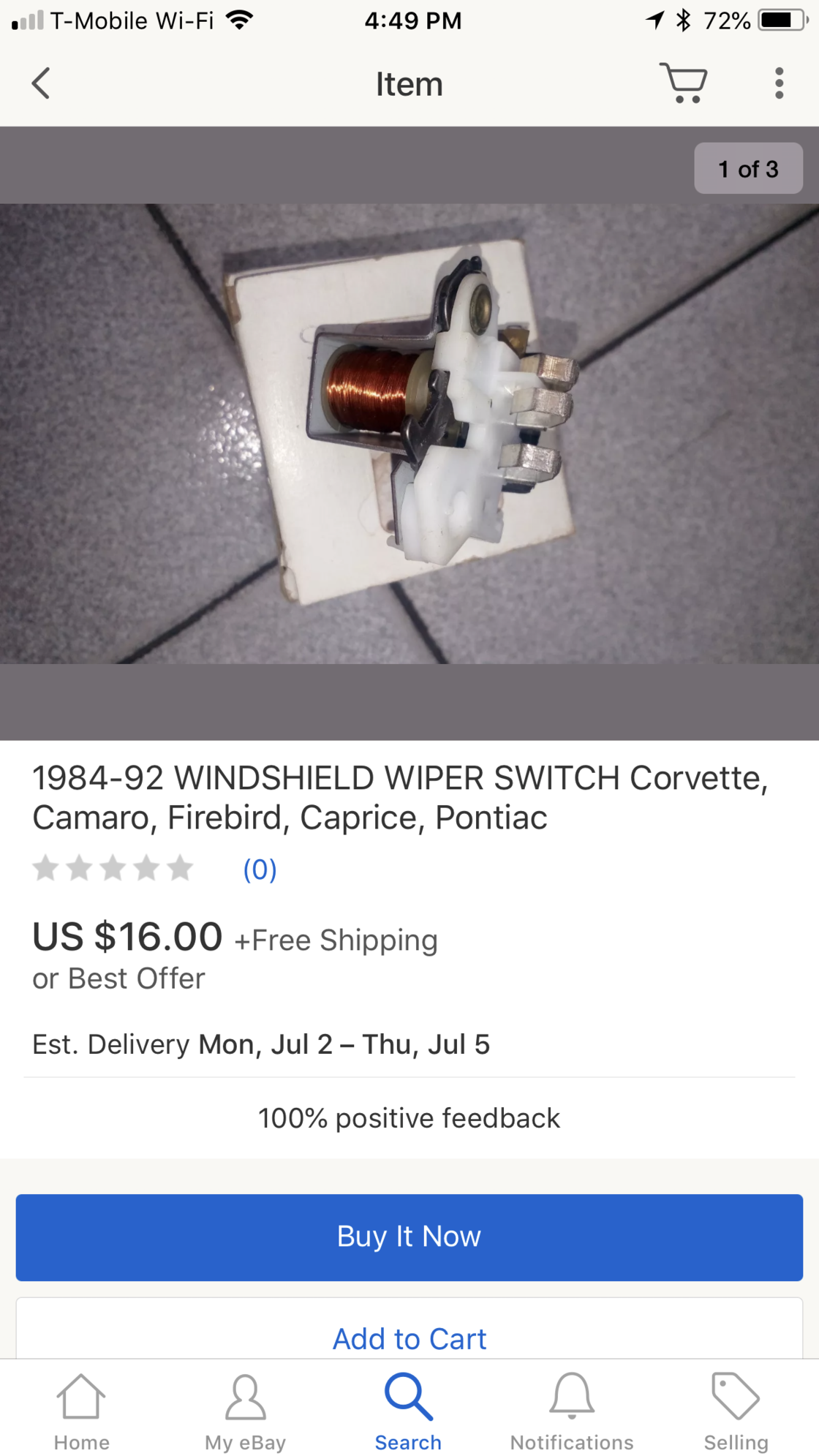

Old Jun 26, 2018 | 04:44 PM
Gunho's Avatar
Gunho
Joined: Feb 2015
Posts: 265
Likes: 19
From: Tampa FL
I’m guessing the park switch was removed in this photo?
Old Jun 26, 2018 | 04:49 PM
Gunho's Avatar
Gunho
Joined: Feb 2015
Posts: 265
Likes: 19
From: Tampa FL
Got it now. It is in the photo, with the tabs removed. It’s a cheap part so I’ll go from there. Thanks again!
Old Jun 26, 2018 | 04:54 PM
Kevova's Avatar
Kevova
Posts: 6,192
Likes: 750
The tan thing with the blue bolt is park switch. There is a metal tab on the cover. It has a hole for a bolt through it. That is the ground for the module, bolt should be about a 1/2" long.
