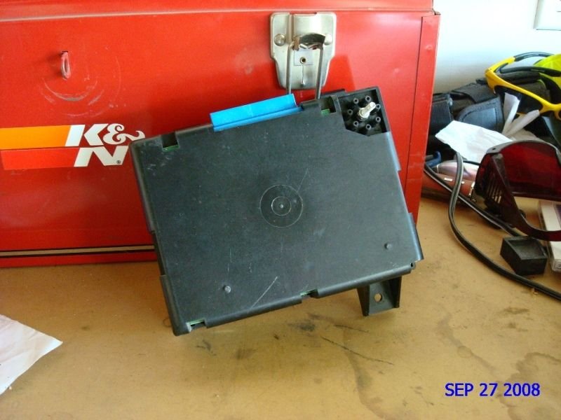

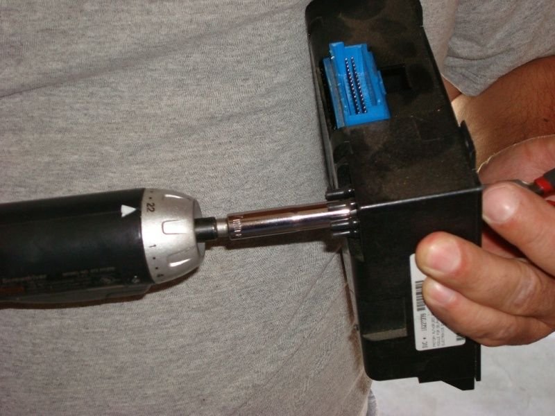

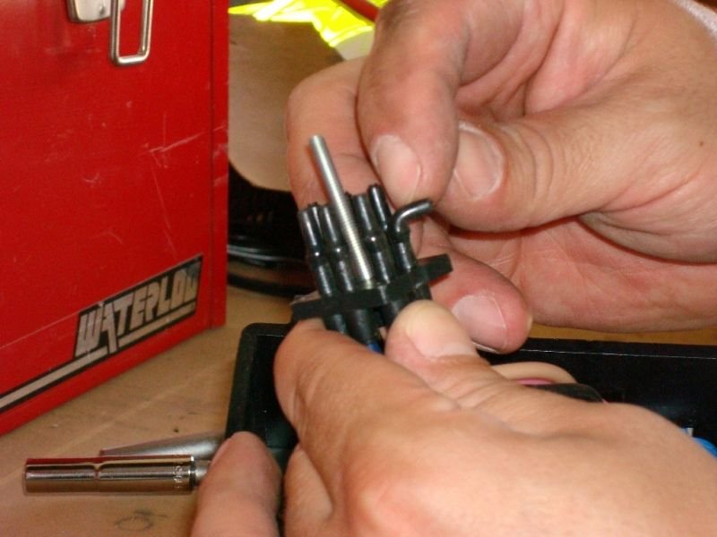

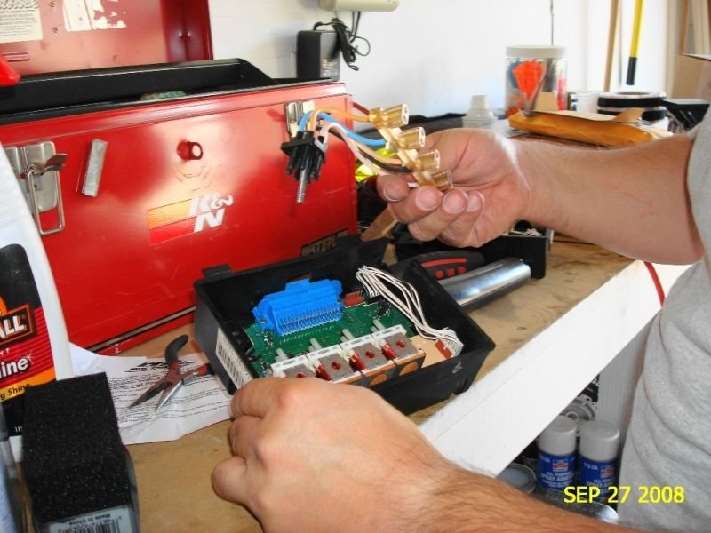

Originally Posted by PLRX
PLRX....Not seeing those images that were posted... ..what are they of?
To HVAC programmer module
