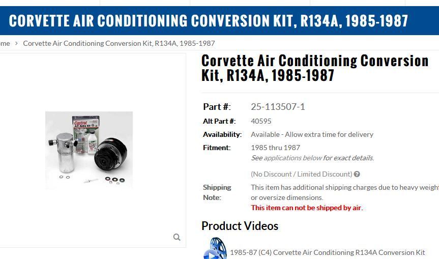

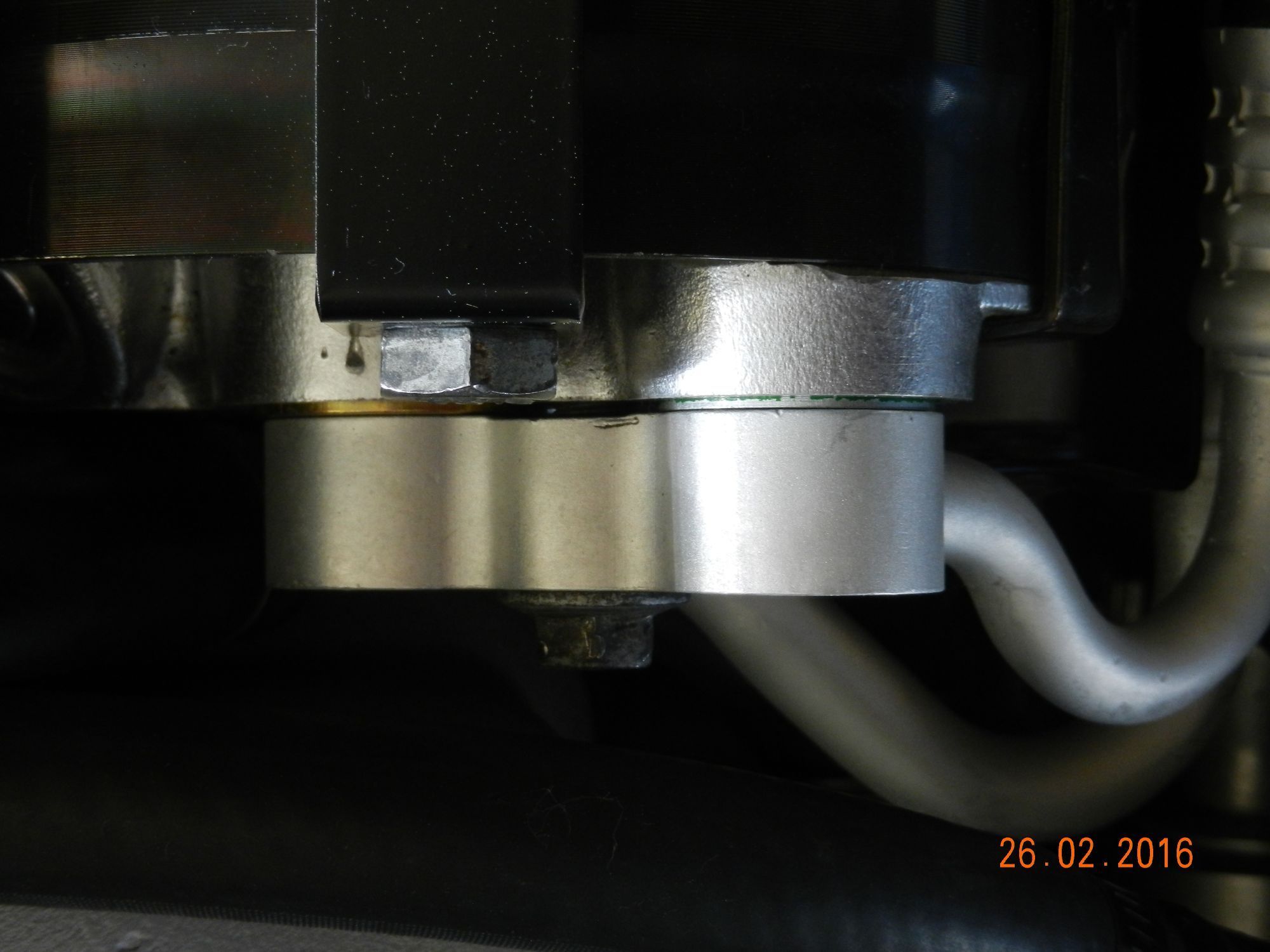

I bought the kit from corvette central,
The kit came with 3 washers and you will use 2 of them like this
And the silver things go in also but I forget so remember what is under the gaskets. Good Luck
