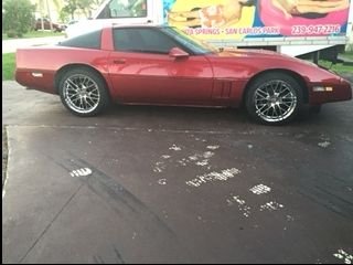

get some 18" rims...I run 275/35/18....could probably do 300....low profile...looks wide....still can burn em....
What width are your rims? I'm running 255/40R18 on my 18x9.5. According to various tire calculators, these are supposed to have the same diameter and revs per mile as 255/50/R16. Unfortunately, already caught my tires, Nitto INVOs being 2 MPH slow, turns out they were "targeted" for 9" rims, even though they were listed as fine for 9"-10" (or more, I forget). Still, 2 MPG ain't much.
Are those from OE? What width are they?
rims are 9.5 running 275/35/18...according to my wife's app on her cell phone (she tracks me to make sure I'm not speeding) looking for a passenger eject seat now ......anyway, it's right on with the gps speed.....
