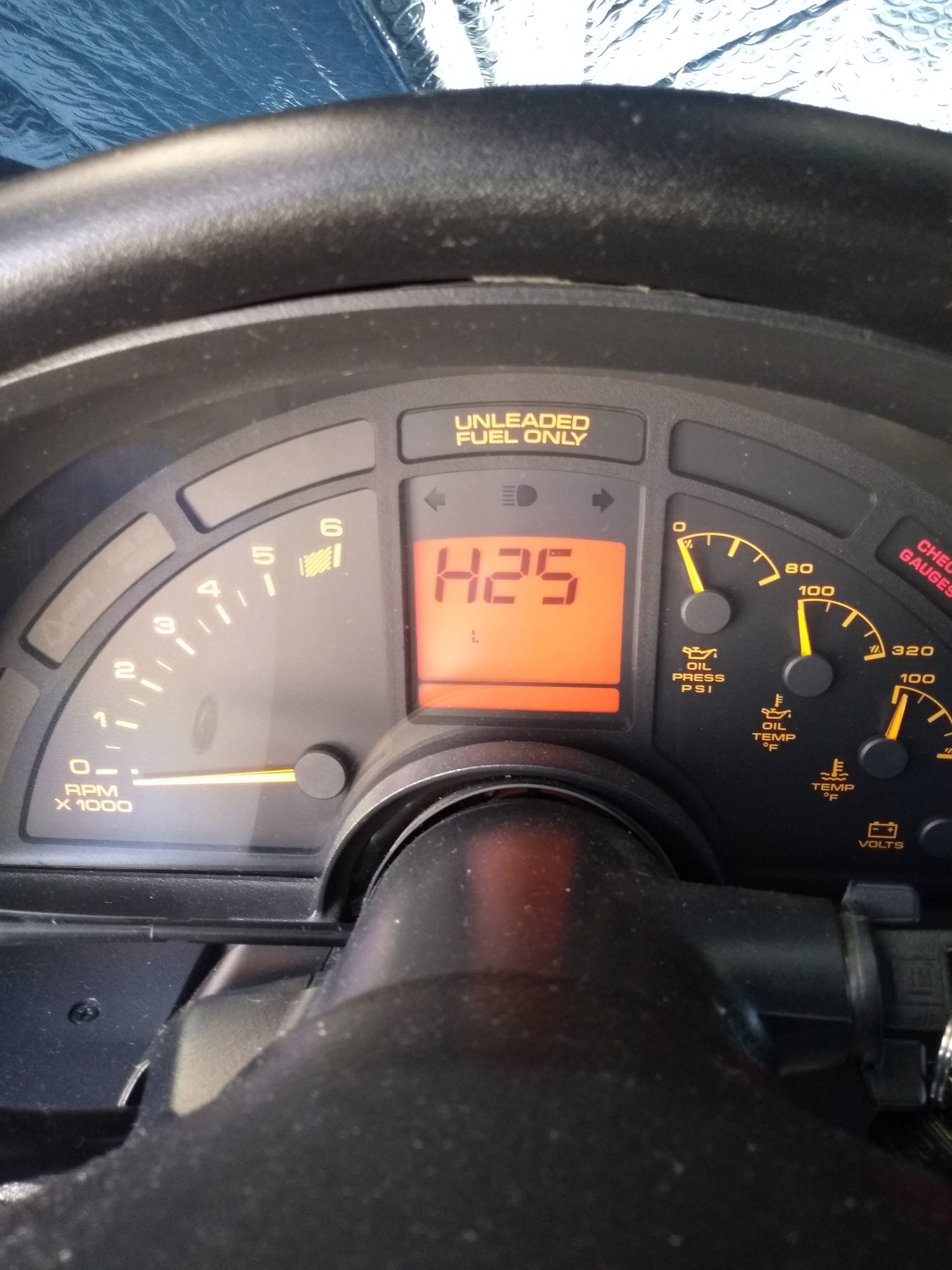

Managed to pull codes in my 92 coupe.
Got the following
Module 1 c25 and h25
module 9 simply reads "err"
What does any of this mean and where do I get more info? I seerched for Corvette codes but understood very little of what came up.

Yes I have read that . My car has been running like **** when the engine temps are north of 210 and you try and drive it like a Corvette. Driving hard on a lower temp engine is fine, and it can be driven gently when the temps are high. But the second you try and drive hard it's hesitating and throwing you in your seat. Twice it's actually died in motion when the temps were high and I floored it from a dead stop.
Thought it might be trans related. Took it back to the shop that built my trans and he experienced the problem as well but said it was not from the transmission.
Module 9 is related to the ASR system apparently. From what I've read the Err means the main computer and the ASR computer aren't working with one another. Could this be the cause of my issues? And what can I do about the Err?

I get a ERR in 4.1 . I hate trying to track down electrical problems even when you have a fsm to follow!
