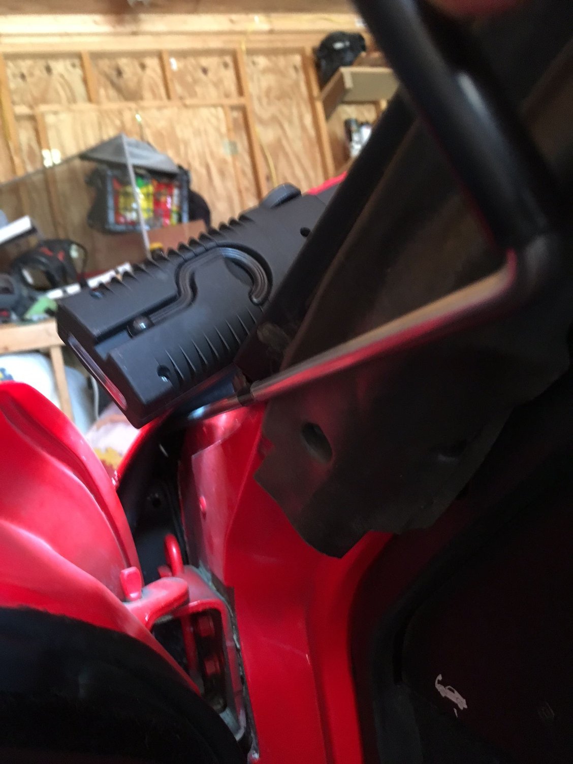

It takes a little skill. Make sure you've got that tape marker lined up correctly with the corner of the window.
Drivers side was relatively easy on mine, though there may be subtle differences on my '96 from your '87
If you can get past the weird angle, you'll see where the tape aligns in this shot. Also note the angle of the handle in upper right.
. I had to cut 1/4" off the end of the tool to get the passenger side.
Don't give up! If I can do it anyone can.

Thanx 4encouragement-Turns out a large stiff rubber seal plug, in front of the hood latch, blocked the tool from doing its job. So had to remove cover around the release lever to access both bare cables, then pushing up on cables while pulling release lever popped the hood. Real problem seems2B older stretched-out cables, which I'll be replacing. Tightened the adjusters, which will correct my problem until cable order arrives. Thanx again 4 ultra-helpful photo.

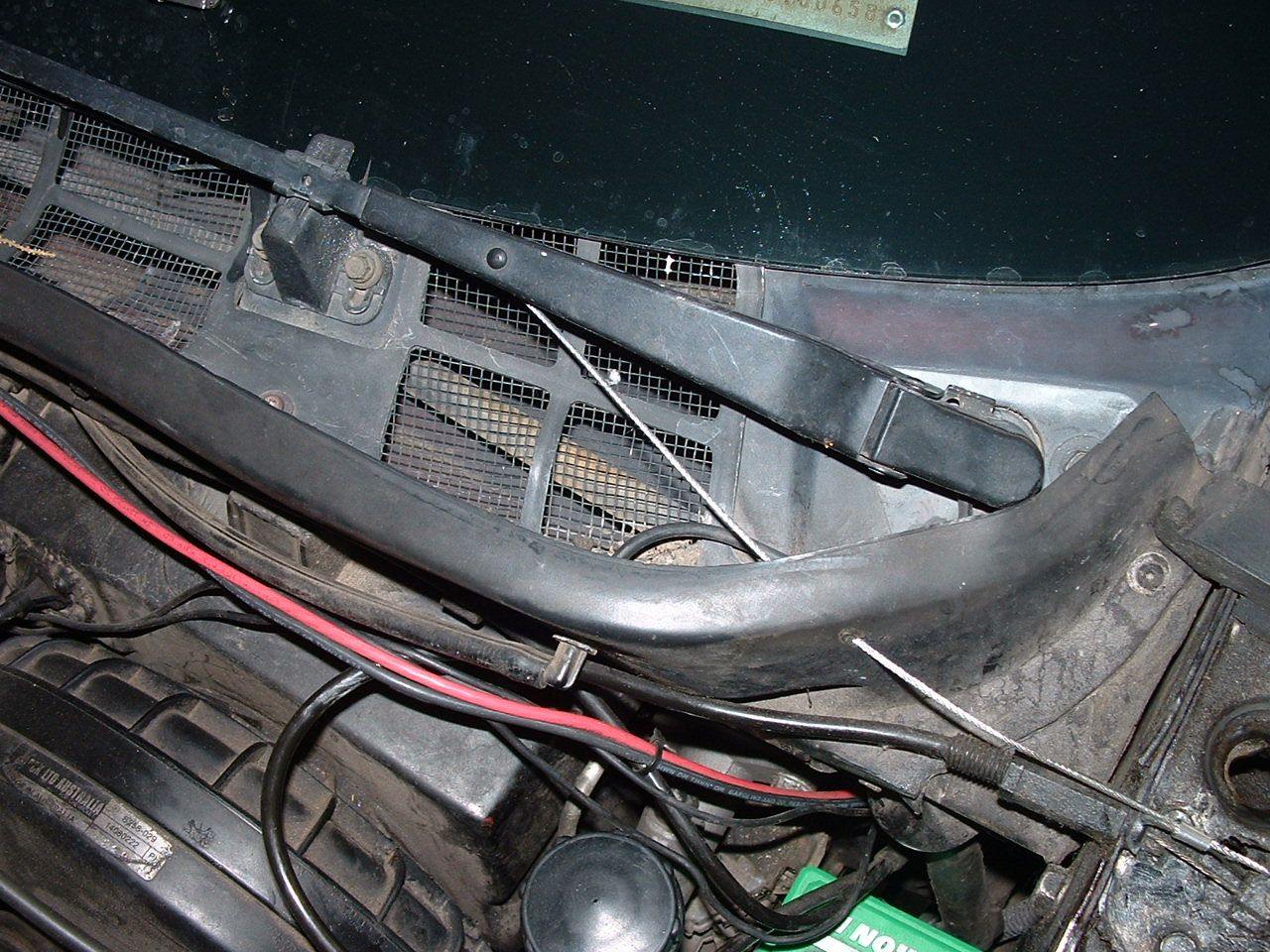

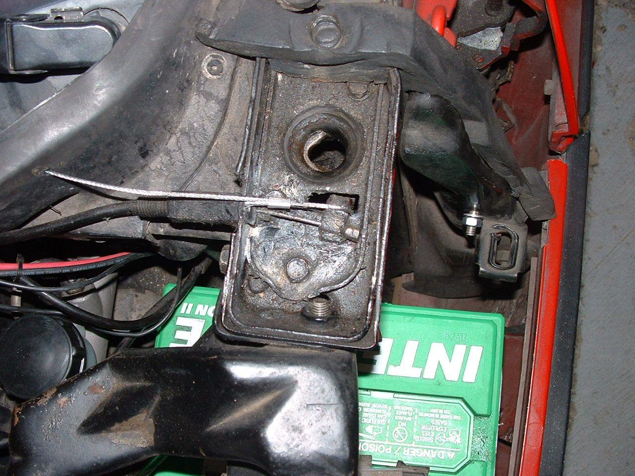

I use fish leaders for both of my cars since not being able to open the hood is a bummer especially when you've driven to a show. For the '88 it's two of them connected together.

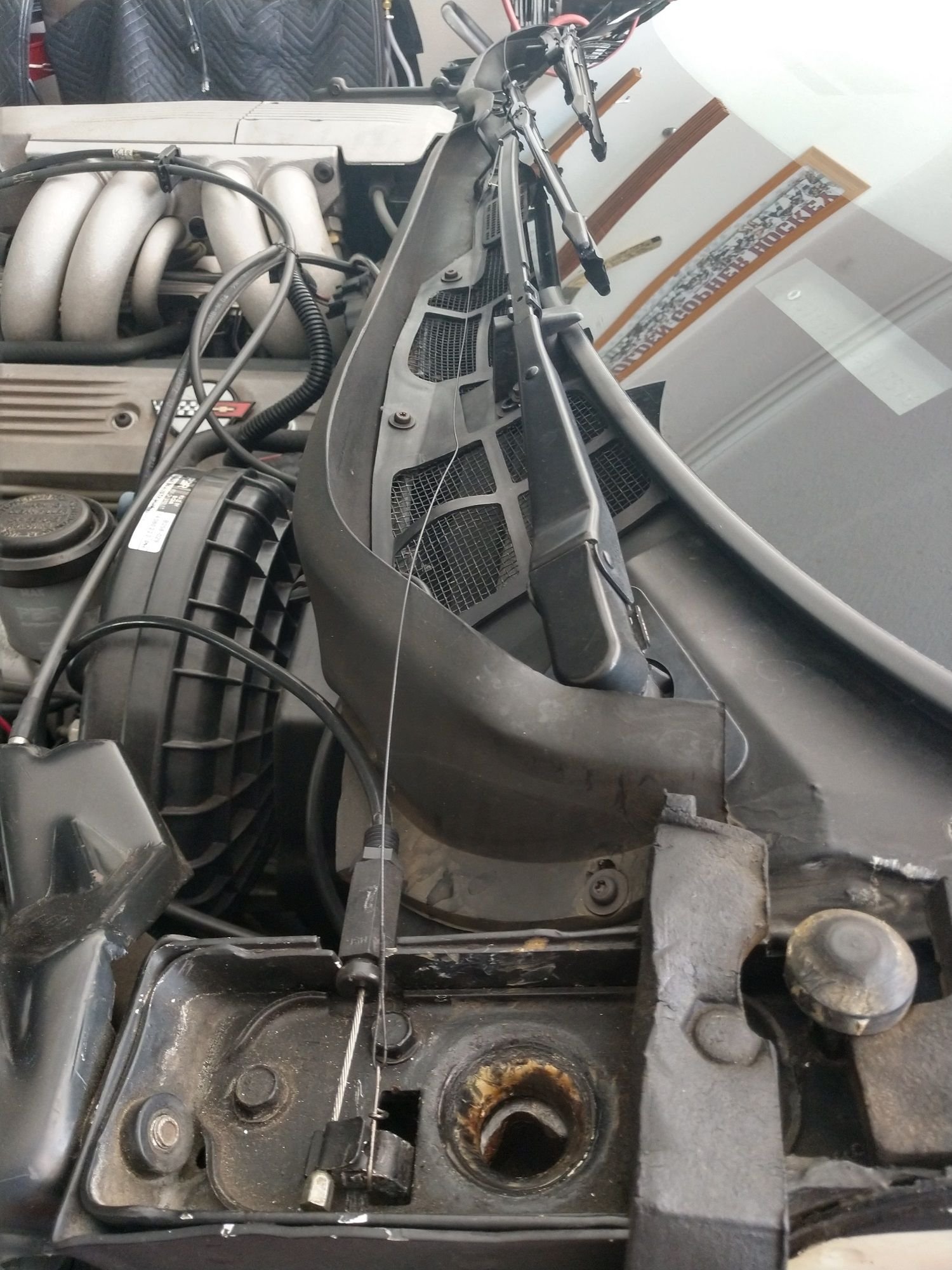

once you have got it open do this in pictures attached

Funny - at the St. Pete Pier show yesterday we were discussing this very issue. On one of the C4s the stripping was missing on the drivers side - and I can guess why. Showed my fishing leader fix to people (variant of my C1 fix). Hopefully they will put them in before they need them.

got to go with Ghostrider1 on this, I have the handle, it it near impossible to work....practiced with it for awhile, finally just put a couple of short cables through....doubt the average person would ever know they're there...
