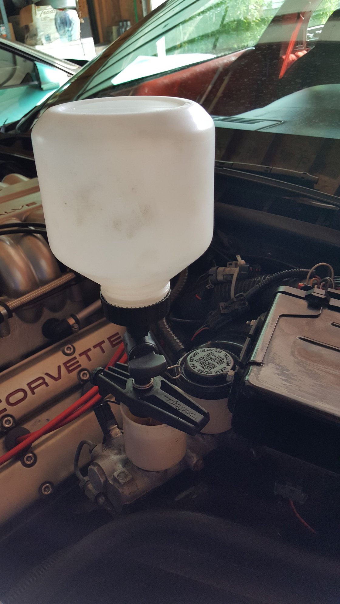

Goto Summit Racing, get a set of 4 of the Russel 639630 Speed Bleeders - and replace the stock bleeders with this "upgrade".
Also, I recommend getting a Mitivac speed bleeder bottle kit.
The bottle can be filled with brake fluid and mounted on the appropriate brake reservoir. So, when you bleed the brake lines and calipers, the bottle keeps the reservoir filled so you don't have to keep running back and forth to fill it (or worse...end up sucking AIR into the brake lines...adding to your task at hand.
With the combo of the bleeders and the Mitivac, the time I used to spend bleeding brakes was cut to maybe 10 minutes(?) except for pulling and remounting the wheels.
