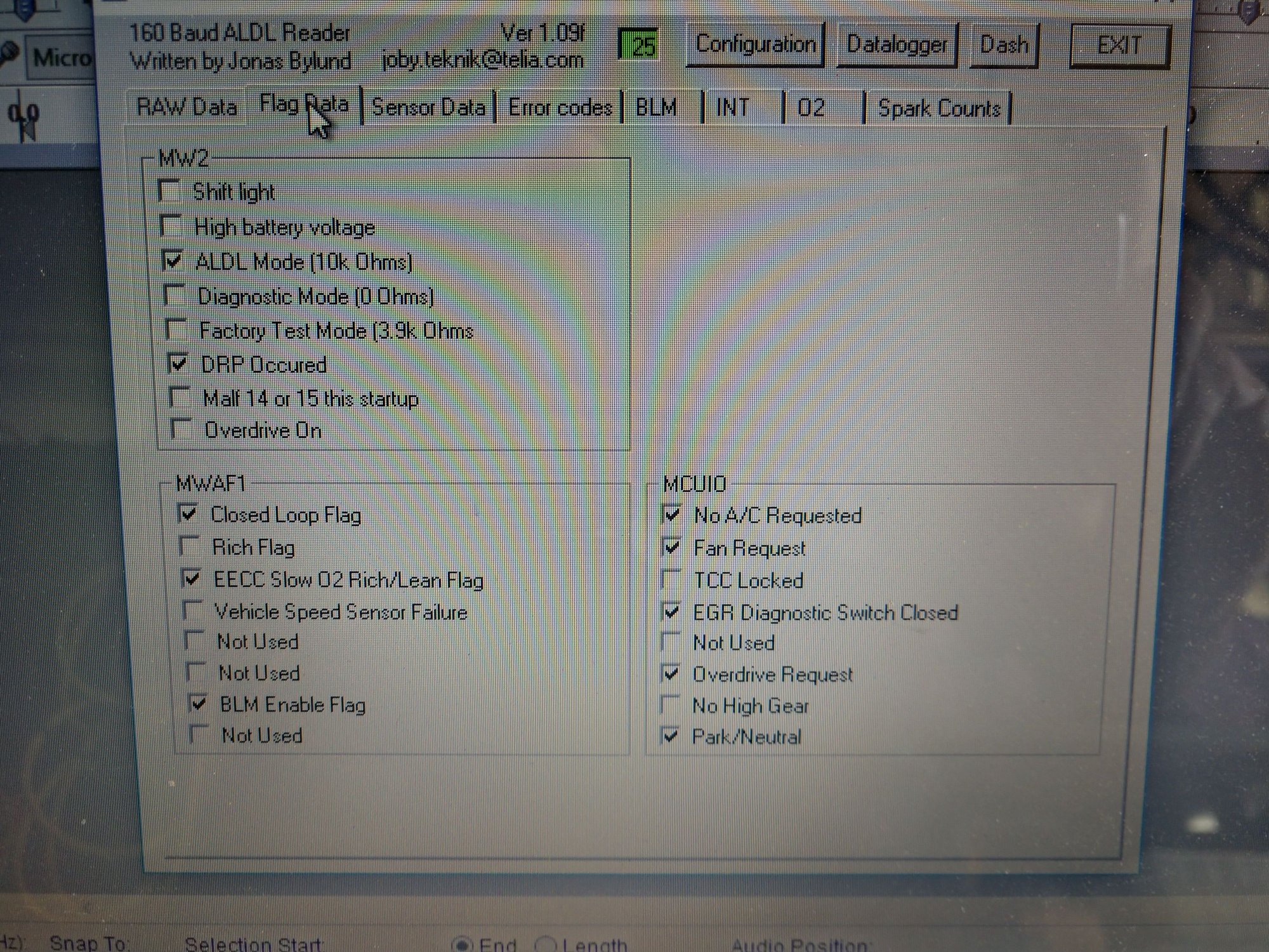

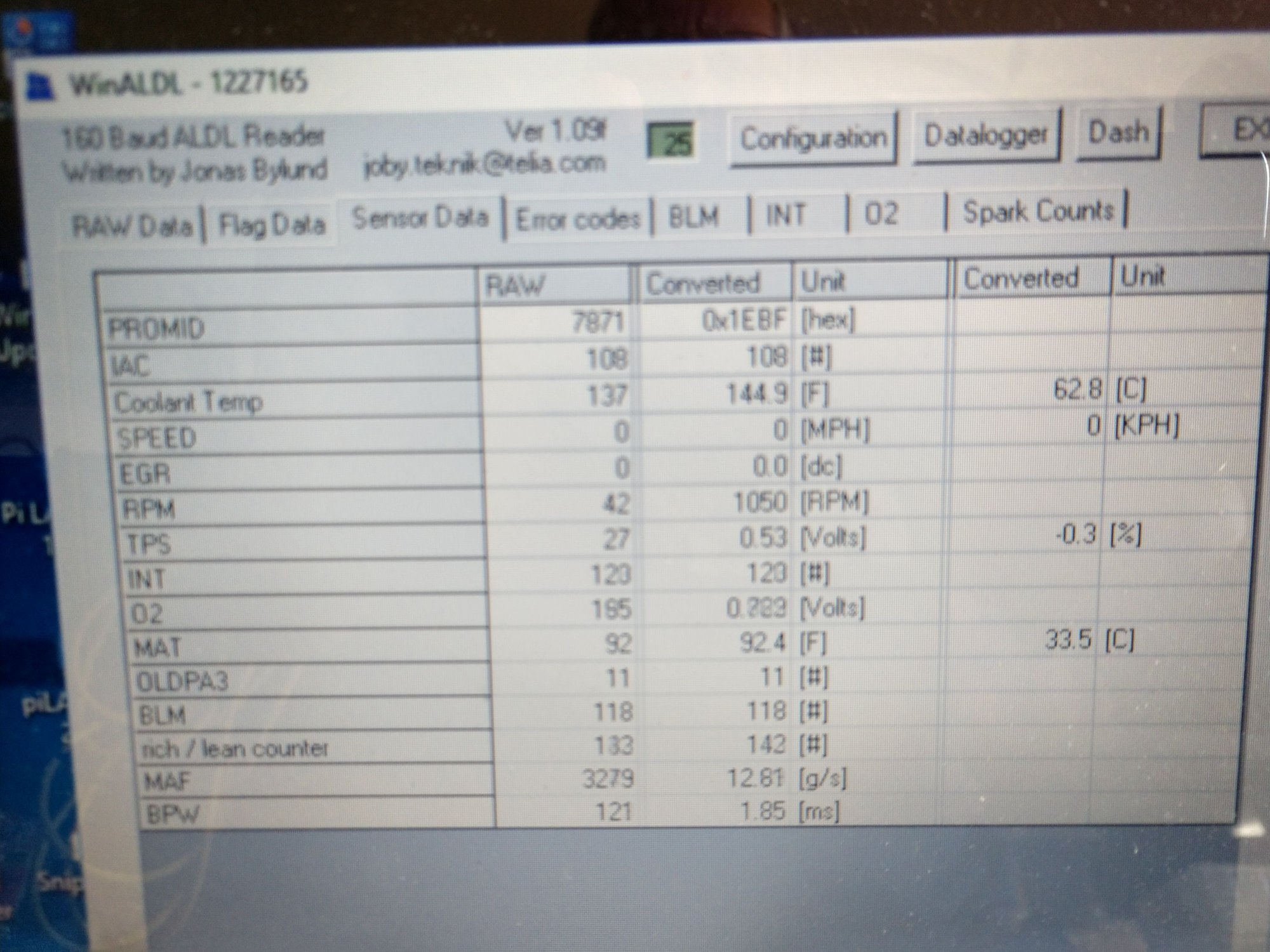

Attached are the readings from my 1988 all stock Anniversary. After not driving it very much since earlier in the year I've started driving it again and have put several partial tanks of fresh gas in it. Several weeks ago I had this similar situation with a 33 MAF High. After research I disconnected. reviewed and reattached the MAF sensor connector. All was good. Went to fill it up with premium yesterday late since I'm driving to the Pier Show tomorrow and the Service Engine Soon indicator came on. The other "funny" thing is that the engine will be idling at 6-7K, and then once in awhile drop to 4K and then just quit. This is a new situation that I've never had either. Seems like they are connected.
Thoughts on fixing? OK to drive it as is at 70 MPH for 75 miles each way?
Hopefully the attachments aren't doubled up since we're having ISP speed issues.
