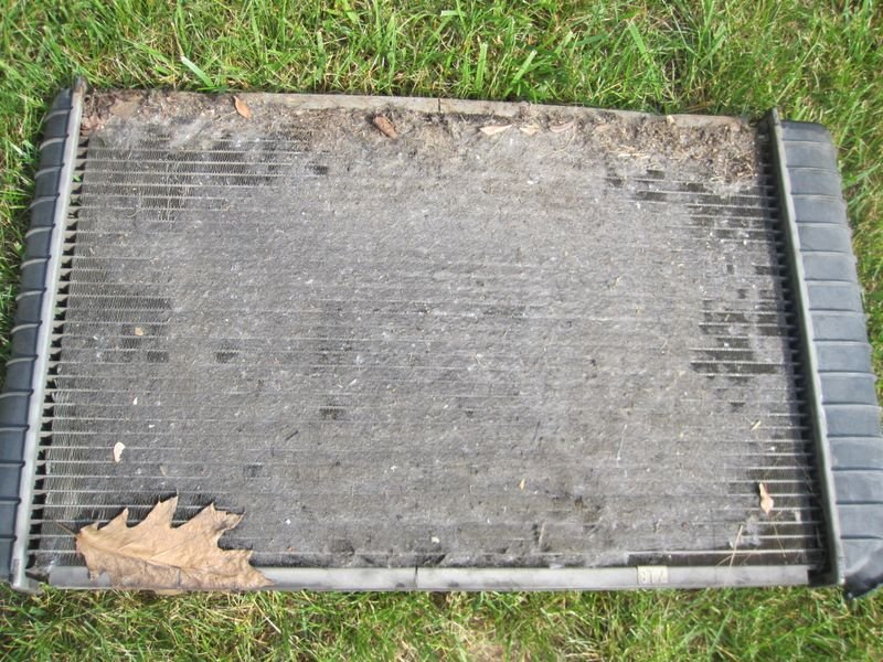

You need to get that radiator out for good cleaning . The fins get clogged up over so may years. A new thermostat for sure too.

If I'm going through the trouble of pulling the radiator out, would a new Dewill Aluminum Direct Fit replacement be worth it instead of keeping the old one?

Condenser and radiator should be checked for restriction. Are cooling fans coming on? What does digital temp display reading? Any previous repairs? Radiator change is if you want to spend the money, depending on condition of radiator. If the tank ribs are cracked, there obvious damage, or crud in it. Replacement would be worthwhile. You don't want to overlook condenser since it mounts in front of radiator.

some would swear by it, but I wouldn't. As long as your radiator is clean, it will cool as intended
